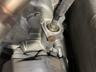

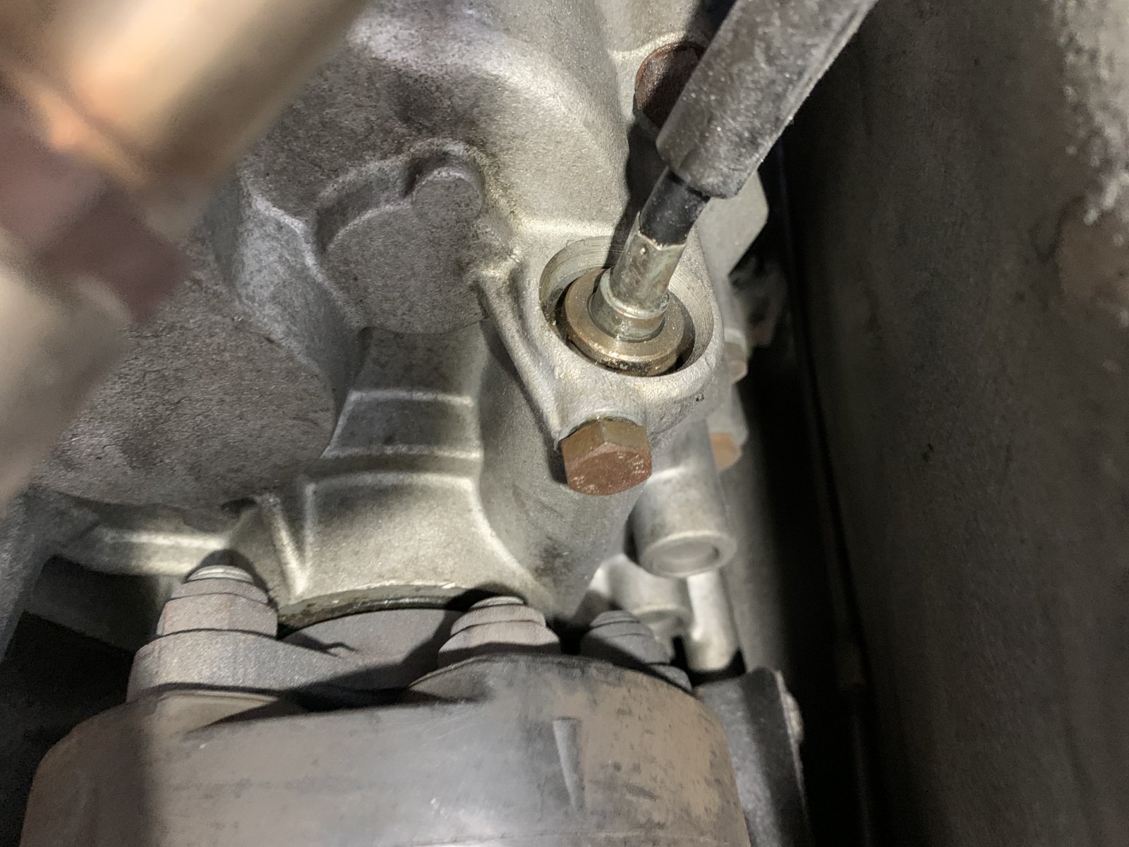

While doing an oil change yesterday, I noticed some oil drips at the back of the transmission. Upon further inspection, it looked like it was coming from the speedo cable entry point. I checked the 13mm bolt there and it was very loose. I started tightening it up, and it felt strangely soft as I did it. Not stripped, mind you but it felt like it was going into some thing soft. How tight is that bolt supposed to be?
My recollection is that the bolt fits into a groove and only needs to be tight enough to keep the cable from coming out.

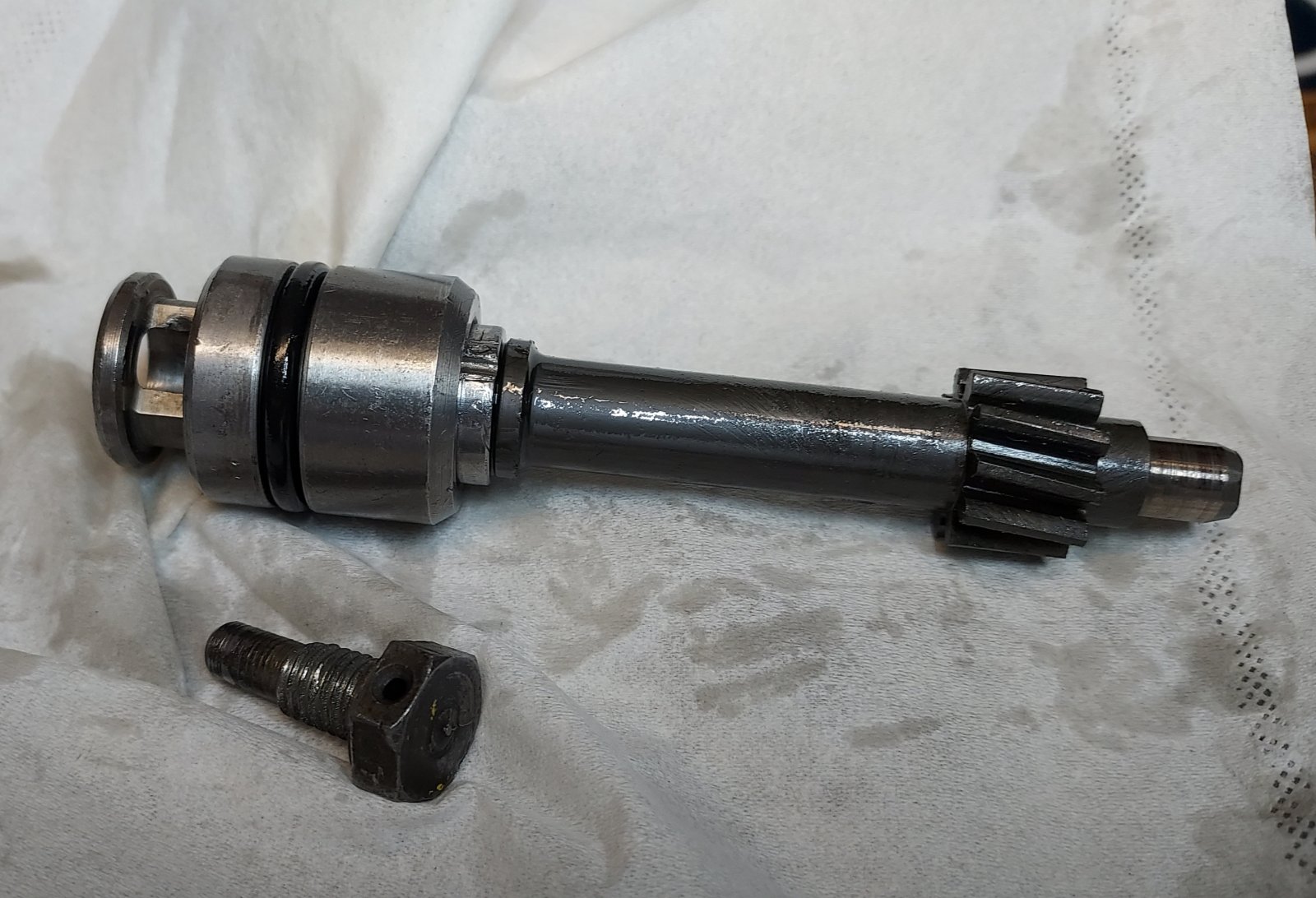

I just looked at this on my 635csi barn find. Your leak is coming either from the o ring for the speedo drive, or the shaft seal inside the speedo drive unit. Replace the o-ring first. The shaft seal is small and difficult to replace.

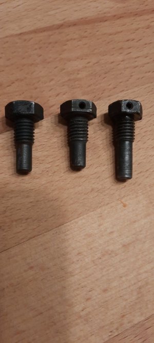

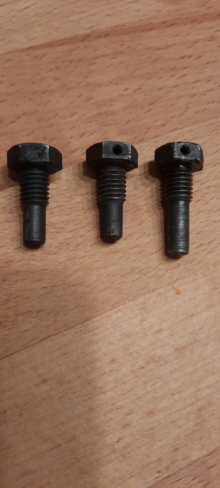

For what reason ever the left screw did mot come with a hole
The one on my 635csi does not have a hole. Haven't climbed under my coupe to see if that one has a hole, but I know I did not put safety wire on it when I installed it.

I have three transmissions, one has a hole, two don’t. If yours does not I suggest that you drill it and wire it.
The seals, O ring is thicker than normal, but easy to change, the shaft seal is a PITA, suggest that you buy two or three seals, they are easy to damage. Or, pay someone who knows what they are doing with these, it might be cheaper.
