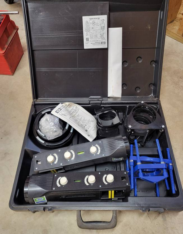

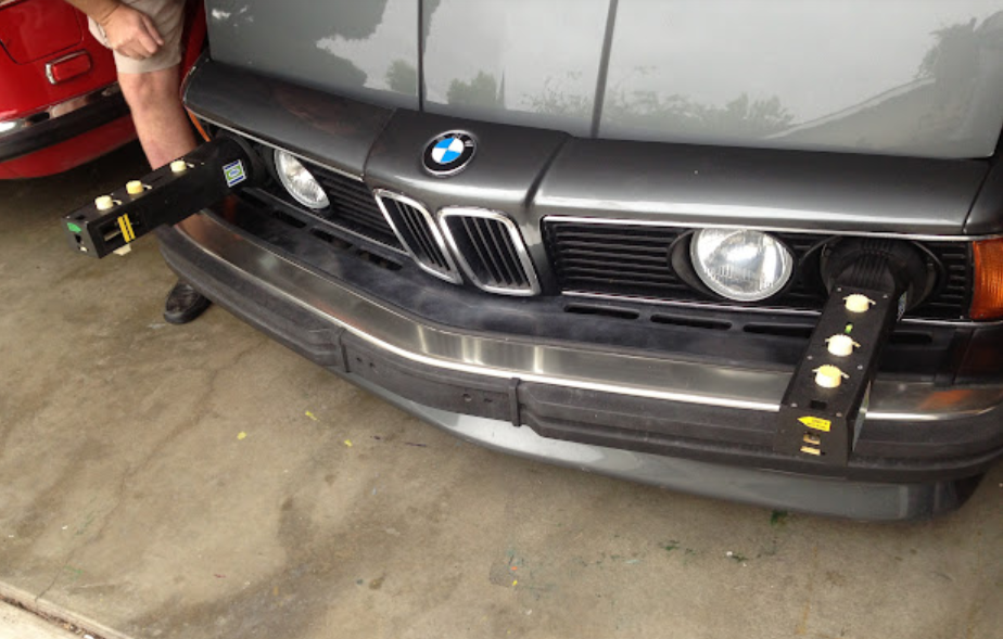

DQ you need this gadget. All efforts were in vain until I used it:
New item by Ariel
photos.app.goo.gl
New item by Ariel
photos.app.goo.gl
And now I'm holding it for ransom...Went on Craigslist this morning and Mr. Goble is on his way to pick up.
99.00!
Well done. The question is how do you get it to DQ?And now I'm holding it for ransom...
It is great! Somebody wise showed me that gear and I am just the messenger. Used on my E9 and E24 that were hopelessly unaligned.that's a good question Don ... @Arde, inquiring minds are curious. looks like a nice piece of kit.

Here's a how-to use the Hoppy video.Went on Craigslist this morning and Mr. Goble is on his way to pick up.

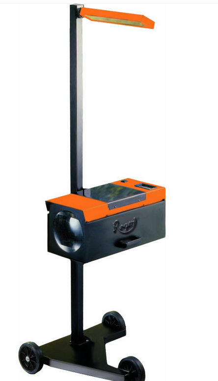

Here is another great deal:
HOPPY HEADLAMP AIMING SERVICE CENTER - tools - by owner - sale - craigslist
Never used hoppy headlamp aiming service center $125.syracuse.craigslist.org
