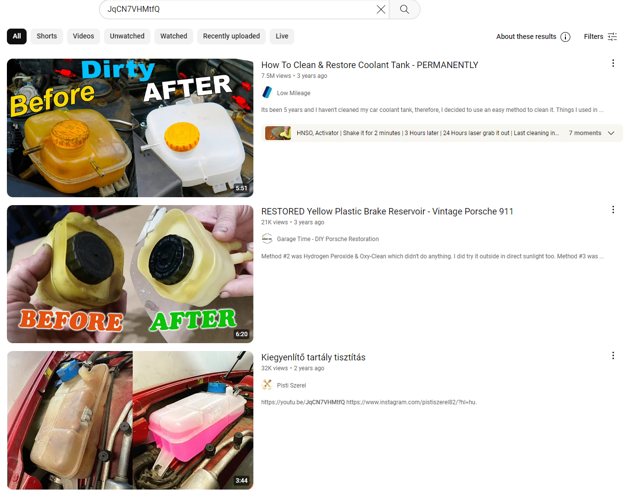

how to clean plastic reservoirs ?
deQuincey
Quousque tandem...?
8,420
2,432
i have tried to find it , but i cant
i recall this was discussed long time ago
and it was kind of a conclusion about how to clean the old white plastic reservoirs
any final idea ?
thanks
p.s. interested in the brake fluid one;

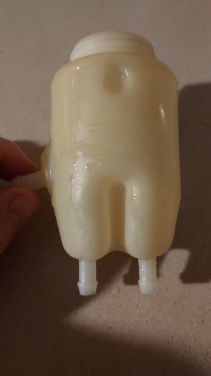

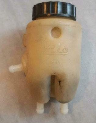

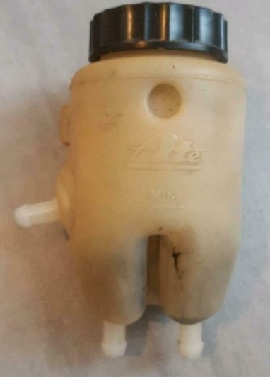

Two possibilities, or both, for that inverted feature. Looking at one on hand, the flashing from the molding process in perpendicular to that “hole”. Possible that this feature was designed into the vessel to be where it was pushed out from the mold in production.
Other possibility is that these Ate bottles are hardly unique to the E9–some version was used in essentially every European car produced for 40-50 years. Ate would have specifically configured fluid vessels for each contracted application, but would be drawing off a basic catalog of bottles, then reconfigure somewhat for each application. Many applications (eg Porsche),
use a very similar bottle, but instead of the plastic “bracket” piece plastic riveted to the bottle like in this E9 bottle, used a metal bracket to fasten to desired location. That “divot” served as a locating element (bracket would have a boss feature to fit inside) to keep the bottle stationary/prevent rotation.

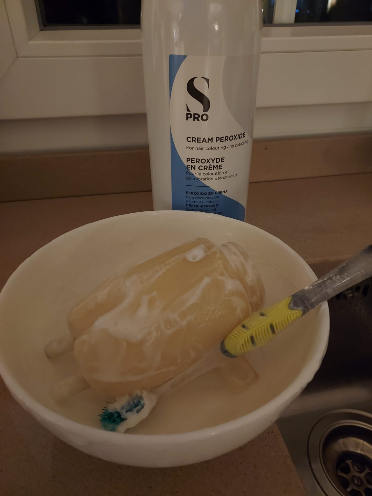

You might try vapor-honing to restore plastic like that, looks like there was some improvement made with the Hydrogen Peroxide, probably good enough once you fill with brake fluid.
it is interesting, but I see no way how the Bottle would rotate as there are two hoses plus a third one connected
Dowst
102
35
The idea is that the hoses aren’t desirable as a safe means to prevent the bottle from rotating/moving. You’ll notice a “ridge” also that anchors the bottle from vertical movement.

I have some over spray on the horns from paint work that was done in the 90's. The black ABS was dulled by low pressure vapor honing in my test, so I would be concerned about trying it on the white brake fluid or washer fluid bottles which are much more visible.

Are these bottles not available new? Are the new ones “different”? In my experience, I have yet to find a process that will make an old, translucent plastic bottle that has yellowed, look like a new one. Sad but true. I will for sure try this Peroxide treatment.
If it can’t be bleached, the only real option is to remove the yellowed material, assuming it is just in the surface and not all the way through, was thinking VH could be a decent solution since it will likely “dull” the material, but this also lightens it at the same time, maybe not bad for a white/clear matte vessel.
Only one way to find out! I would probably go to town with various solvents.

Brake fluid bottles are available, but only with new style clear/white plastic lids (rather than the original black lids). Use solvent with care as some will start to soften and dissolve plastic leaving an unsuitable finish.
