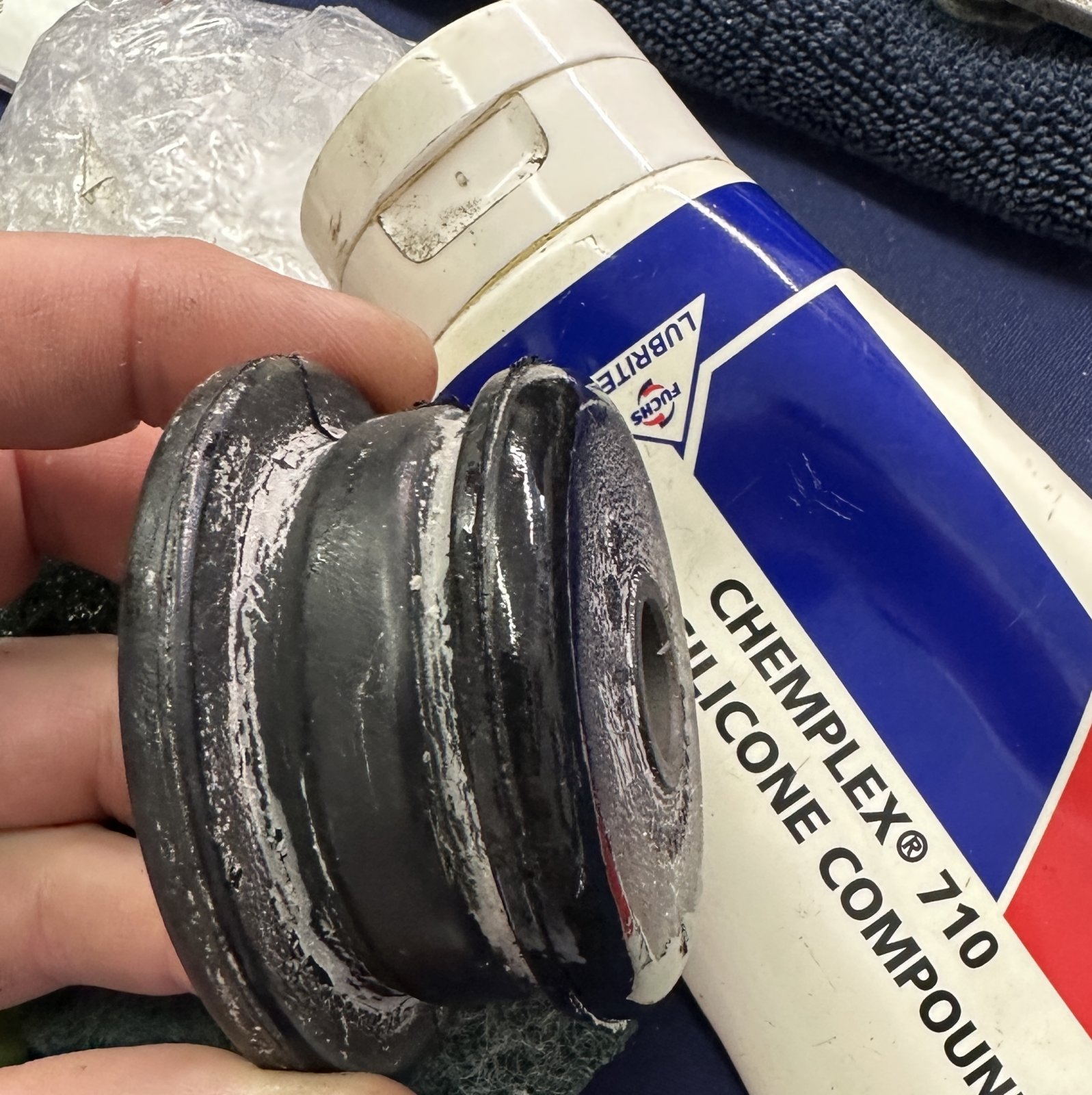

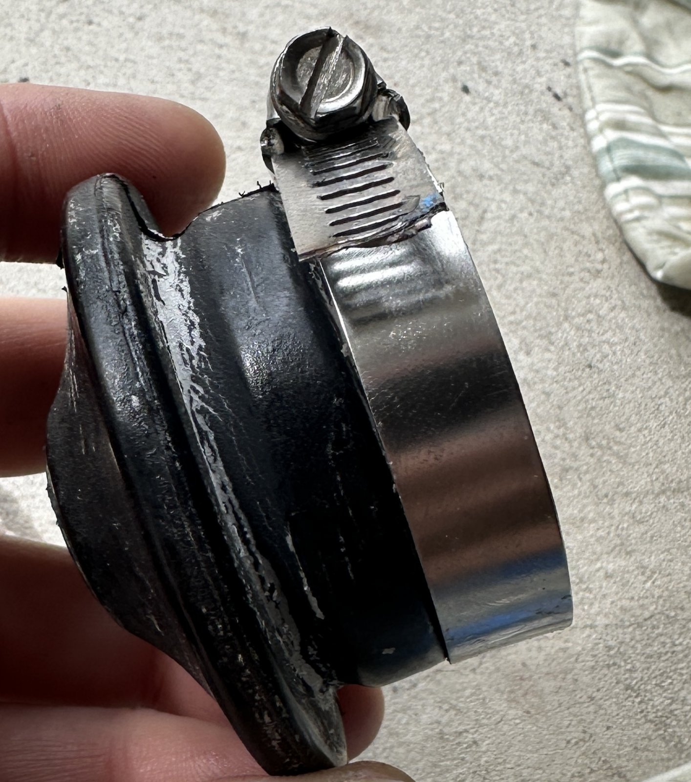

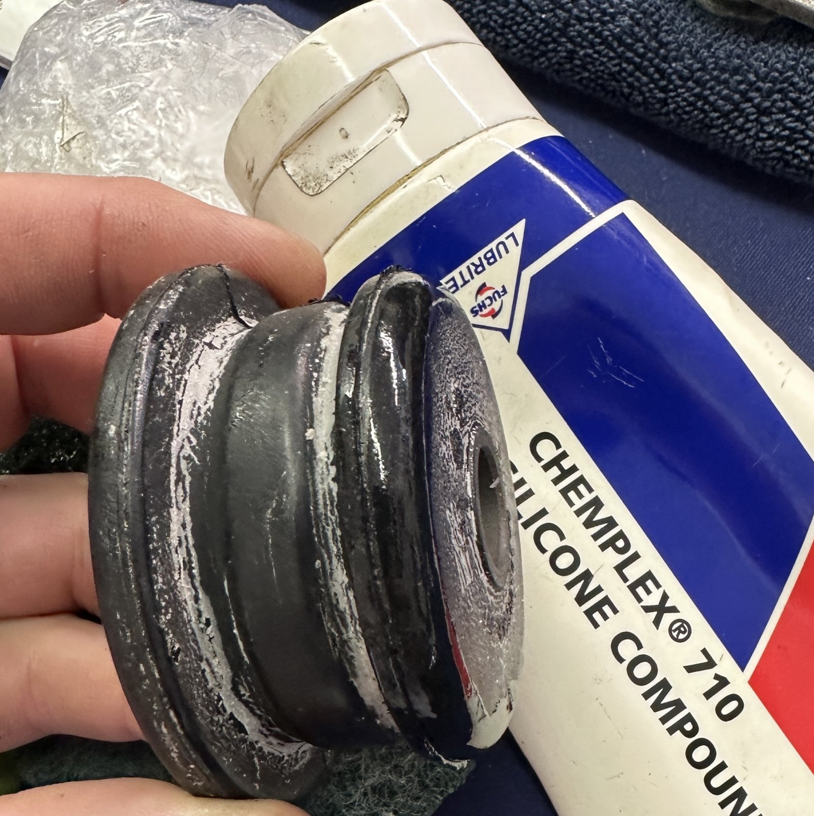

Yes, I used a wide hose clamp for this. I have the MTC bushings and they worked once I got everything together. I had to do this in two stages: first, get the bushing started in the hole. My subframe is powder coated and has added quite a bit to the difficulty of starting the bushing, no amount of force could get the lip started evenly. So I put some silicone rubber stuff on the lip of the bushing and tightened it up like a piston ring compressor:

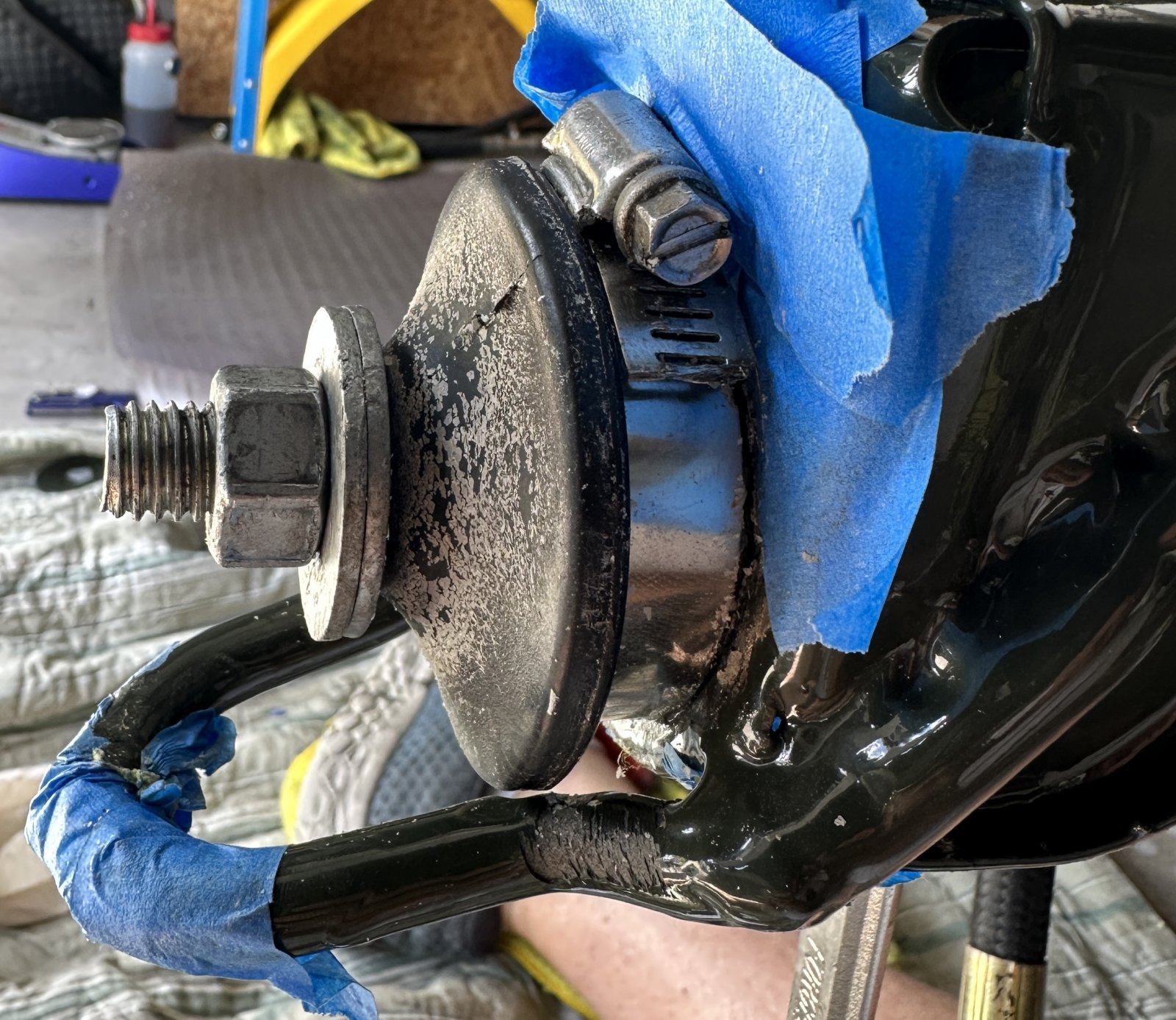

Then aligned and tightened it until it went is as far as possible (I sprayed it with Iso alcohol as well as in the back side of the tube), it worked:

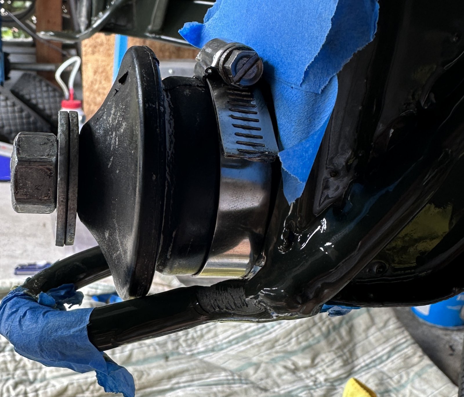

Maybe this clamp technique would work on the other stubborn brands like the W&N ones. Then I removed the clamp and put a cut up pipe on the other side to pull it through like the manual shows:
This piece was difficult to find because of very little room to work with, the only thing I could find strong enough after several attempts at inferior materials was a piece of 2 1/4" ID stainless exhaust pipe about 1.5mm wall thickness which I cut to fit and worked great:

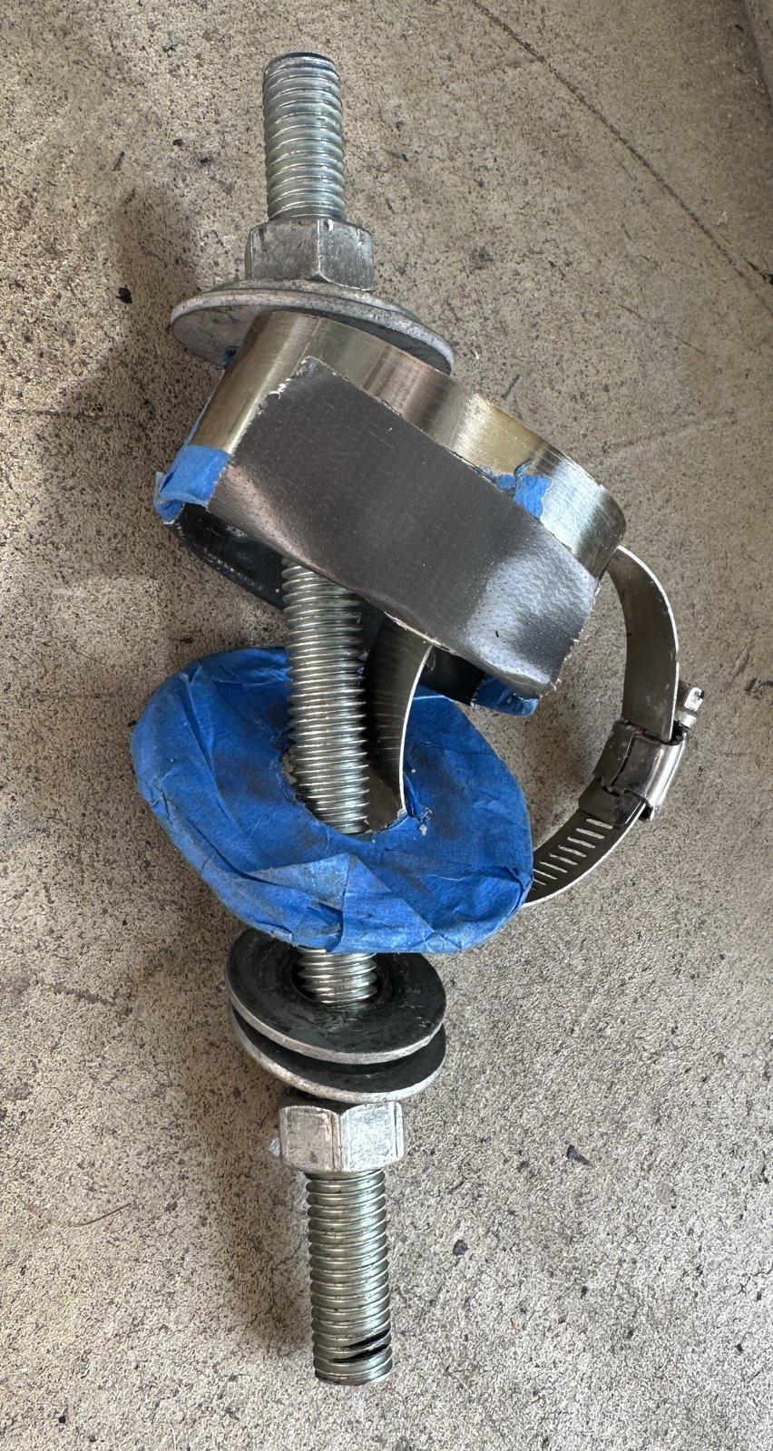

This allowed me to pull it the rest of the way in and voila. Here's the tool parts - 1/2" threaded rod, a large-assed washer trimmed on the sides to fit on the back side for pulling, washers for the front, the cut pipe and clamp (taped to protect the paint).
