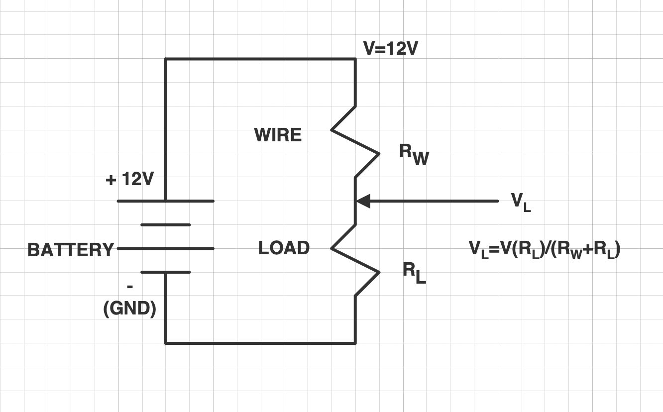

* For those not familiar with basic electricity, the voltage, current and resistance in a circuit have a very well-defined relationship, which is described by a relations known as Ohm's Law. This states V=IR, where V is the voltage (Volts), I is the current (Amperes, or usually just called Amps) and R is the resistance in Ohms. You can see the effects we often observe by looking at a simple circuit using Ohm's Law. Below is a pair of resistors. One (Rl) is the "load", which is the thing that we are trying to power (lamp, starter motor, wiper motor, etc). Rw is the resistance of the wire feeding that load. The resistance might be distributed along the entire wire (true for a small wire), or more likely, it is found at certain points, such as a splice, a near-brake, or a frayed crimp connection. The location of the resistance is not super critical.
In the figure below we can see tat we have a 12 Volt battery feeding current to the load, but the load is connected via a wire with resistance R(wire). What this means is that with fixed voltage (12 Volts in a car) the current through the load will be I=V/(R(lamp)+R(wire). This is Ohms law re-arranged to give current as a function of voltage and (total) resistance. Since we also know, from Ohm's Law that the voltage drop across any given resistance is Vd=IR, we can determine the voltage at the load by simply multiplying the current I=V/(R(lamp)+R(wire)) times the load resistance R(lamp).
Here we get V(lamp)=V(R(lamp))/(R(wire)+R(lamp)).
So, if the load is, a 12 Watt lamp, the resistance of the lamp, with a perfect zero resistance wire and a 12 Volt battery would be 12=I^R=(V/R)^2R=V^2/R=144/R.
Or, R=12 Ohms.
Now put that same lamp in a circuit fed by a wire with 2 Ohms of resistance. Using the relation above (in the diagram) the voltage on the lamp is now
V(lamp)=12(12)/(2+12)=144/14=10.29 Volts, and the power output of the lamp will go down from 12 watts to V^2/R=(10.29)^2/12=8.824 Watts... So the lamp will dim.

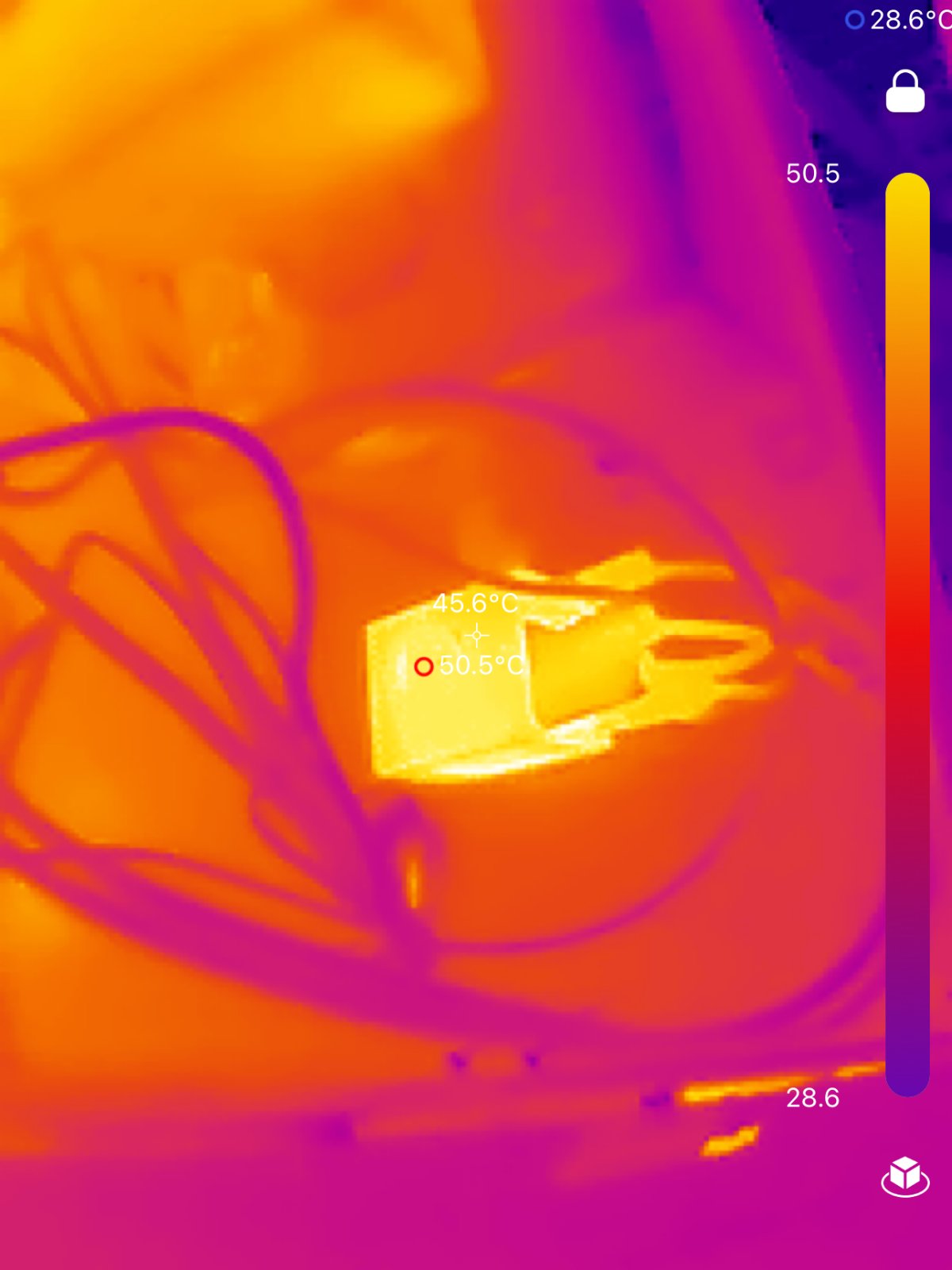

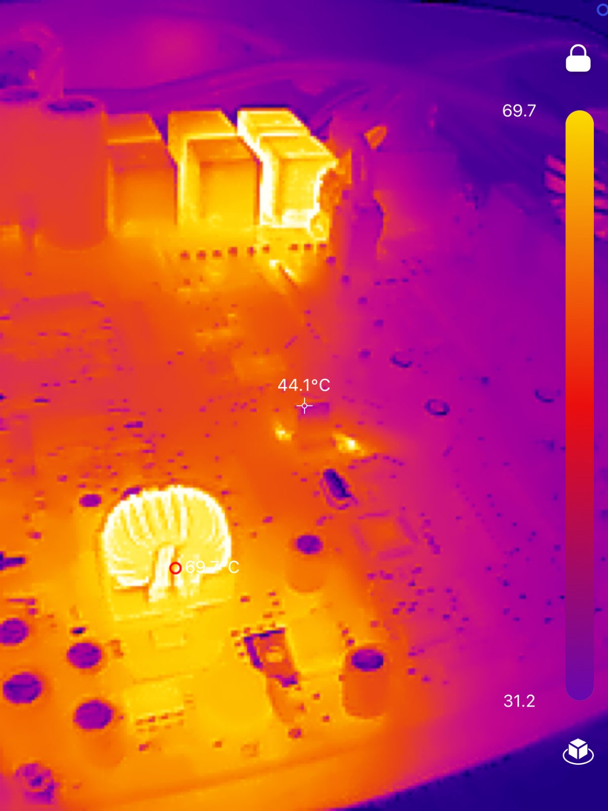

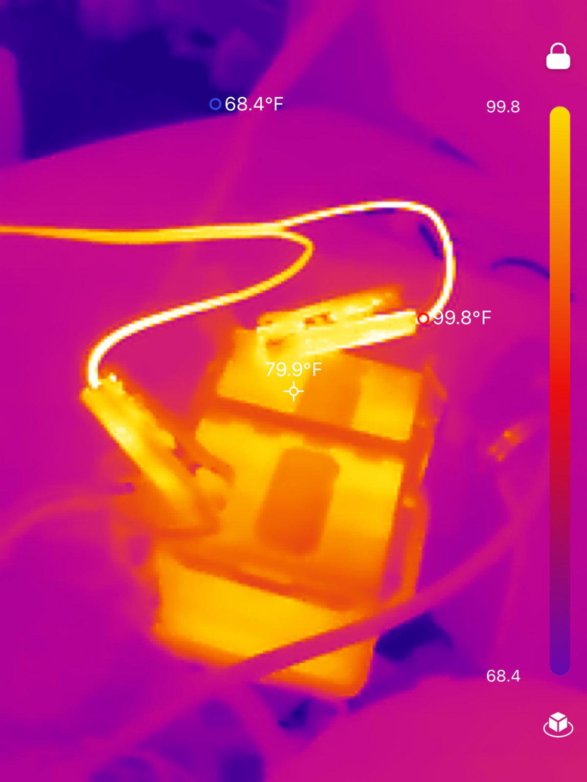

I think testing with a headlight load is an excellent idea, but Iʻd use my accessory thermal camera on my phone to look for warm spots in the length and at the connectors of the harness. It takes longer to see the results than Donʻs 120v example but has the advantage of being nondestructive. Not cheap, but useful for many things such as finding a water leak in your house or car or spots of missing insulation in your walls or attic. I think itʻs a tool well worth the money. Notice the far terminal clamp charging the battery looks hotter than the near one. I should look at that one to make sure the wire is firmly contacting the clamp. Battery charging uses a lot of current, so itʻs normal for the wires and battery to warm up during charging. In this exercise we are looking for abnormally hot spots.
TOPDON TC002C Thermal Camera, 256 x 192 IR Resolution
Amazon 249.00
