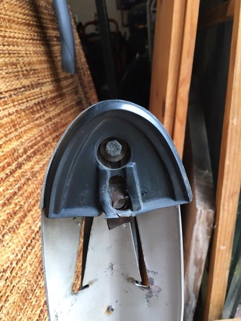

Taking a rear bumper apart to be able to sell and ship, and don't know the best way to...
(1) get the pointed ends of the rubber out of their slot..assume hot water is involved?
(2) how to remove the attachment "pins"...so small that at first I thought they were nuts, but cant really tell..assume they were factory..? or are they just a press fit? Pictured below at bottom of photo...
Yes I have already removed the black terminator piece (but still shown below)
Thanks for any wisdom...

2) In general these are rivets, so if they have already cutted head from one side - you can just knock them out with nail & hammer. If they are smashed from both sides - then treat them with drill.

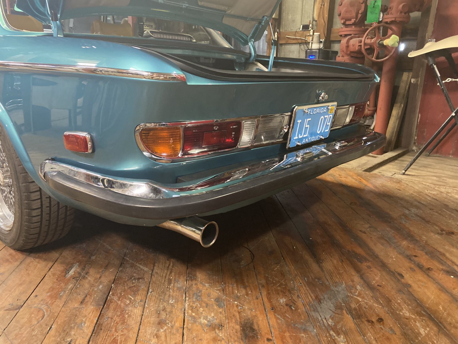

Mal--The restoration shop was able to clip the rubber on the riveted metal strip after the re-chromed bumper was on the car. I have a '73 with the oval bumper supports that stand the bumper off the car's body. (first pic) Here's a pic before the under rider horns are mounted.
