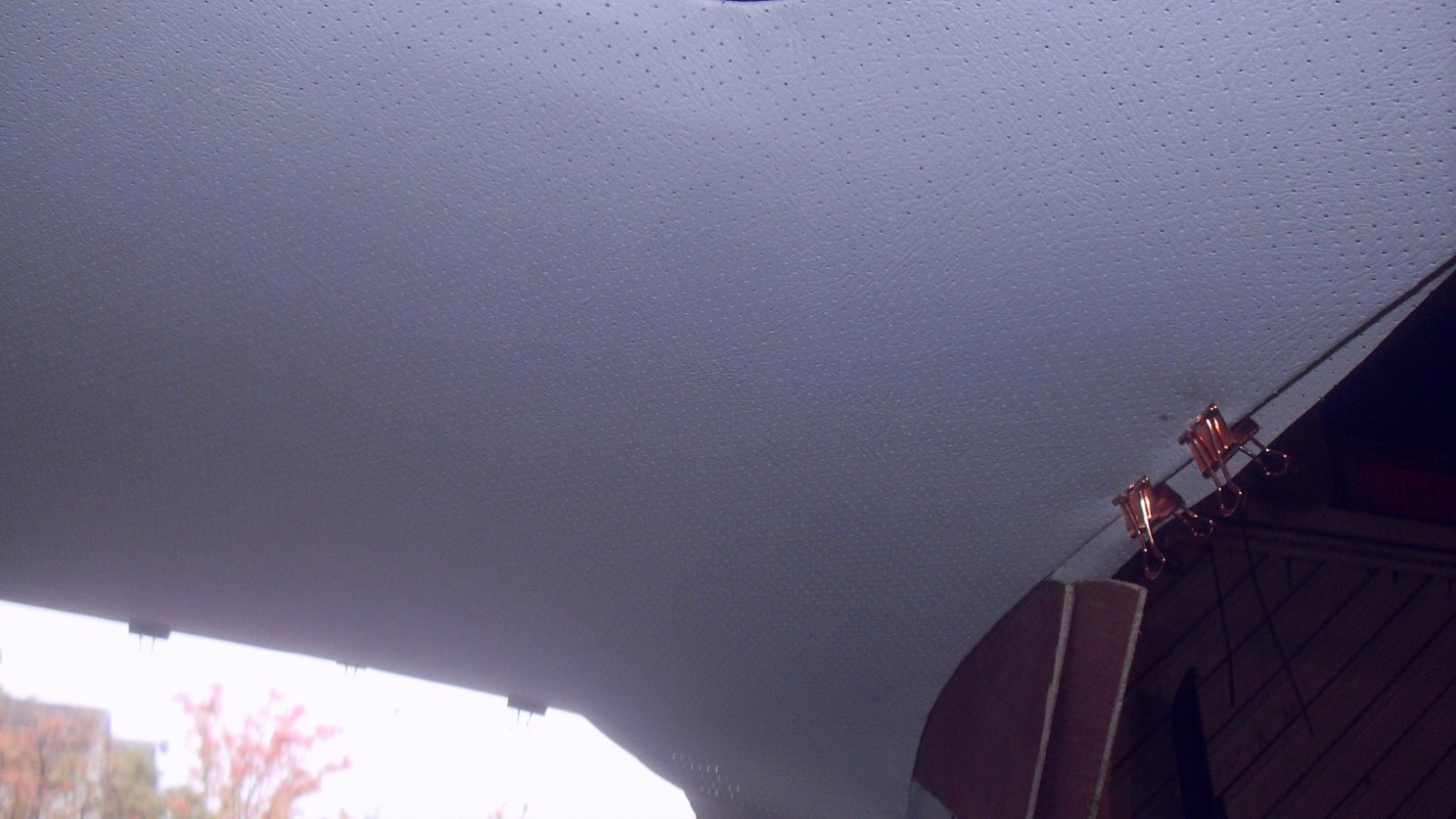

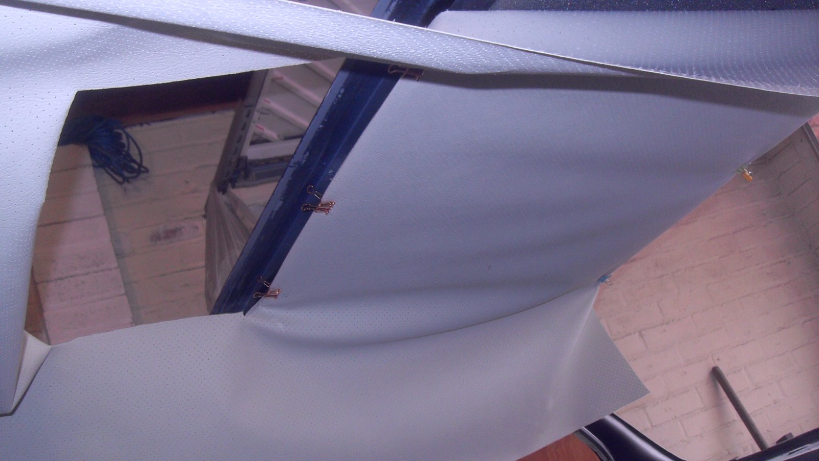

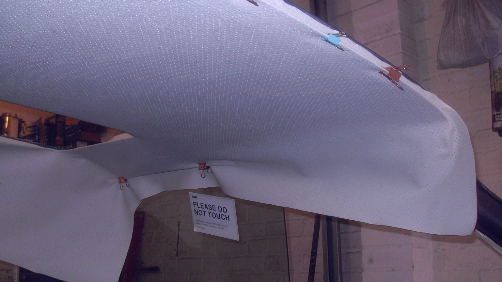

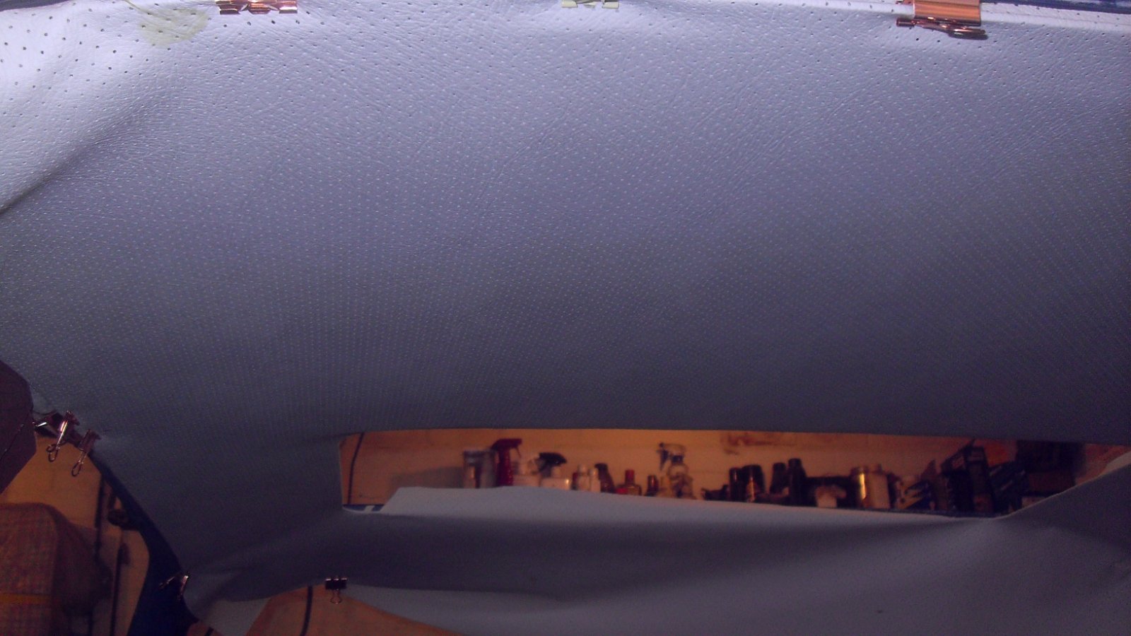

I did my own headlining in my manual sunroof coupe.
No, you do not glue the headlining to the board that's in the back half of the roof. Basically when the headlining is in place it naturally takes the right shape.
You'll need good glue and a good supply of bulldog (I think that's the term) type clips.
I'd recommend doing the back part first. You'll see from the first photo that when you start there will be creases, so you'll need to apply of tension both backwards and to the sides of the window aperture to pull them out. More than likely you'll need to unstick and restick the edges a few times as you go. The only thing I'd do differently second time around would be to leave out the grab handles.
