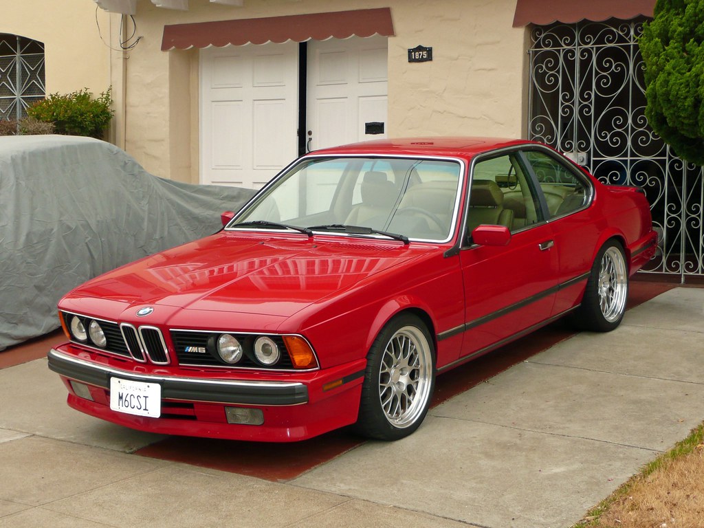

+1. These are the unclear-coated polished rims on my M6. The rear rims are newly polished and the fronts have not been, and have "weathered" a bit. One can clearly see the contrast between them. They are definitely harder to maintain than clear coated rims though.
The original RS finish was not mirror polished, but as you had mentioned, a semi-polished machined cut clear coated finish that was slightly flatter looking.

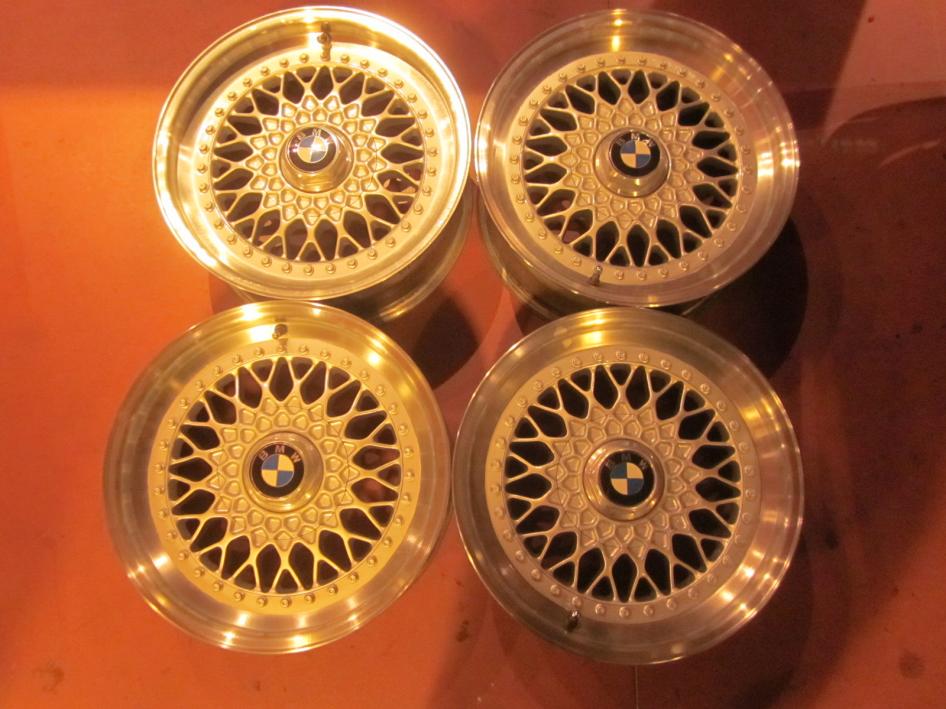

Call these guys, Dave Jenkins did a great job on mine. powder coated BMW OEM silver, 2 coats of clear. Very reasonable price. http://kwicksilverusa.com
Pics are before and after.
