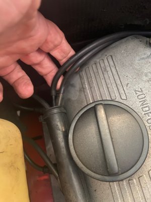

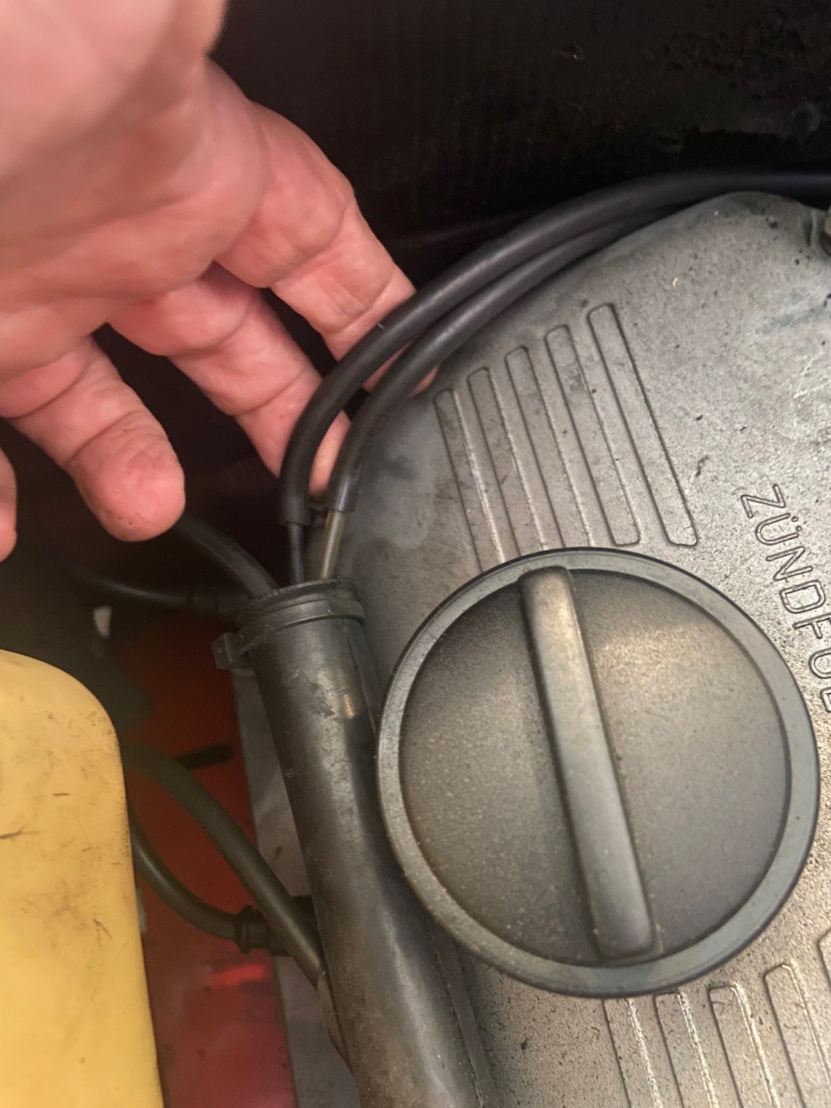

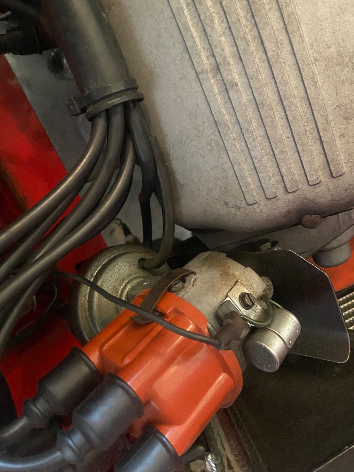

Mine is not a result of my design, hence it can not be attributed to me, this is only how I received my car, and I have seen it routed this way in at least 4 more cars, here pictured the short path
interested to learn more about this

more a matter of pleasing the concours judges
if you indulge me in considering also a matter of maintenance; when you remove the sparkplug cable tube i prefer not to have a vacuum hose laying around

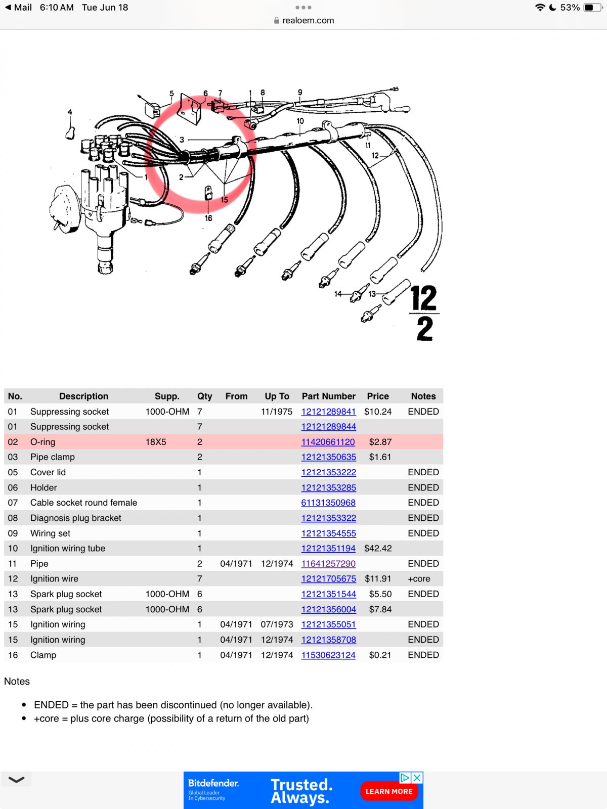

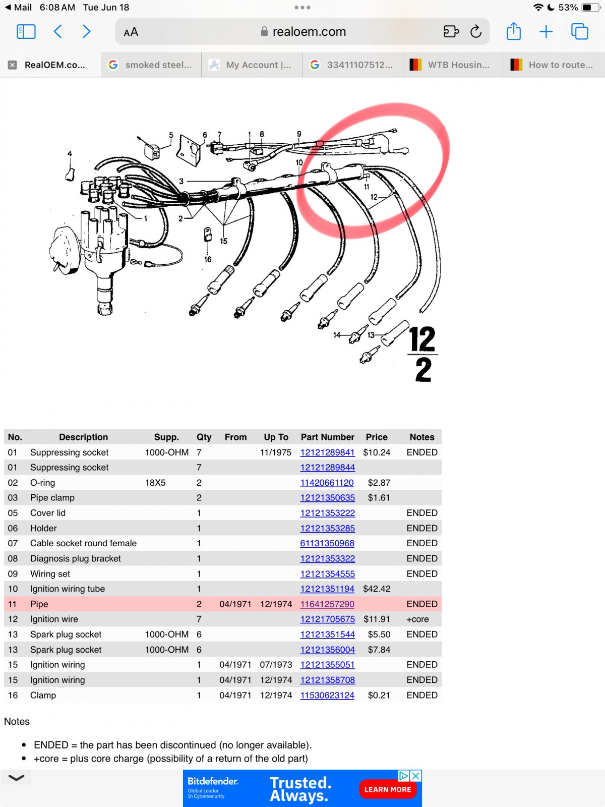

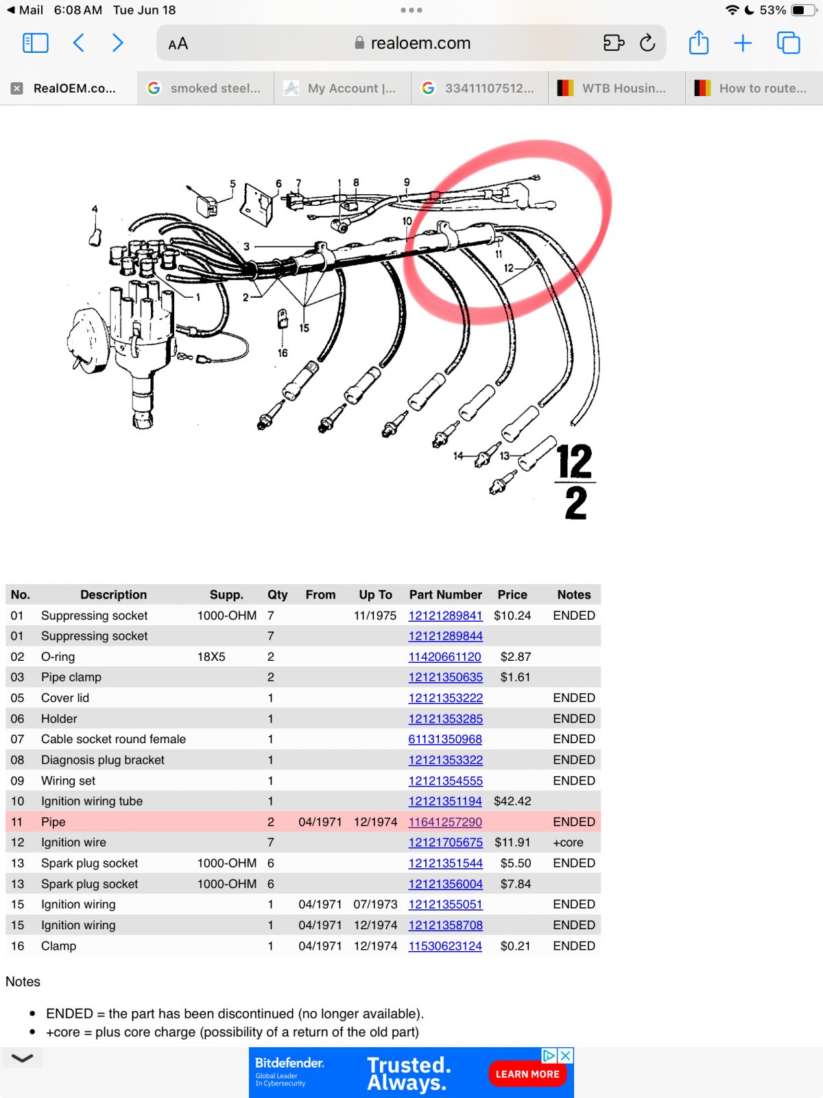

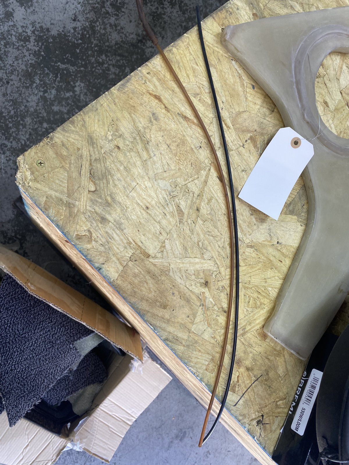

View attachment 184752View attachment 184753
Factory pipes and Ricks factory o-rings

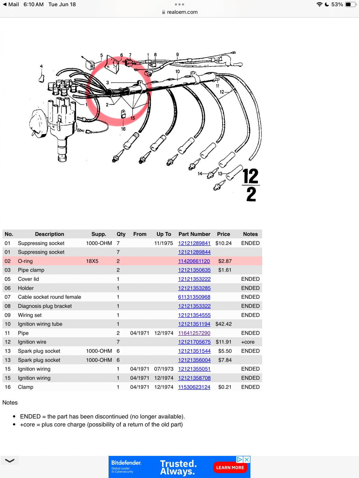

ther is very interesting info here @sfdon
part 11, wow, never saw it, but,
- the description says 2 units, if one is for that vacuum where does the other go ?
- in the drawing there is no seven tubes, pipes or cables, coming out from the black big tube in the other side, ...hummm

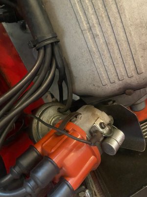

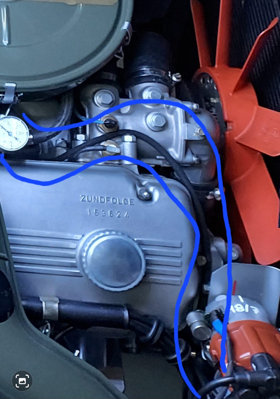

Fascinating! I had to go check what I have.
Yes, there are two! They go to opposite side of opposite carbs. Why?
And what does Don mean by retard? I thought that more vacuum always means more RPMs therefore more advance.
Apologies my engine bay is not as shiny as DQ's.
