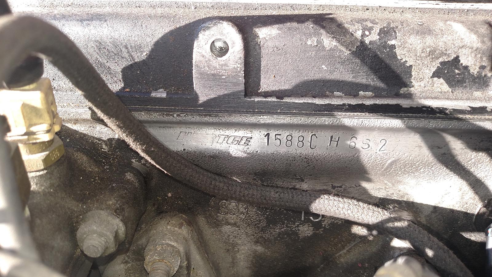

Okay, to my surprise it just arrived this afternoon. Here's some photos. Its definitely a Hartge valuve cover, it has headers that similar to Hartge but I didn't look for a tag. I took a photo of the oil pan but I don't know if its anything special. Number on the head seems stock. The steering wheel is a MOMO and the transmission shifts like a standard 5-spd. I'll get it up on a lift at some point and see if there's anything underneath. I had slated this car for parts but its actually in really good shape so I have them mark it as a "Builder" for now until I find out more. Its also a clear title car.
My gut feel with this car is that its a stock 533i/is with a valve cover and some bolt-on cosmetics.

If I'm not wrong, Hartge used a stock euro B34 10:1 bottom end, Hartge head (ported, cam + bigger valves?), and Hartge headers, which resulted in 240hp in the 635 Hartge H6S (and/or SP)
Maybe it's a complete H6 S engine?

Is there a fairly easy way to check? I looks like it has a stock oil pan if that makes a difference.
I dont know if Hartge marked their blocks in any way, and I’m not sure which way to easiest identify an euro B34 block but maybe @sfdon can point you in the right direction?
A compression test.....
This is obviously the way to go. If you are like me and more technically adept than mechanically you can stick an inspection camera down the spark plug hole and look for these. That will at least tell you if you are dealing with a higher compression motor, but you’ll need to inspect the markings on the block to determine the bore. I would be screwing around with a compression test for an hour but the camera would take me 10 minutes.
