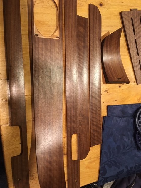

Apologize with limited photos, I did not image as I went. I have re-finished furniture for years but never re-laminated a thing, Common sense was applied.
1) Removed all the old laminate, get level surface to place laminate on.
2) Have long 22G needles and syringes. Wood glue flows ok thru this size needle. Needle size allows you to get between all the different layers of the original wood. Re-glue all the layers that make up the wood backing.
3) Boiled linseed on the back of each piece/template since the wood was so dry. It did not undo the wood glue. If added first, the glue wouldn't work well....daaaa
4) Minwax or Varnathan wood repair to the back. This is like a thin epoxy. It strengthens the wood, especially if any rotted areas. Elmers wood repair stuff is horrible, basically watery Elmers glue.

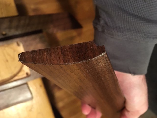

5) Cut laminate, I cut to extend past the borders of each piece being covered. I gently made multiple light passes to cut. If you cut the thickness of the laminate in a single pass, (cut on wood side, not glue side), you can get "crush injury" to the edge of the wood.
6) if you need to make an edge 90 degrees from the surface you are covering (see second image), then make a few passes to score the edge of the piece to partially cut the laminate so you can then fold.

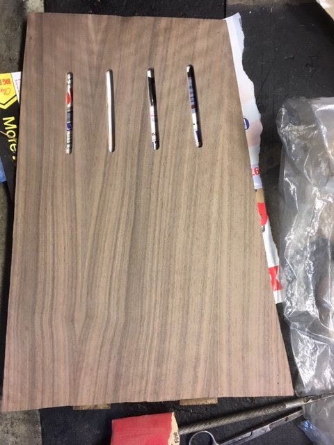

7) Trimming, used rough cuts (leaving lots of room for error (ex for the door lever etc), then 60 sandpaper to finish. It takes the laminate down fairly quickly and makes a nice flush surface.
8) ahhh, as another member did, curves=wet the laminate and jury rig whatever to set up the curve you need. Doesn't have to be exact, the glue backing is pretty strong so will hold the final bend.
8) I did some test stains to see what I liked. I use oil-based stains, takes 24 hours to dry, but gives some protection that water-based does not.
9) OOOO steel wool before top coat and between top coat layers. I used oil-based poly. Can use laquer if you choose. Keep in mind, the harder the final finish you choose , the less tolerate of temp swings before it cracks (last image shows stained only and stained and poly pieces).

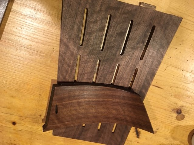

10) PIA's= the speaker grill, the instrument cluster surround, the thing I posted originally. Used either fine round or flat file to get grill ends square, curves for those rubber bits. Tons of patience.
I used no vacuum bag. The cluster surround, well I was able to get around the lower 2/3. Could not get laminate to sit nicely if tried to cover the upper 1/3. Keep in mind, only the lower part shows so not big deal.

For anyone thinking to try their hand(s), the door trim pieces (in hand in the center photo above) make a good starting point. They aren't hard to remove and use as a pattern; not particularly 3-dimensional so their shape is relatively uncomplicated; most of the work is in the direction of grain so they finish nicely, and they are large enough so they aren't finicky little bitty things. Let you mind roam... combining different wood species can offer excellent contrast.
The console tray (with slots at above right, if you have the rubber strips or substitute) are pretty easy if you make a pattern first.
