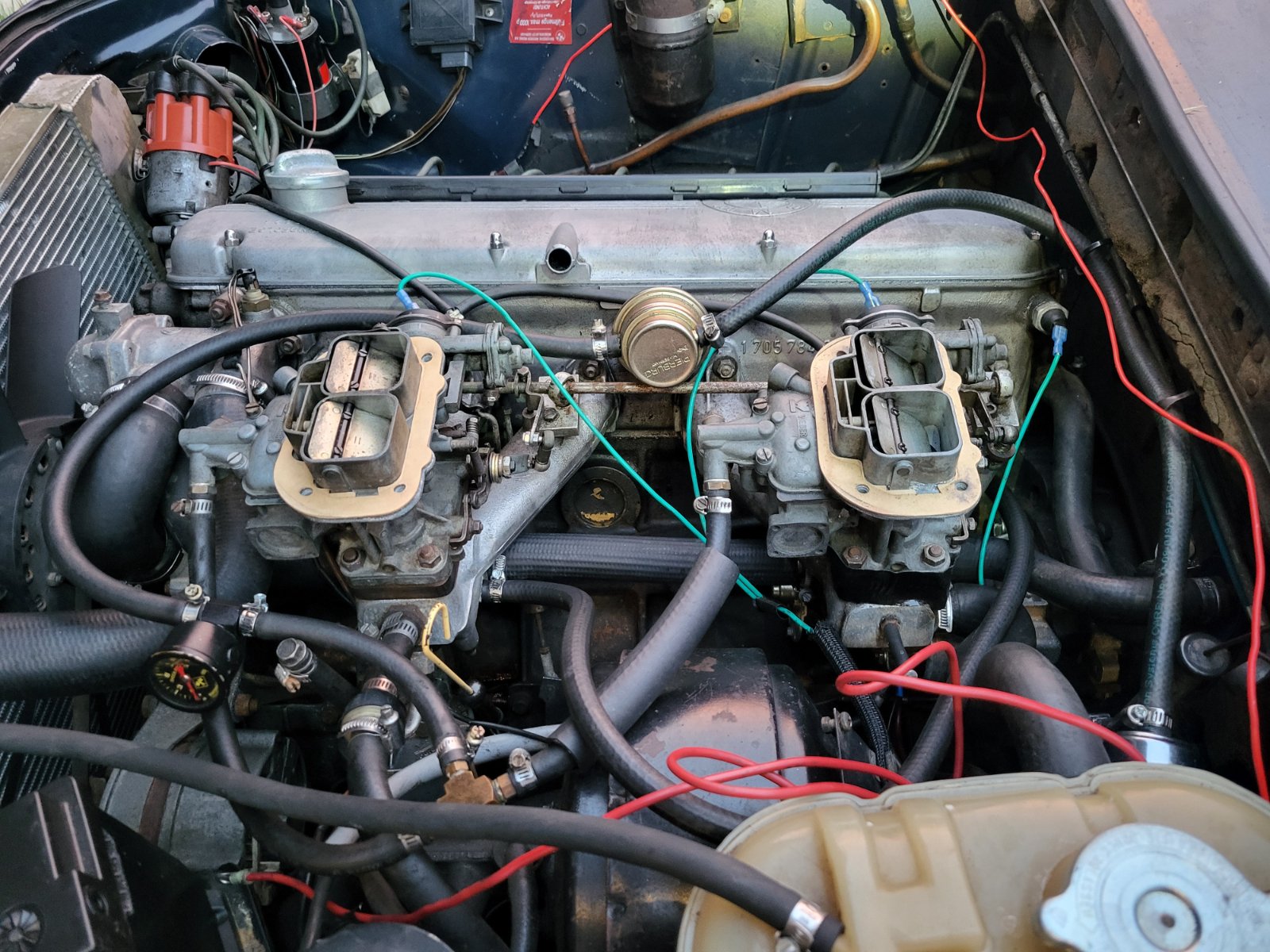

I decided to replace the water based carbs chokes with wire based chokes. I wanted to clean up all the coolant hoses and fuel hoses fighting for the same space. Under the hood looks much better. I also used this time to adjust the choke setting on both carbs. I found that the old water chokes were corroded and non functional. As expected this makes the car easier to start when the engine is cold.
Pics to show how much cleaner it looks!
The minute I spring a leak in that area I’ll be doing the same!
I thought it might also help in keeping the fuel cool.
I remember eliminating it in one of past cars in the past due to a corroded water port in the manifold. IIRC there was a little bit of a coolant plumbing issue to solve when doing the delete and keeping the existing water manifolds. Can’t remember.
