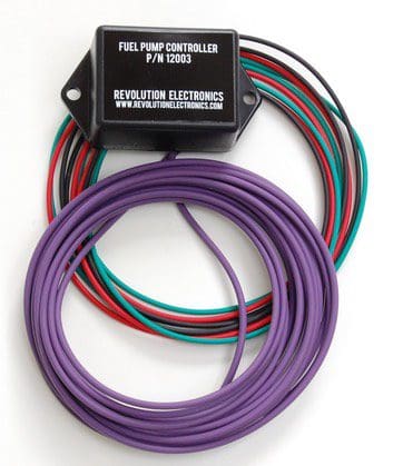

It provides full 12v to the circuit when cranking, then when the key is released to the run position the coil gets reduced voltage from the ballast resistor. For an electric fuel pump, wire it through a Revolution controller:
and search here for people who use it (including me).
