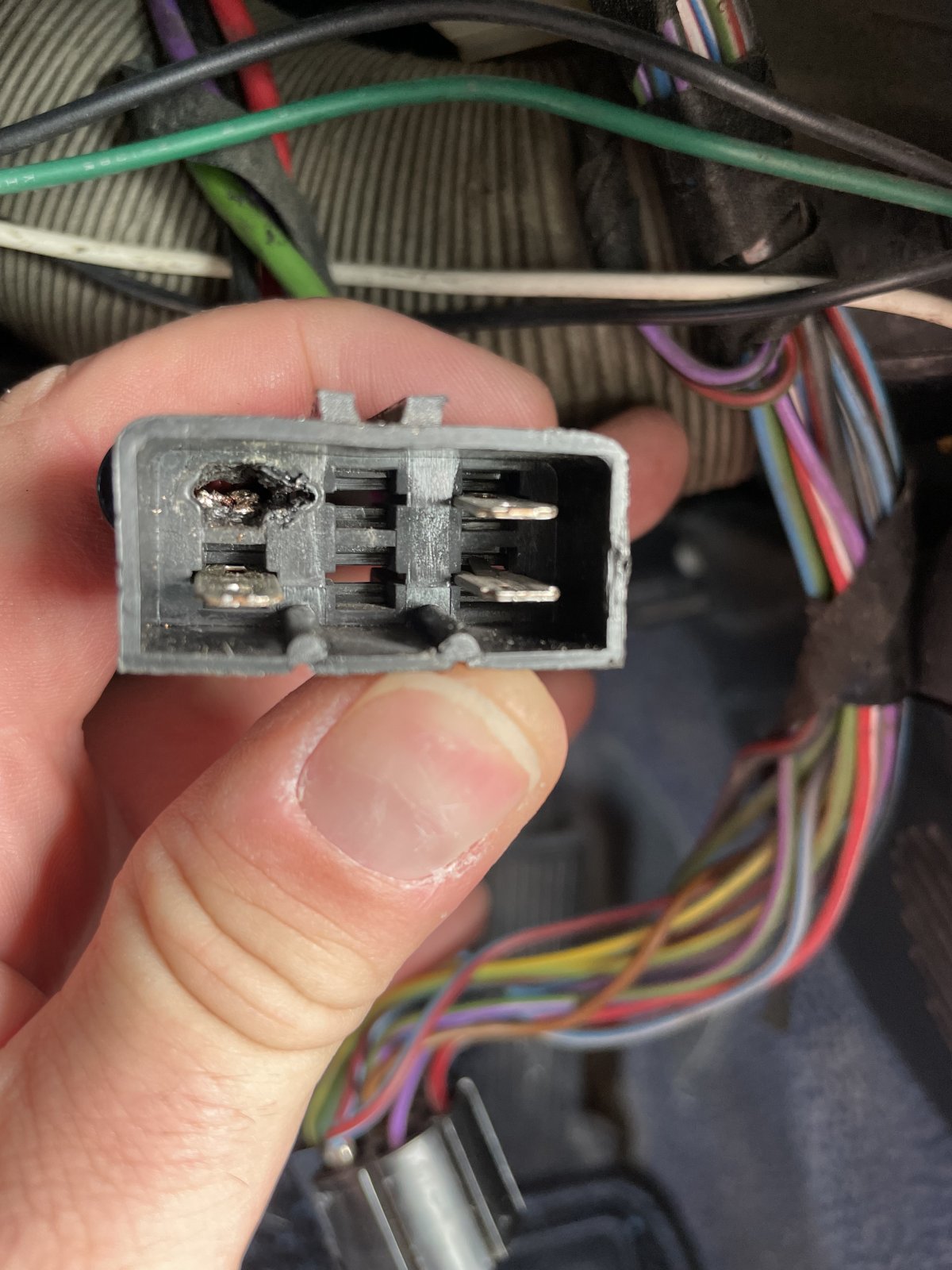

Does anyone have a part number or source for this 6-pin housing? It's the socket that the ignition switch plugs into and has 6 total slots. Mine was damaged in an electrical short and the male connector is melted into the housing. I don't want to damage this one any more trying to pry out the old spade connector.

Don't do it the hard way, Create what is known as a overlay. Cut the wire off on either side of the connecter an install a male / female wire around the connecter you are trying to replace. Splice, Shrink wrap. reinstall panels and road test.
