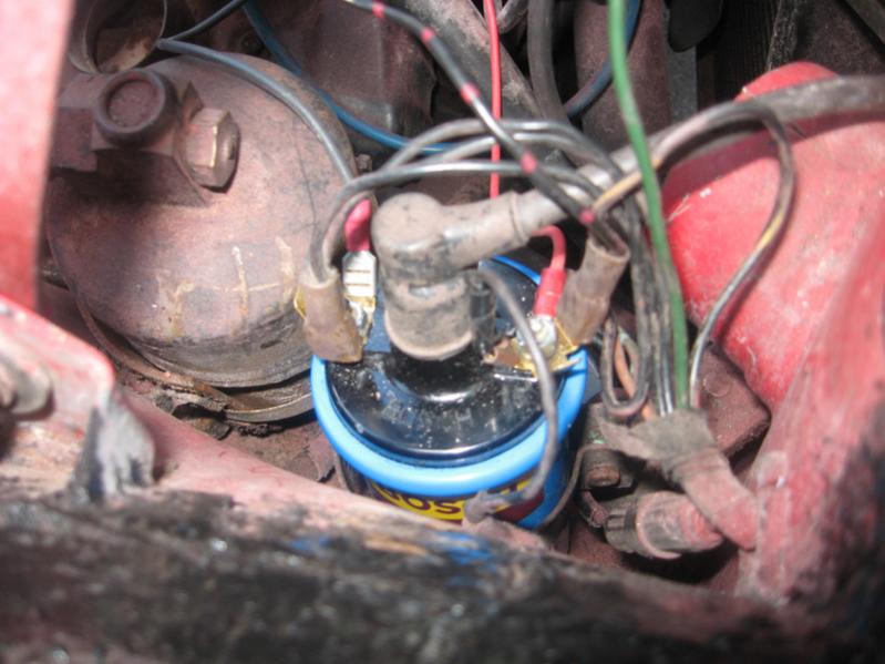

A month ago car idled and ran great, but in an attempt to clear up some ignition switch issues and clean up some bad connection and wiring, I decided to switch to a Bosch blue coil and eliminate the ballast resistor.
Car will now start but runs like total crap, sputtering and backfiring when I punch the gas.
Admittedly, I have no definitive knowledge of what the coil connections to be now that the ballast resistor is out of the equation. (It also has Pertronix unit)
I've tried switching out wires and reversing them between pos and neg on the coil, but there seems to be so many possible combinations tthat this is getting me nowhere.
Any ideas or suggestions??
All help will be greatly appreciated.
The green wire from the ballast resistor goes to the plus side of the coil. The blue red wire isn't used any more.
The red wire from the Pertronix goes to the plus side of the coil.
Black with red from the starter by pass goes to the plus side of the coil.
The rest go on the negative side.
Tach, black from Pertronix, etc.

Lastly, and most interesting, the label to the new Bosch coil faces the firewall as it is sits in the car. I thought this was a little strange, but the positive/negative poles are situated such that it makes this necessary. Most pictures I've seen of this coil in the E9 show the label facing outward, in the direction of the engine. A little strange but also opens the possibility of the polarity being reversed!!
Thanks again.

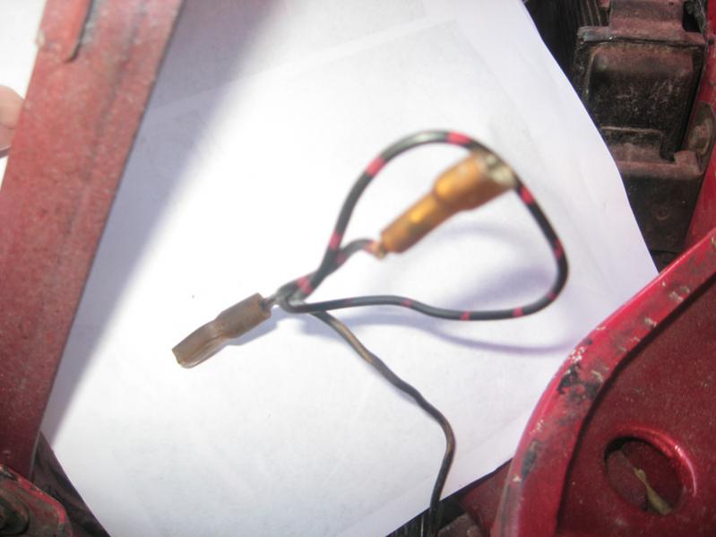

What is this wire....
and with whom does it mate??
This one is a black and yellow striped wire from a wire loom entering at the front of engine bay (behind the passenger side headlight).
It has a female connector at it end which continues as an additional black and red dotted wire.
These 2 wires heat up when I connect them, and when not connected, the engine will turn over but not start. I think this is the cause of my problem, but I'm totally confused about their connection ppoints.
Anu ideas/suggestions would be greatly appreciated

The black with red spots/ stripes is from the starter. It supplies full power and by passes the resistor you removed; only when the key is turned and the starter engages.
What I don't see on the positive side of the coil in your picture is the green wire from the starter switch ( the wire hooked on to the old ballast resistor). One of those wires is going to be hot with the key on. One will be only with the starter truning - both you can check with a meter or a test light.
The black yellow disappears to the light area- my best guess is that it's one of two things- if your car once had electronic ignition and at sometime went away back to points... the second guess is that is somehow the feed for the a/c auxillary fan relay. Normally the wire to that is a small loom of it's own coming from the firewall along the a/c lines.
Regardless, from your description one is gounding when it shouldn't. i would with an electrical test for for ground ;probe the wire to confirm. Then beginning with the starter check the black /red wire to see if it's the wire by itself that somehow is touching something it shouldn't, put on the wrong terminal of the starter solenoid, etc.
The black/ yellow- you're going to have to take the headlight surround off and trace that wire. The auxillary a/c fan in front of the radiator gets power from the battery directly. That a/c relay below the coil- there are several connections there- check to make sure nothing got bumped, etc. It has one power and through the relay sends both a power signal to the compressor clutch and a ground to the auxillary fan. There's really not much more in the front. The only other tip on the a/c relay is that it needs a good ground through the can/ cover. Make sure all those wires are fully on the relay terminals or not touching the body.

Per P61's terrific observations and suggestions, your wiring is the prime suspect. (Regarding ignition wiring from the starter, this tread and pictures may fill in some blanks http://www.e9coupe.com/forum/showthread.php?t=5428 ; Three simplified coil/resistor diagrams on page two. Perhaps you are suffering from info overload and "overlooking" something obvious? http://www.pertronix.com/support/manuals/pdf/ignitor12vneg.pdf )
At the risk of sending some mixed and confusing signals, and assuming the wiring is returned to its state a month ago (except for the new coil and minus the external resistor), here are some other stabs in the dark.
As suggested before, have you checked or adjusted the ignition timing? Even without a timing light, scribing a simple witness mark on the distributor body and the surrounding housing should enable you to return things to the way you found them. Then turn by 1-2 degree increments to see if it has any effect on engine performance? http://www.e9coupe.com/tech/autobooks/chapter3/autobooks_manual_052.htm
Returning to the petronix (non)issue. Is it possible the unit is evidencing some advanced age? (My personal experience with these is limited Allison and CD units) Intuitively, one would expect a correctly installed unit would either function or not, but the troubleshooting guide suggests the unit may become "temperamental" if its hunger for voltage goes unsatisfied.
