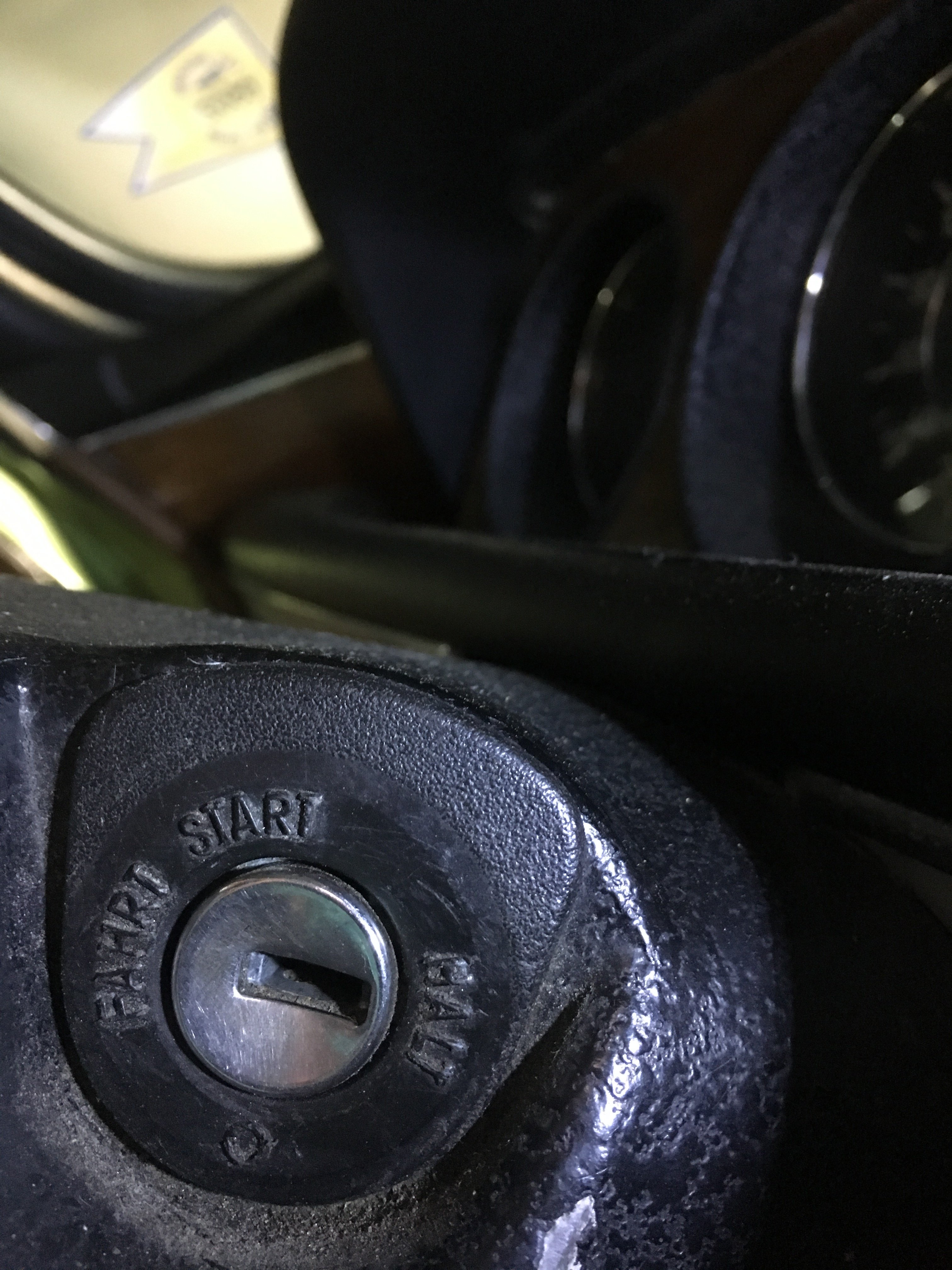

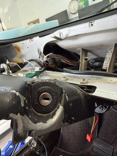

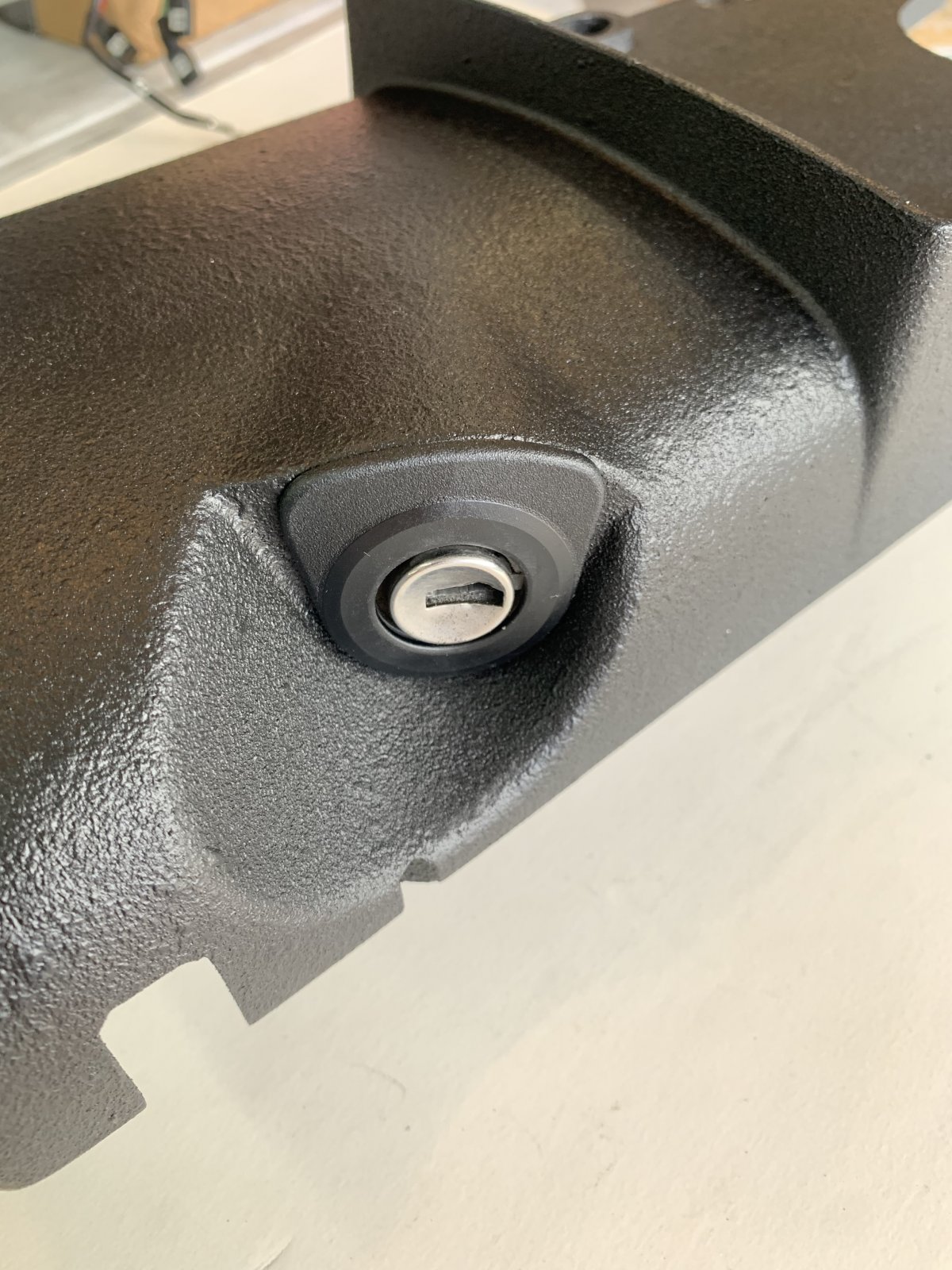

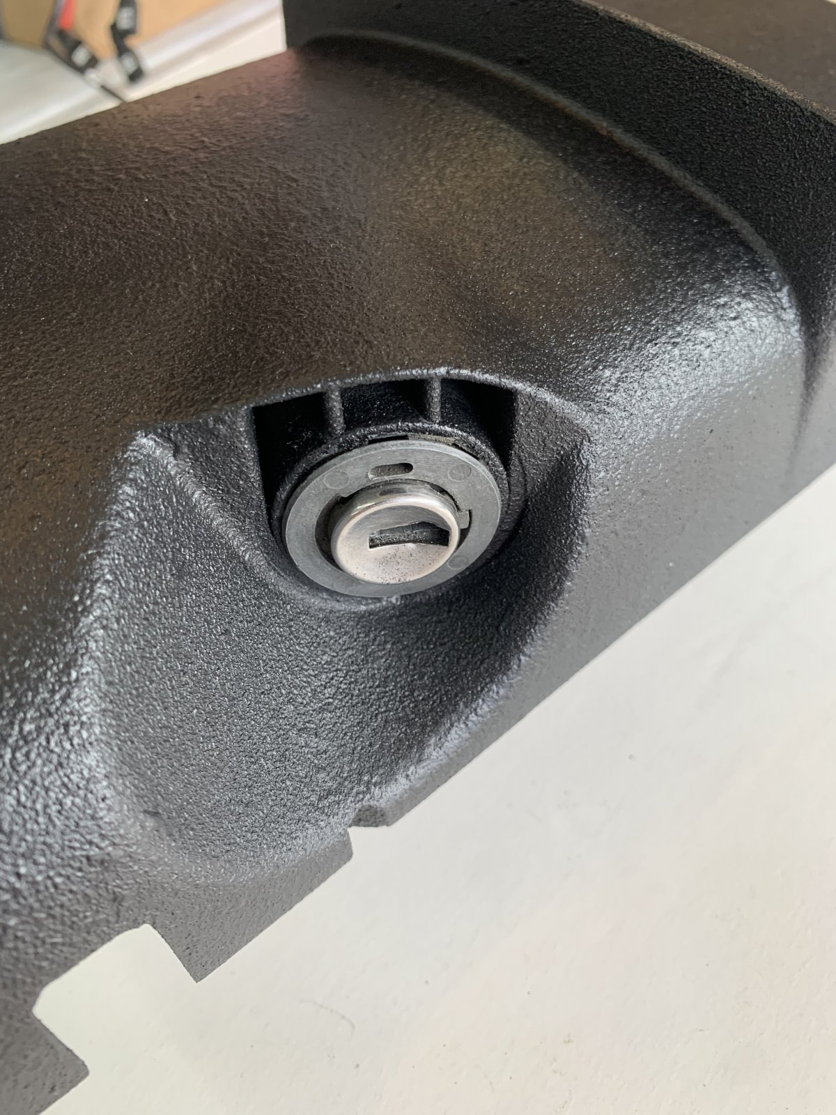

In follow up, here's a photo of the 3232 1108 979 part for 1974 and on as installed in a 1969 steering column, and one without it. It pressed in nicely and offers a bit of resistance against coming out. There is a small gap between the hole in the cover and the rotating hub of the ignition switch but it should go unnoticed by most :-. The 3232 1105 071 version for cars up to 1974 would likely fit better if available. However, I presume it would need to have the whole expanded to be installed on a 1974 or later model car as others have mentioned.

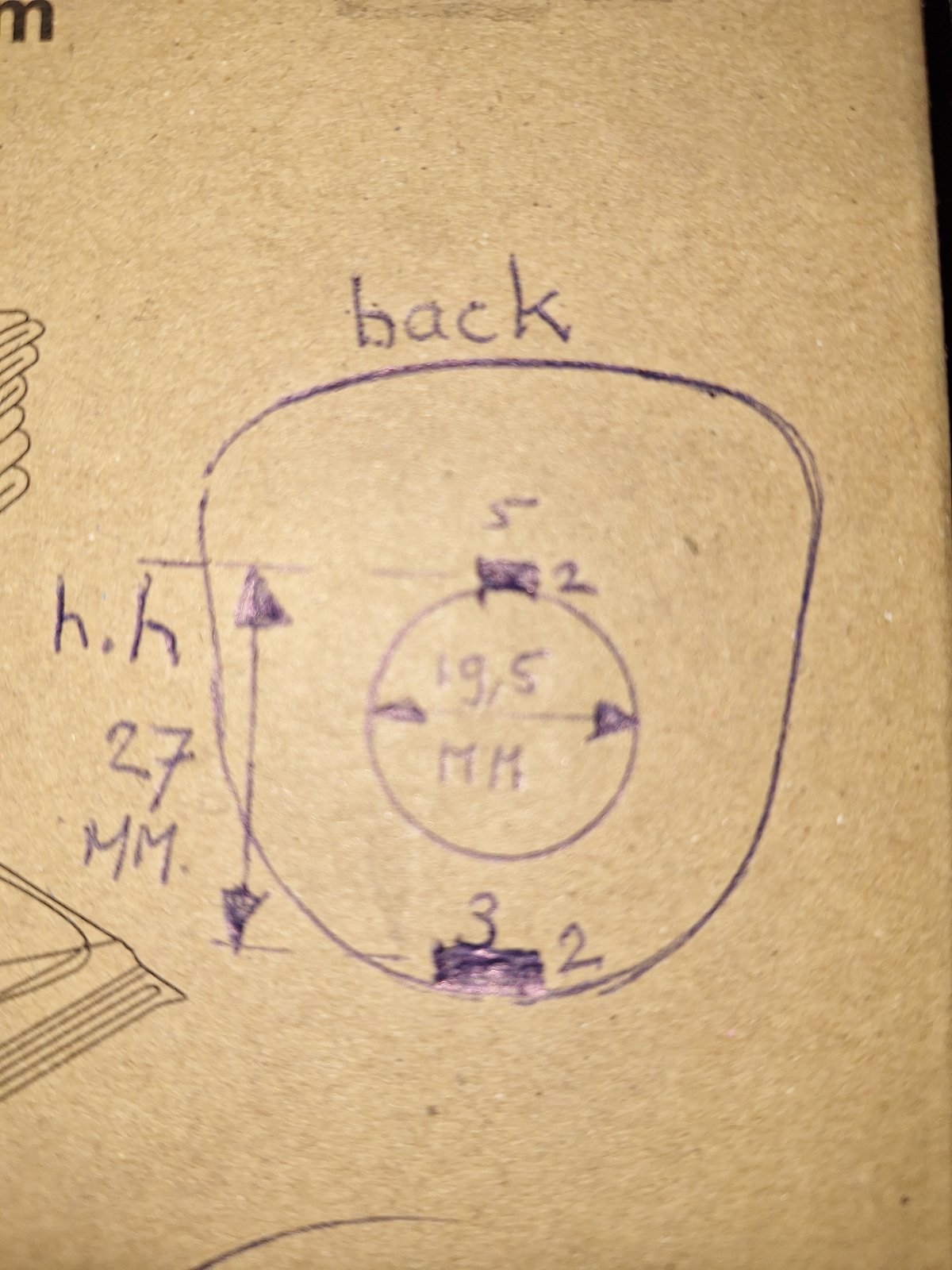

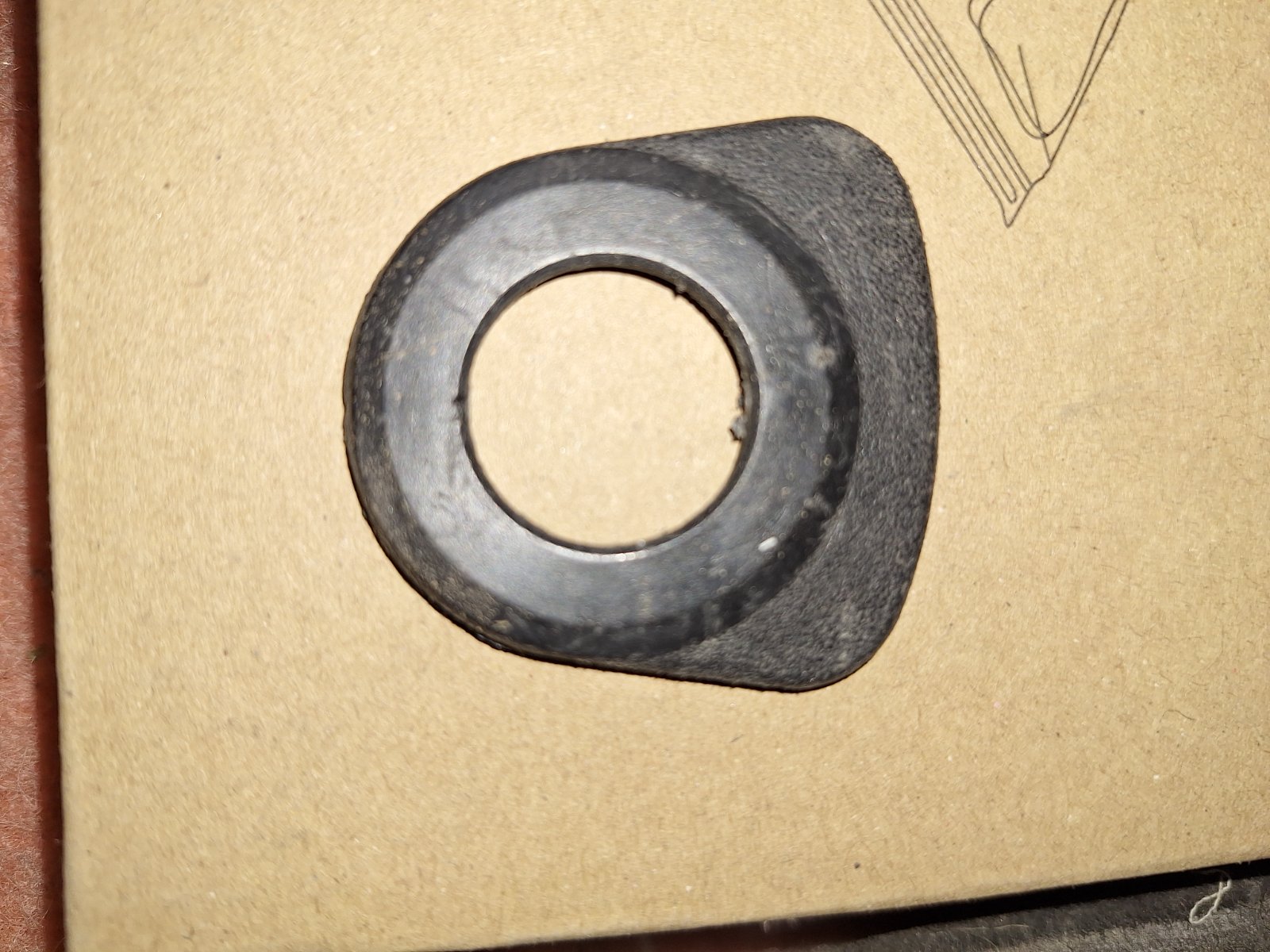

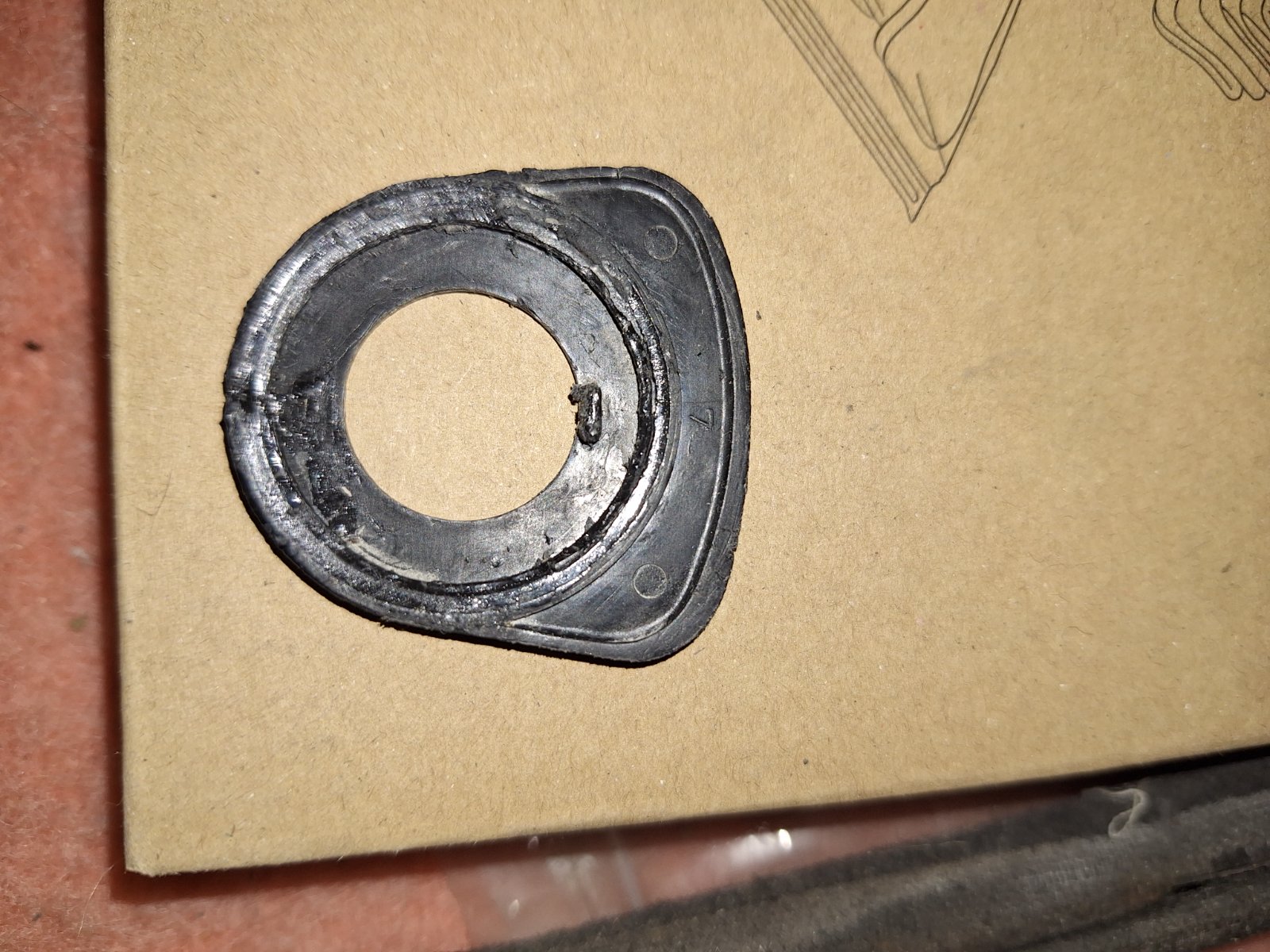

Hi Rek, you can borrow my ignition lock cover for a short period. A mounting on the back is broken. I've made a drawing with the dimensions. The ignition lock cover is from a 68 2800cs. Could you please send me an email with your address? Regards, Hans

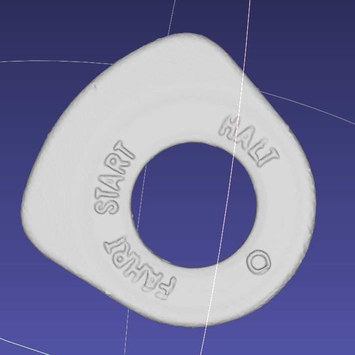

Ouch! For a little piece of plastic? I have a friend with an SLS 3D printer, hence my question. He can print it for nothing so long as there is a scan of the part.

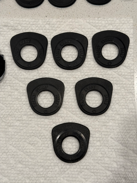

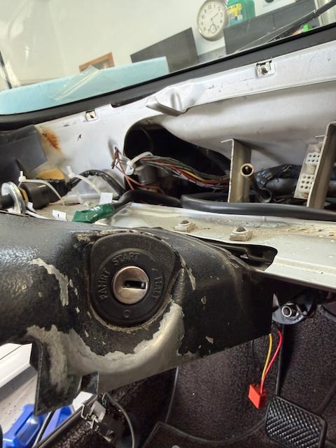

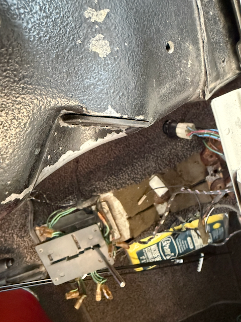

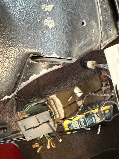

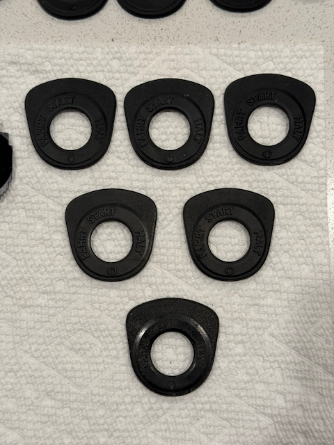

Hi, I have reproduced the scan I previously posted. You can get the stl and cad files from here. GoogleDriveKeyCover.

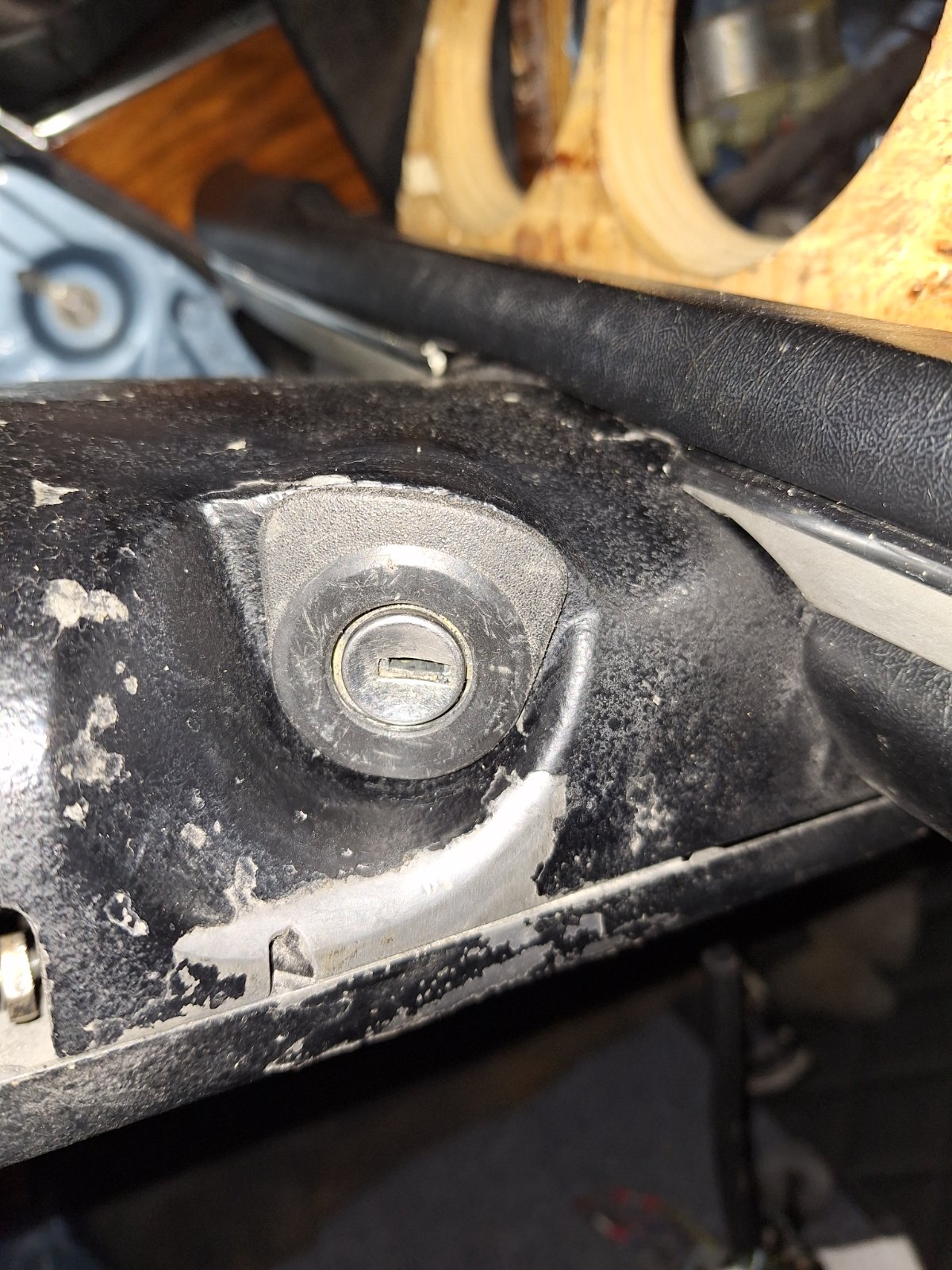

The first picture has one original and my copies. Other pictures are the new version mounted. I used a resin printer with Elegoo ABS like black. It is stiffer than the original so it takes some effort to get the cover on. I used a small file on the pin in back just slightly to get it to fit. Hopefully the dimensions are similar for all cars. Mine is a 1970 which has an older ignition switch.
