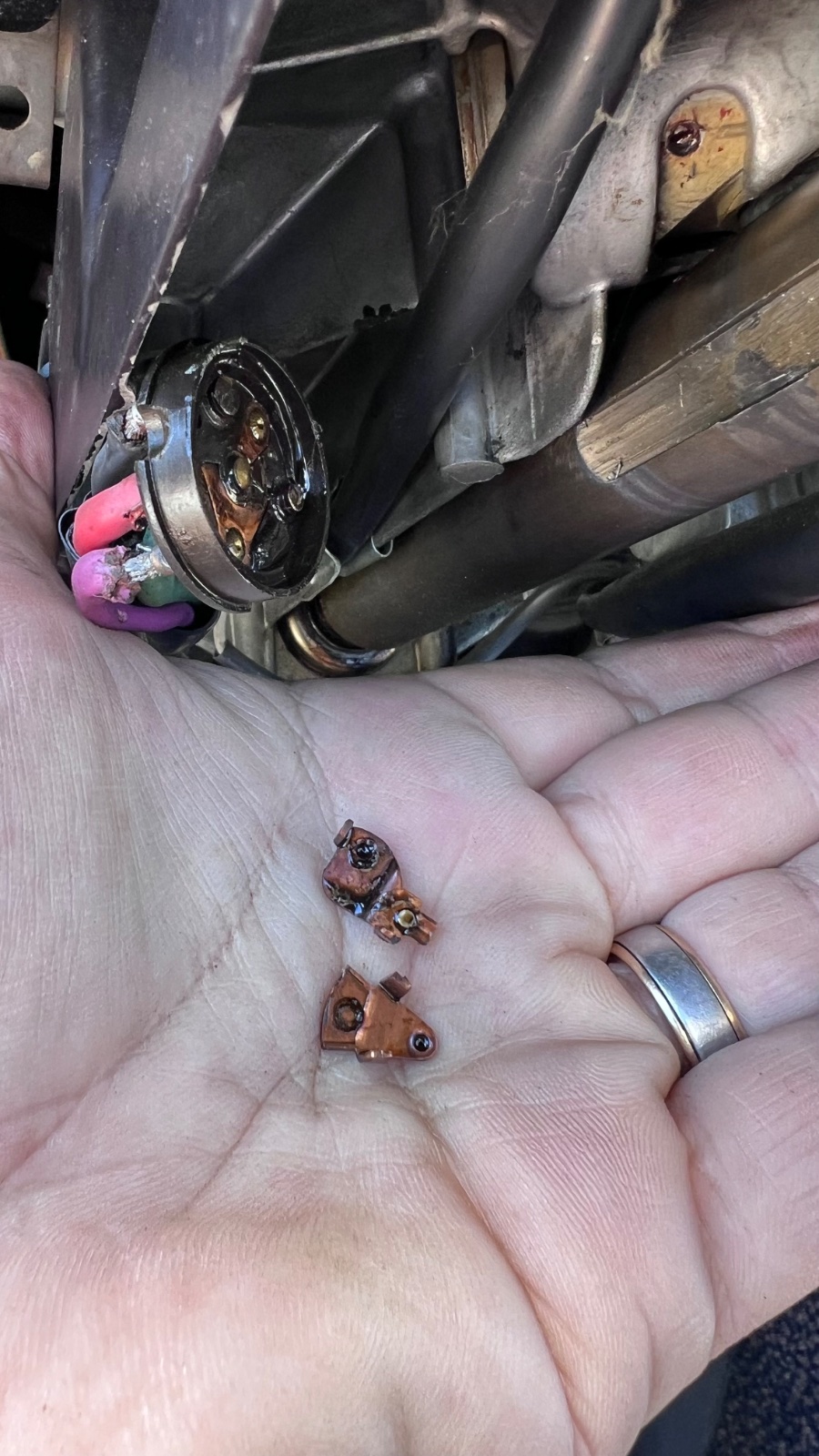

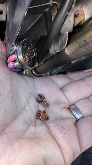

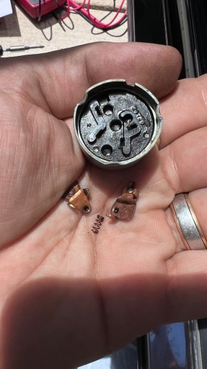

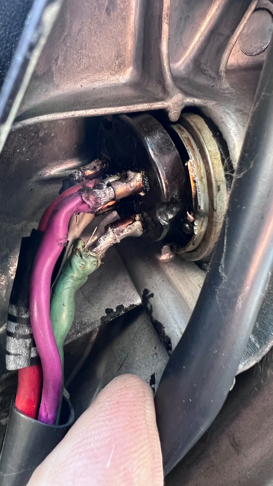

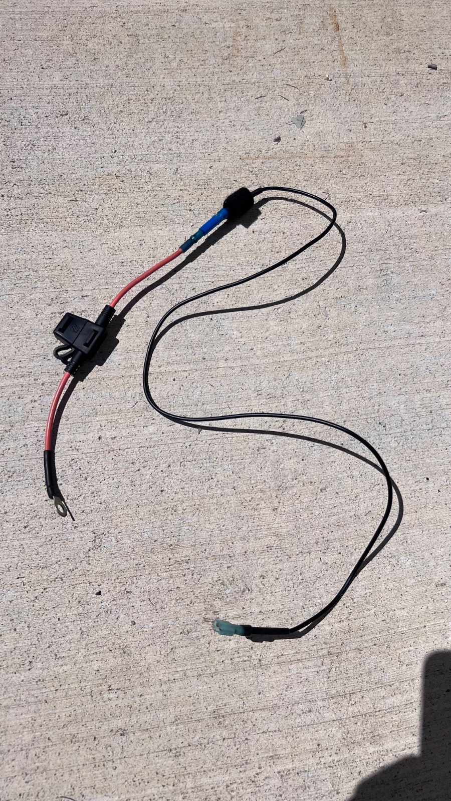

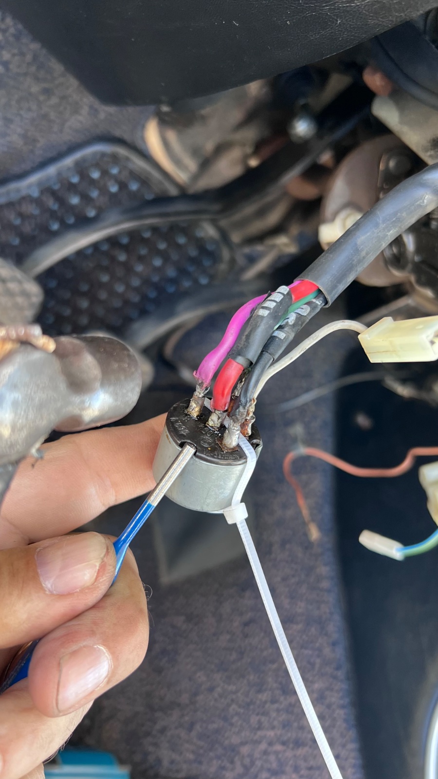

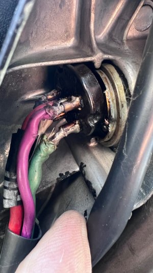

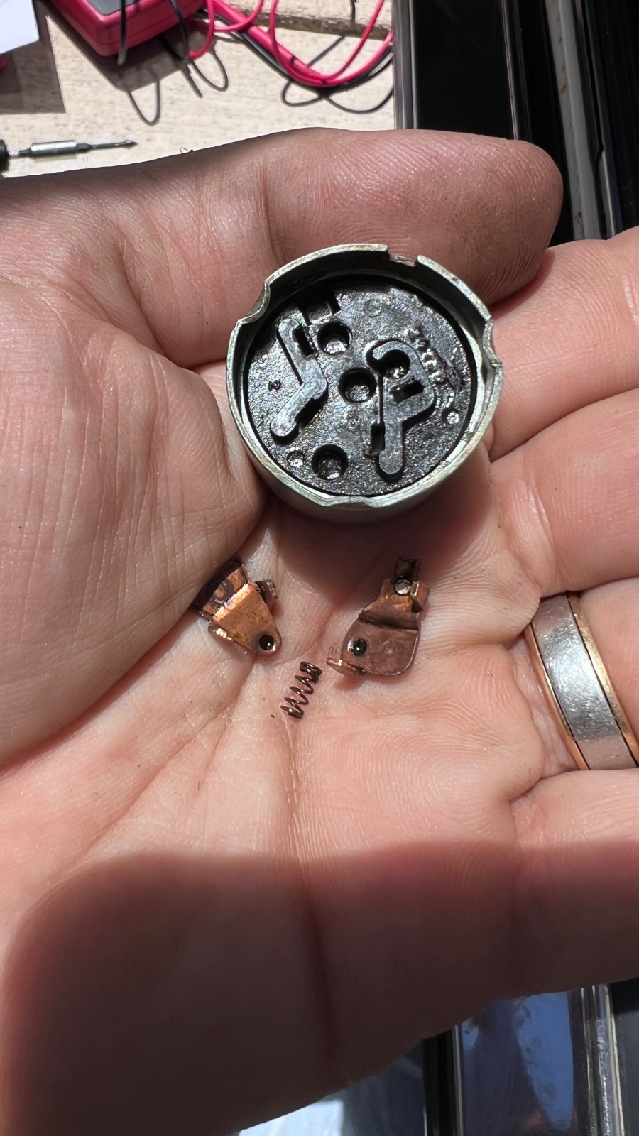

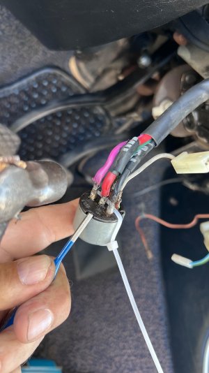

Traced my intermittent ignition issues down since it finally gave up the ghost. Back of the switch popped off. Looks like it had issues prior and repaired so of course I attempted to repair it to make sure 100% this was the only issue. Apparently there were a few missing pieces (found a spring hidden in the CocoMat after putting it all back together). If one knew the spring location and contact plates orientation, you could bend the detents back with a pinch to hold it back. I ultimately ended up replacing the switch.

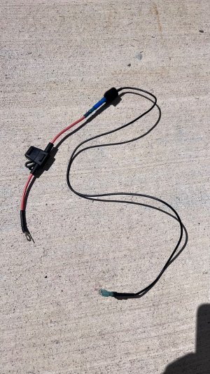

Got my yoga stretches in for sure, but happy to not have to jump the starter to get going. Made a nice jumper that I will keep in my emergency kit though!
