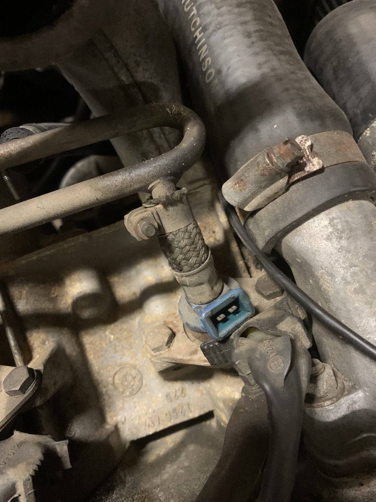

Helping a guy out and have hit a wall. The braided hose has failed on injector 1, injector 2 looks to be just starting to do the same. My issue is those crimps that hold the bottom of the fuel line to the injector. Pulled out the blue books and they look to be OEM that way. Am I right to think that if I cut away the crimp and peel back the old line I could push on a new piece of line and then drop a hose clam on it? Have put the @sfdon signal out but think he's off spelunking. :)

My operating assumption is that if I carefully cut away that bottom crimp and expose the barbs on the top of the injectors I can then push on some new hose.

In case anybody else is reading this with the same issue of those OEM crimps on the injector hose I can confirm that if you remove the injectors from the car you can VERY CAREFULLY - (LIKE TRYING TO ARM AN ATOMIC BOMB) - grind off a section to reveal the rubber inner section. If you are then REALLY REALLY REALLY GENTLE - LIKE DEFUSING AN ATOM BOMB GENTLE - you can twist off the old line without damaging the top of the injector. The injector 'inlet' - the bit the crimp sits over does have a barb on it so you can simply push on a new hose and hose clamp.
