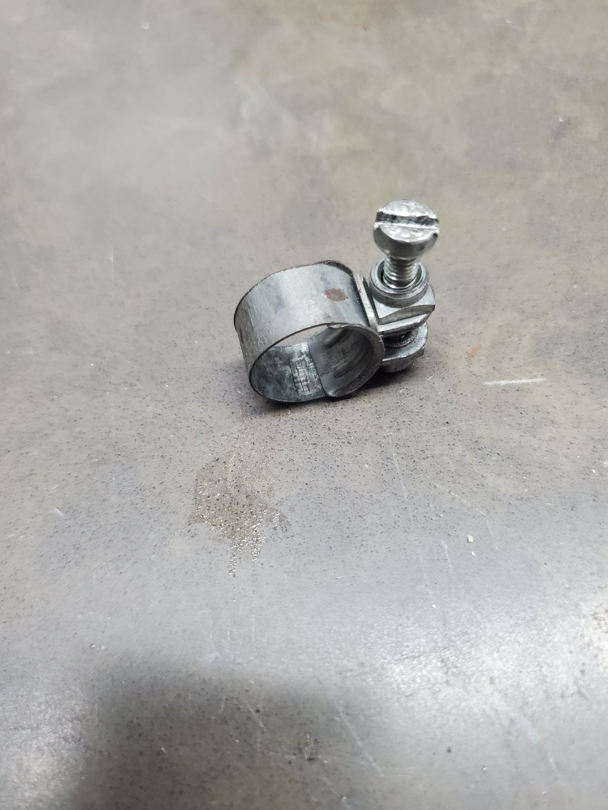

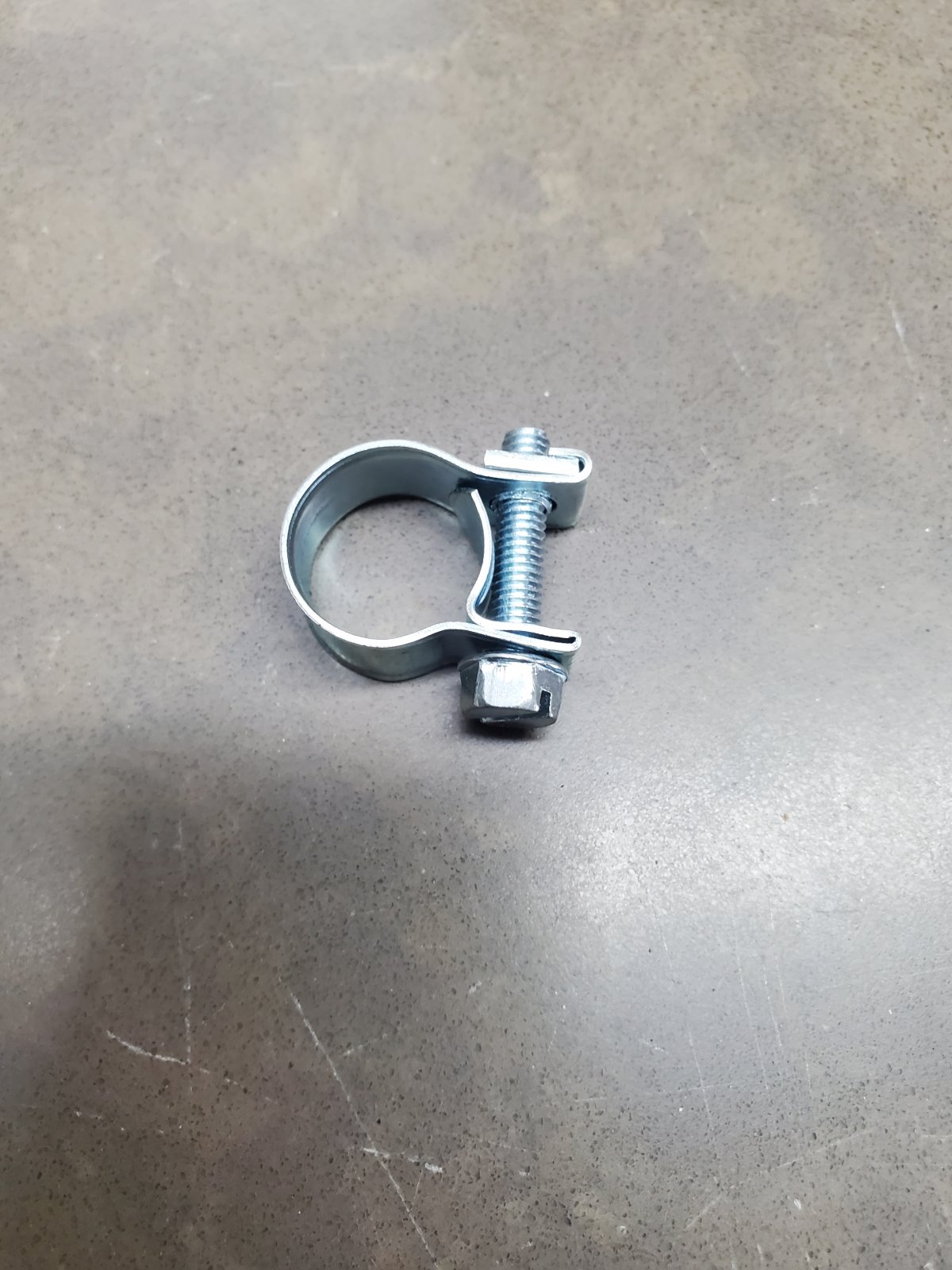

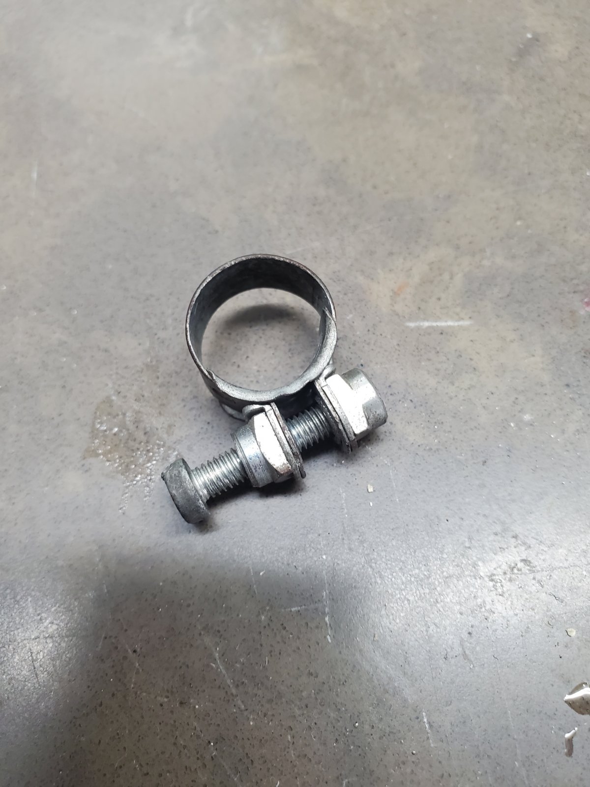

Yup. Here are the ones that were on the car and the ones I replaced it with.
The primary issue (I thought) was the the inability of the ones on the car to tighten down enough.
I believe I've disproved that theory and believe it related to the fuel rail and my ham-fisted removal process with a razor knife, but would like to hear your theory...

Looks like there is a 15 on the clamp.

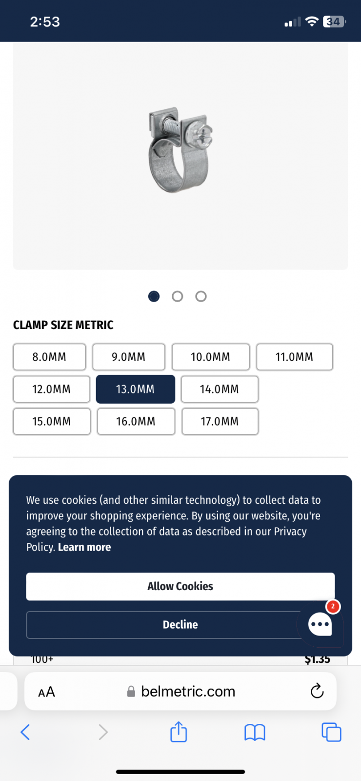

Best to match clamp to hose. 13mm hose needs 13mm clamp.
Pulled the plenum and fuel rail off. Cleaned up the nipples (they looked fine) and put it back together with good Aga 13mm clamps, and no leaks. I'm sure something else will crop up in a months time...
