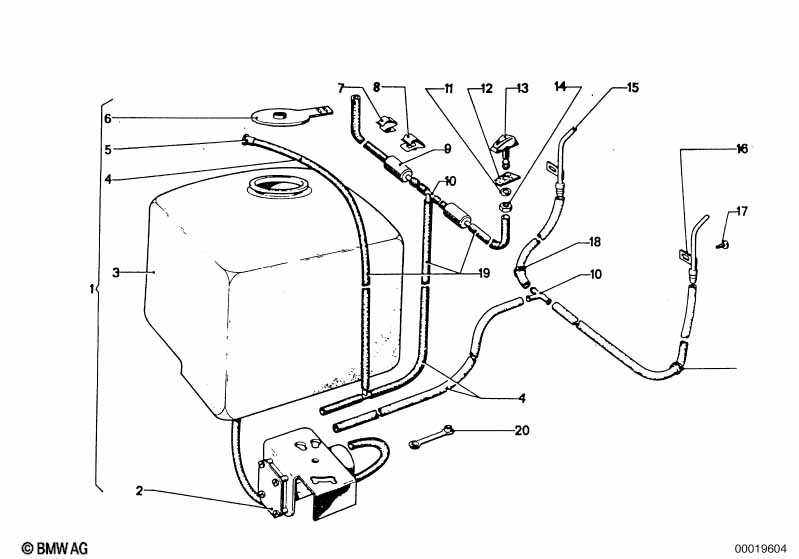

Windshield washer reservoirs may have had vented caps, but were they originally fitted with a vent overflow tube, a la the coolant reservoir?

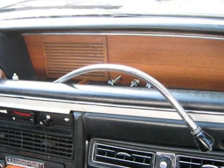

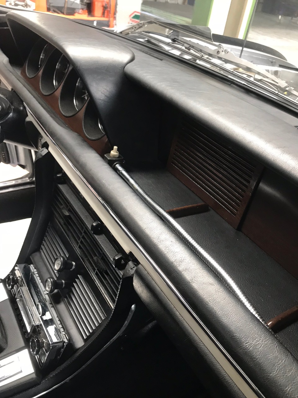

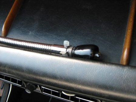

The courtesy light was replaced by a map-reading light on the dashboard for ‘rallying’,
I know this has been discussed but did all carb CSL's have a map light? Were they added to the cig lighter or bolted to the dash in front of the speaker opening?​

Map light is attached to parcel shelf and extends to the right side.

Thanks Chris! I need to find a map light but there is no way I'm drilling holes in my dashboard. :D Good to know about the 3.45. That makes sense actually. I hear solexes thrown around from time to time. Did any E9's come with solexes ever? Maybe the Alpina cars.

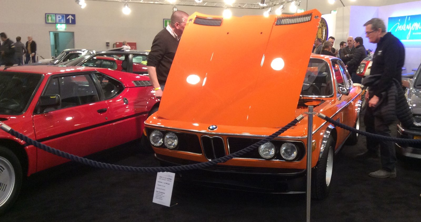

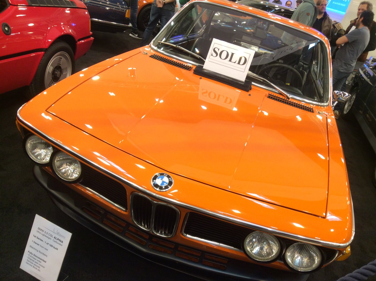

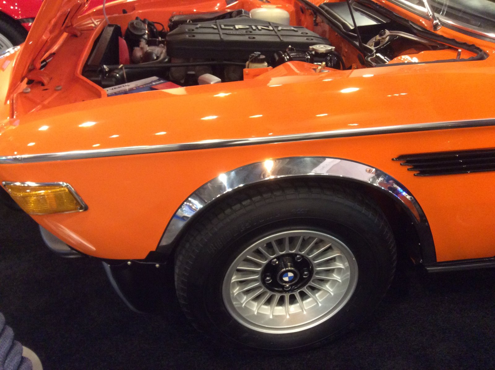

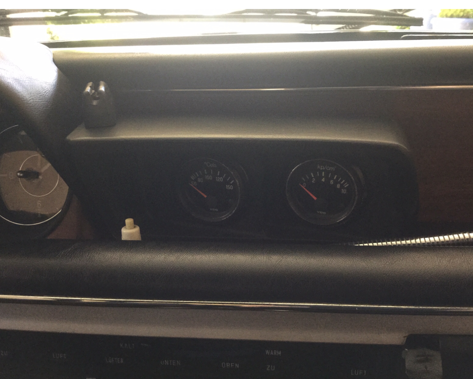

It should also have the Alpina Momo wheel and not a Petri. And i wouldn’t be surprised if the depicted Petri is a 40cm. The dash lamp, if one could find one is super cool, don’t know if all the carb cars had them..... first two pics are from a 2275 Bat, the last 2 from a carb Csl. So this too was an add on item.
I believe the Carb Csl’s didn’t have sway bars either (maybe just the front ones?)
Same engine/ carbs as the standard 2800CS/ 180hp, 3:45 diff.
Trunk latch without lock, with lock had to be ordered
Kidney 5 slat black anodized whereas the hood&fender grills were in both, black and chrome on Inka cars. They black grillls weren’t Matt either, the same as we can get today. Attached pic of the first hand carb Csl (sold for 400K€‘s supposedly) with black shiny grills
And they have the paint wrong on the front fender, where the black meets the orange, step is missing!
Needless to say, all subject to corrections.
