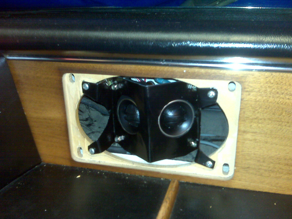

i agree that there is much better way to do sound ... but this is a good place to put tweeters - see the attached pic that i found a while back . i ended up putting tweeters in the side ashtrays - by replacing the metal / vinyl with perforated metal. i prefer the look of the wood speaker grille to the speaker grille delete versions. i still have a speaker behind the speaker grille, but i haven't decided whether i will end up putting gauges there or put a GPS screen there (covered up by the speaker grille) except when i am using it.
This is excellent - a custom made bracket I presume.
