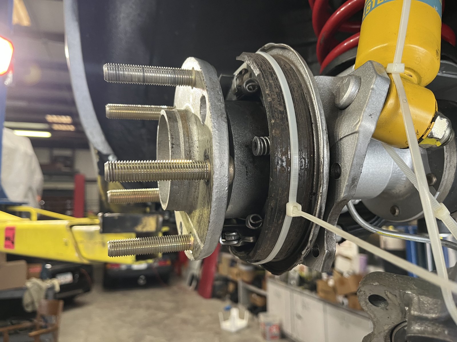

Installing longer wheel studs..... a shortcut
Follow the instructions from John B

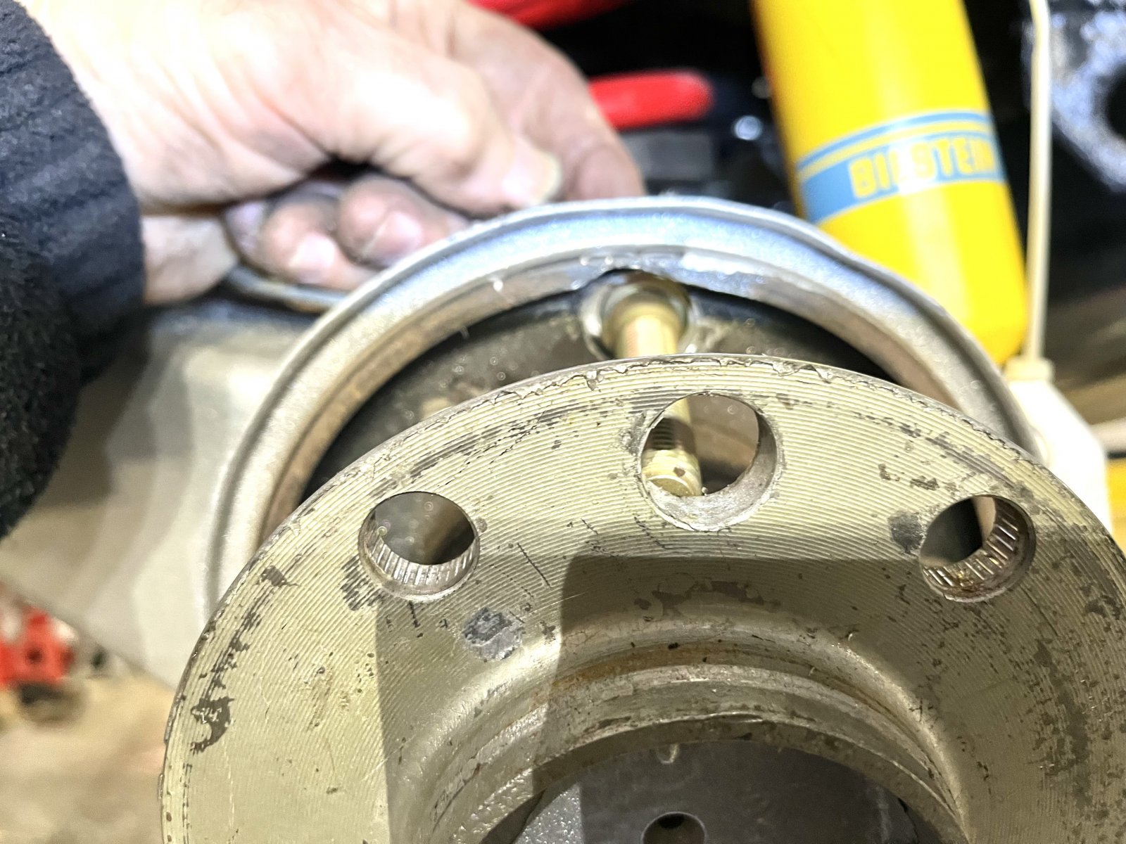

My old studs were knocked out with the tap,tap,tap of a hammer. (Barbarian method).

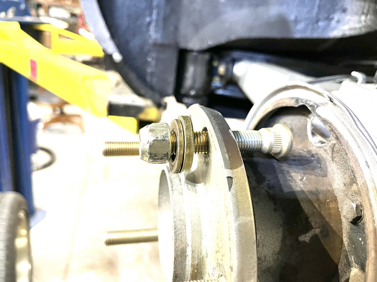

Washers and an old 19 mm nut pull the studs into place.

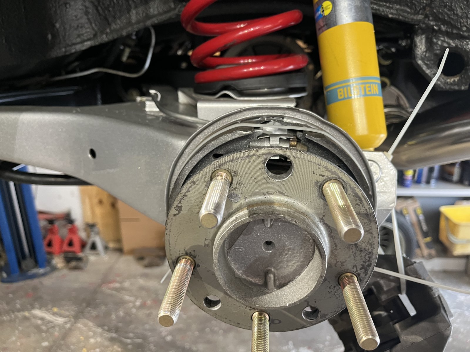

Parking brake reinstall, note the “helper” zip ties.
Next, reinstall the brake disc and brake caliper assembly.
Passenger side where the studs have yet to be installed.
