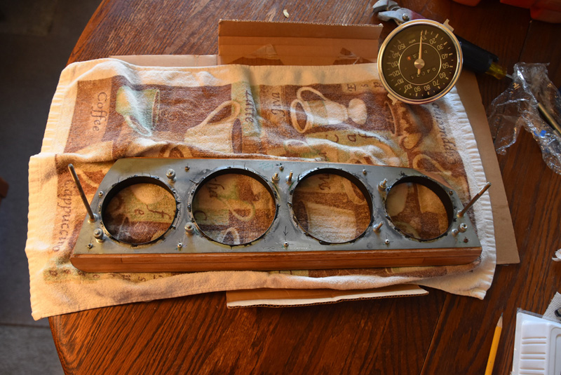

B bavbob Well-Known Member Site Donor Messages 3,788 Reaction score 1,896 Location Boston, Ma Oct 24, 2019 #1 Have people re-soldered the black rings in the cluster or just used a little crazy glue or equivalent?
steve in reno Well-Known Member Messages 614 Reaction score 79 Location reno,nevada USA Oct 24, 2019 #2 I used 2 small spots of siicone each
Peter Coomaraswamy Well-Known Member Site Donor $$ Messages 3,801 Reaction score 923 Location Austin, TX Oct 25, 2019 #3 A couple dabs of JB weld
M mark99 Well-Known Member Site Donor Messages 1,604 Reaction score 267 Location Kirkland WA Oct 25, 2019 #4 5 minute epoxy / quick JB
Dan Wood Well-Known Member Site Donor Messages 1,039 Reaction score 836 Location Newnan, Georgia Nov 3, 2019 #5 I soldered and wouldn't recommend it. Next time would be JB. If you use rosin it can bleed down onto the face of the wood.
B bavbob Well-Known Member Site Donor Messages 3,788 Reaction score 1,896 Location Boston, Ma Nov 4, 2019 #6 5 min Epoxy sounds good. Thanks, all.
