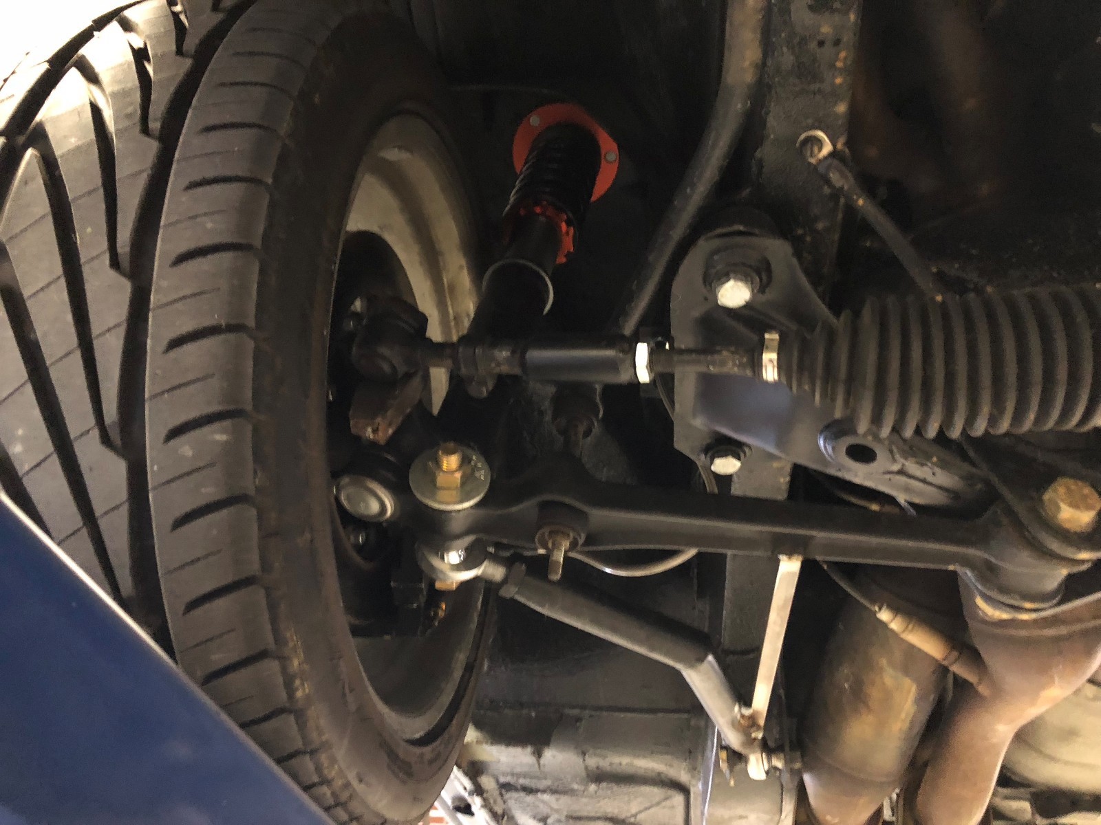

I asked:
Hi there, can you describe the mods done? Was the suspension changed? How would an engine transplant affect the steering? Got any more pics of the underside? Also, what all rust areas were fixed? Thanks
New message from: broadbandholdings (26 )
suspension is all new
more pics uploaded
all rust removed - most serious areas were the rocker panels and the towers
am told that the new shock towers are at an angle and that they should be perpendicular - all a function of the engine that was installed

Suspension is all new, but the suspension geometry is screwed up. I think you nailed it Rob -- a MadMax job not done properly. If you look at his thread, Brendan posted about the need to move the boxes that the cross member mounts to back in order to get his suspension geometry correct.

ya, s0meone didn't know how to setup suspension. May not be TOO hard to fix???

It looks like the tube is welded at the arrow, if so, I hope the one who did it knew what he were doing, there are quite a bit of force going through there while braking. I'd much much prefer a bent tube, or a straight pipe/rod.
And something looks fishy where the steering rod is attached to the steering knuckle.
