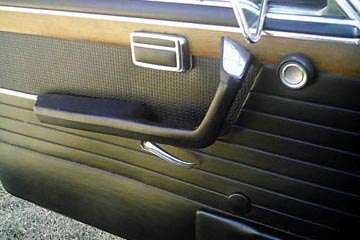

Don't forget plastic door handle trim, special screw, door handle, door pull, map pocket
sfdon
8,267
4,622
sfbay area
The other goodies.
