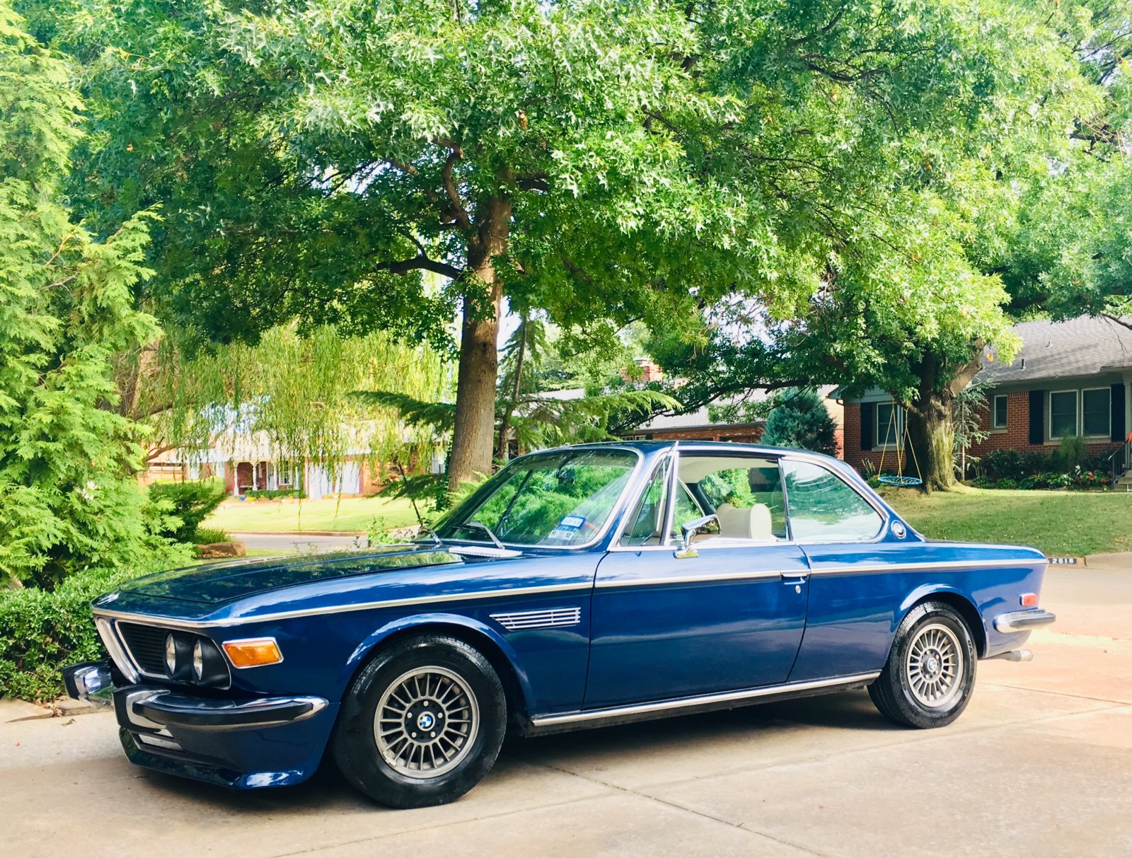

Well, she's just home from paint. We modified an E24 front air dam and added it. Next, going to rebuild the webers - then she's again off for interior restoration. Would enjoy hearing from anyone with suggestions on rubber for doors/Windows and wood kits

The car looks beautiful! :)
Appreciate it gents. didn’t do a frame off - but did take her down to metal - and just some oxidation - very light - on rear deck - but (zero) rust throughout the whole car. thx california. so this is one i’m going to drive a lot and just enjoy for now - fully restore before i kick off (i hope). thx again ✌

Wow, your combo looks very much like my E9 - is this Nachtblau with Lotus? I've also been thinking about a lower air dam after I damaged the original a few years ago at Monterey. My first choice is an Alpina style but keeping the front bumper.
Absolutely love this. Would love more details on how you modified the E24 airdam. Despite some perhaps calling blasphemy, I was considering repainting my Baikal in Polaris (needs paint no matter what), but this color may have me swayed. Is this Nachtblau as E9Wayne pointed out? Not always easy to tell with how different colors look on different screens...
thank you and yes - Bmw code#40 Nachtblau - just liked the lines and style of the e24 air dam - we had to split it and take out 2.5-inches side to side and about 3-inches top to bottom to custom fit it but i think it works

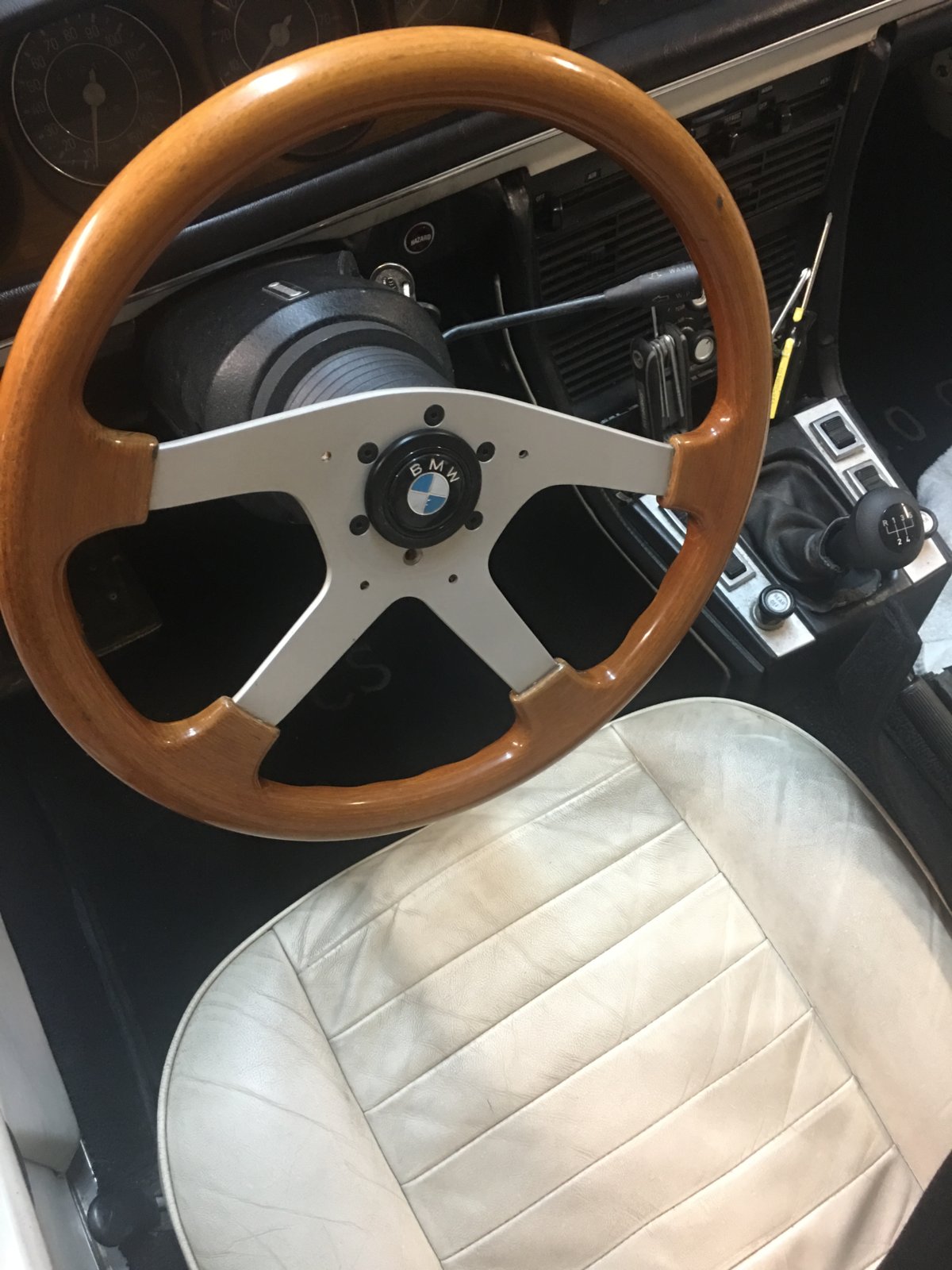

while writing has anyone refinished a steering wheel-nardi etc (here’s my momo) - thinking i can strip- sand and stain a dark mahogany to match wood and seal with a urethane ??? need to rebuild weber’s and will defo have some ?s in advance there ✌
