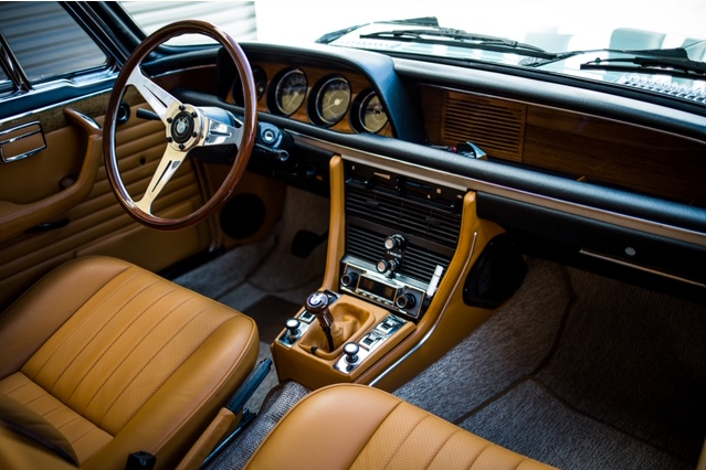

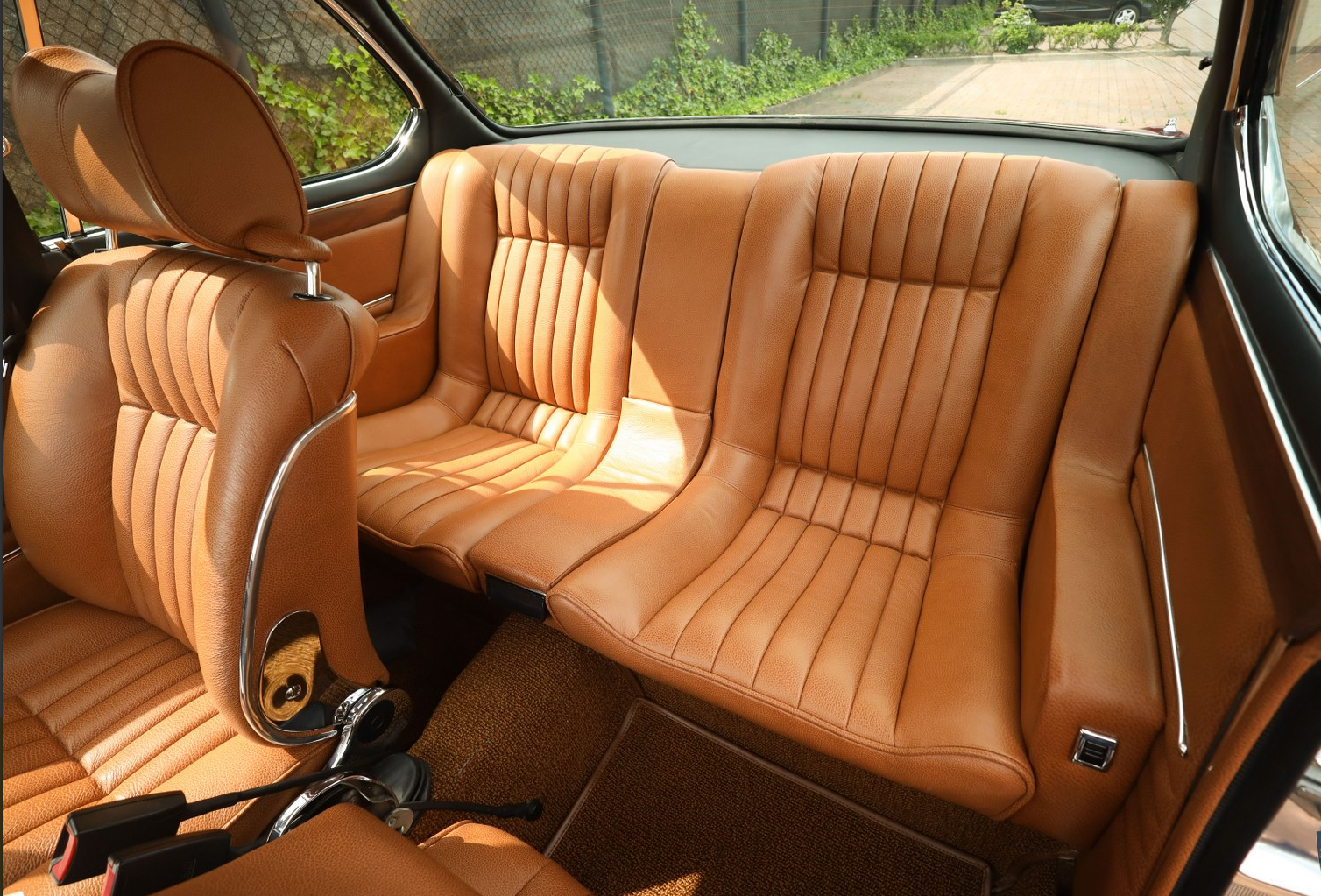

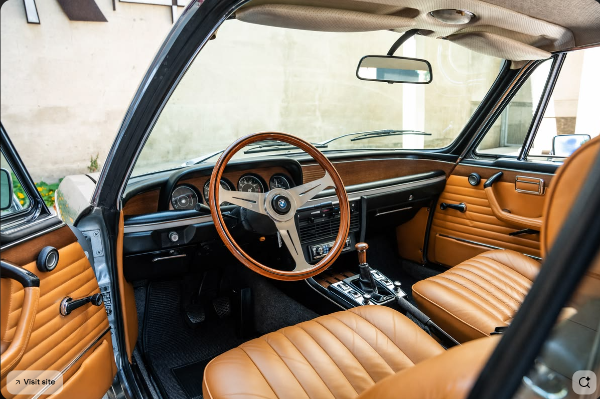

As beautiful as the car is, I’m starting down the path of making it “mine,” and part of that will involve redoing the interior. At the risk of offending the purists, I’ve always envisioned a cognac interior - specifically Polaris over cognac - which has long been my dream combination (inspired in part by a 300SL Gullwing I once saw).

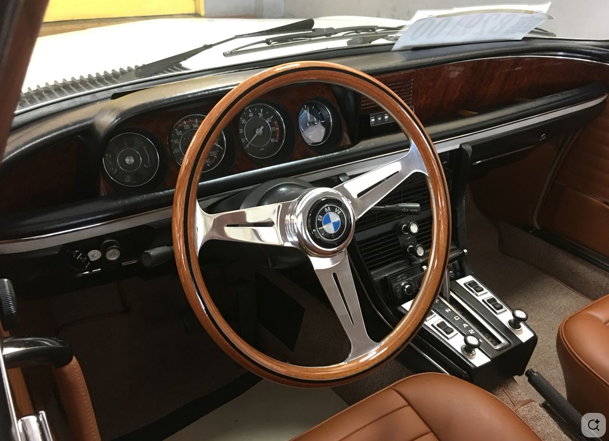

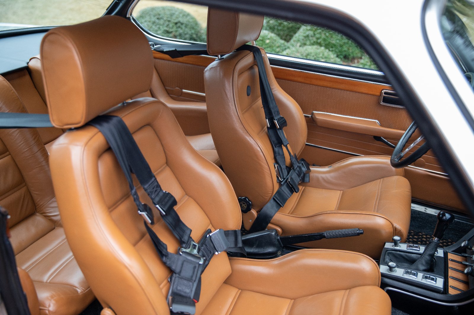

Other inspiration comes from this forum, including @paul
Oldenzaal:

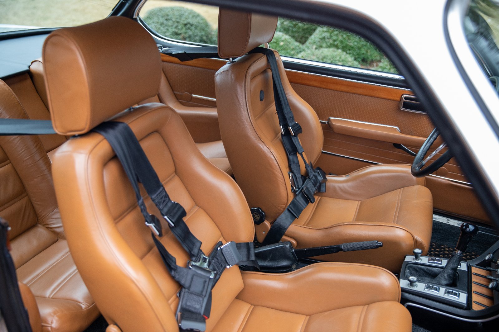

And others:
I’ve read just about every thread here that touches on interiors - GAHH, World Upholstery, leather options, etc. - and I’m trying to pull all of that information together into a clear path forward.
I’ve been in contact with both GAHH and World Upholstery/Newark Auto and have samples on the way. So far, most of the standard “BMW” colors look lighter than what I’m after. They’re each sending some non-BMW options as well, but I’m still struggling to visualize how everything will come together across materials - vinyl door panels, leather seats, carpet, etc. As a result, I’m starting to think a fully custom interior may be the right path.

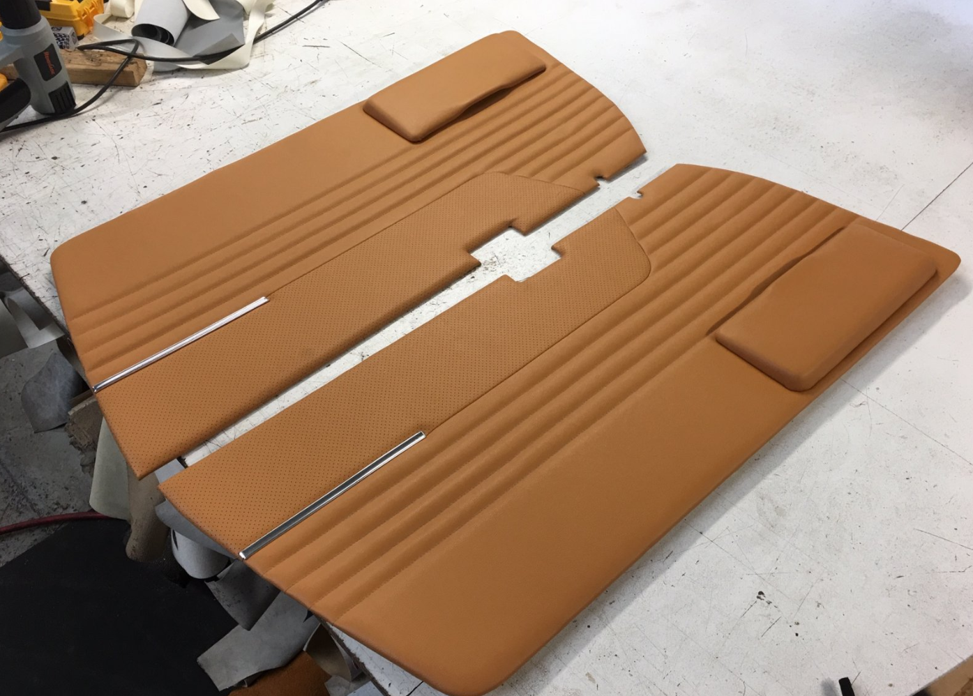

LTIII--Welcome to the forum as the new owner of Steve's amazing Coupe. Since your car is in Naples, you might want to drive across the Alley (I-75) And see the work that Shamrock Auto Trim did to my car here in Davie and go to their shop in N. Miami Beach. They are a family owned shop that I have used for several cars in the past 35 years. They have worked on quite a few vehicles that have won at Pebble Beach. They buy leather and other materials from all of the known sources.
This pic shows the addition of the map pockets that were white and now covered in matching leather and the leather covered arm rests on the door card. That is just a small example of their E9 work.

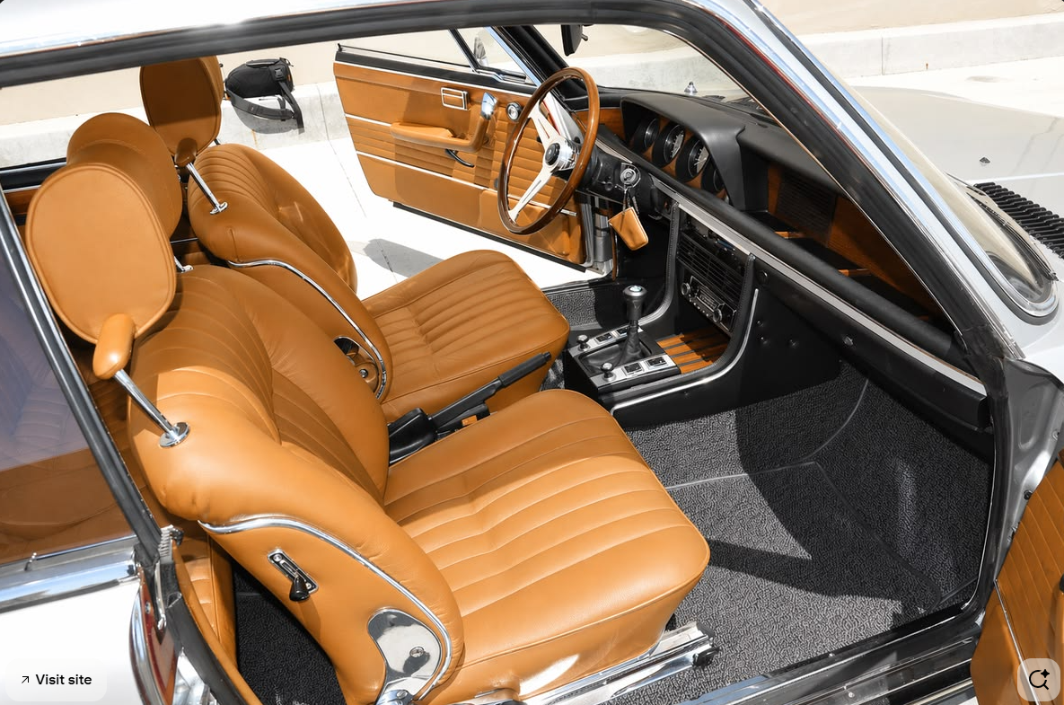

My interior is done in Congac. Specifically, a Mercedes Benz pre-WWII Congac leather from car I saw at the Carmel by the Sea Concourse in 2016. I acquired a set of Koenig seats (along with the rears done in a similar leather pattern), sourced a swatch of the leather, had the dye made up and dyed the interior myself.
Finished product:
In process:
I still have the original seats from my car, and could probably source a center rear armrest as well. If you are seeking seats to recover, send me a pm.

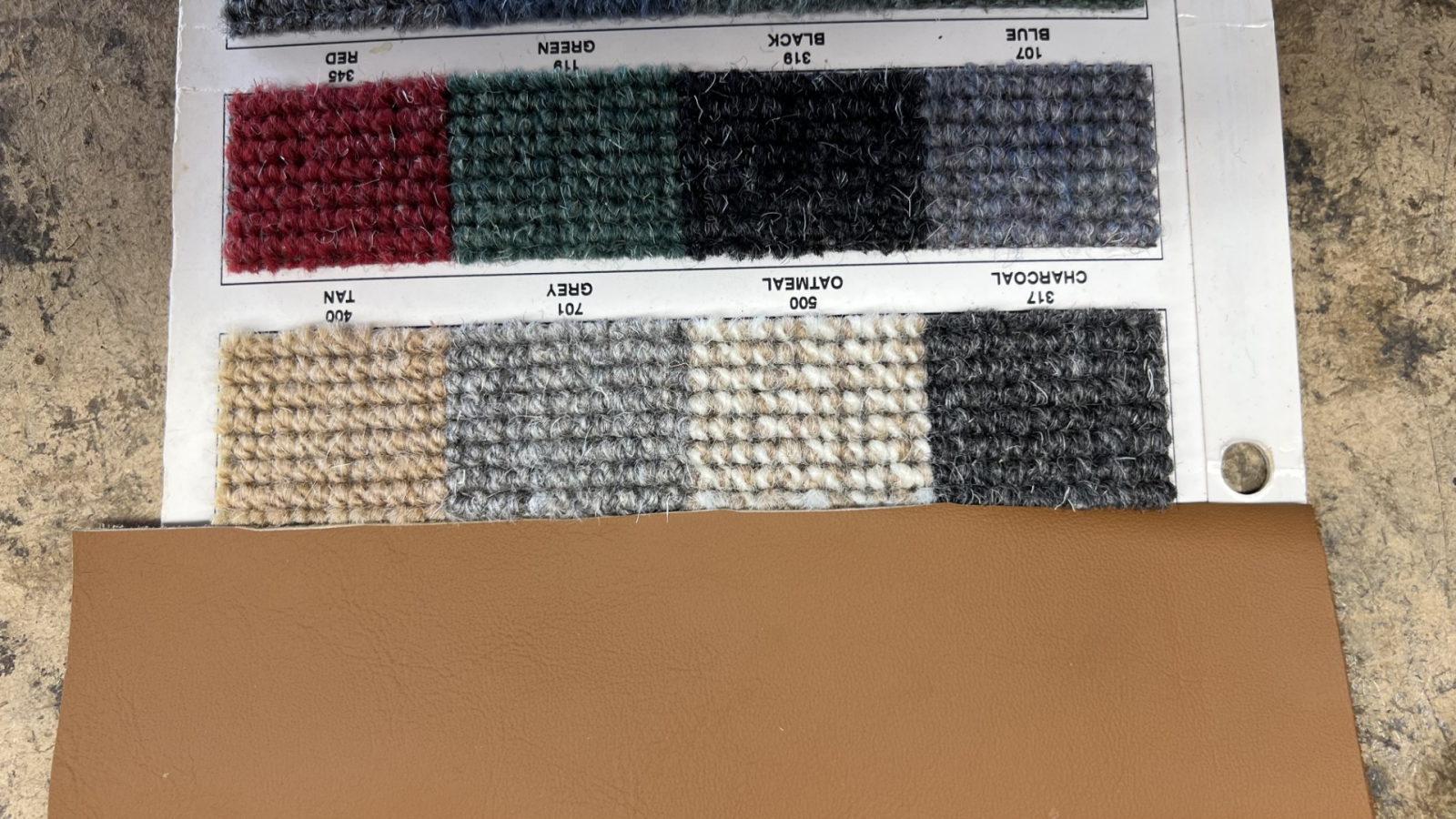

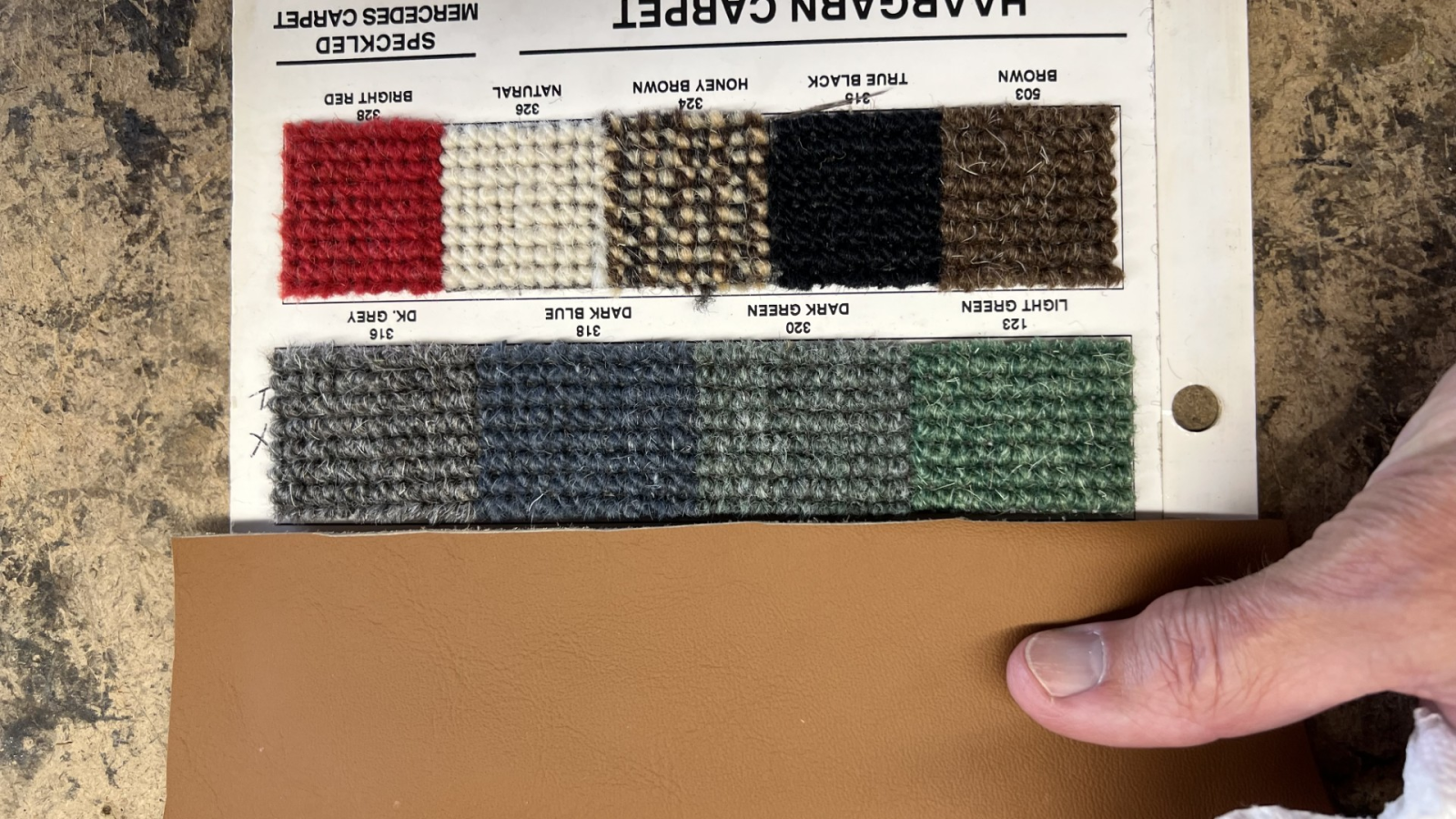

I ended up going with a leather called Ferrari Tan/Cuoio (A-2873).
I’m really glad I took the time to look at a wide range of tan/cognac options in person, because they all read very differently once they’re actually in the car under natural light - especially against the exterior color. What looks great in a small swatch or online can feel completely different at full scale.
For me, this one struck the right balance - not too orange, not too brown, and it complements the exterior without overpowering it.
For reference, here’s the color I selected compared to a few standard BMW tan/cognac samples. The photos don’t fully capture it (as expected), but it at least gives a sense of relative tone and depth.
Now the next challenge is carpet.
I’m leaning toward German square weave rather than the standard BMW loop, but I’m still keeping an open mind as I look through everything.
I have larger samples of all the options on the way, which should help a lot, because this feels like another area where small swatches don’t tell the full story.
Right now I’m torn between going with a tan or one of the grey tones.
The tan feels like the “safe” choice - it would keep everything cohesive with the leather - but I’m slightly concerned it could end up being a near miss if the tone isn’t exactly right.
The greys, on the other hand, feel more intentional from a design standpoint. It creates more contrast, and it reminds me of a lot of period-correct Mercedes combinations that pair warm tan leather with grey carpeting. That look seems to age really well and adds a bit more visual interest - it also pairs well with the Polaris exterior.

Hi Larry - Congratulations on acquiring a very nice car.
Finished product:
In process:
Hey Chris,
Your interior looks great! That's exactly the vibe I'm going for. Is your carpet grey? Do you have any more pics showing more of the carpet?

i would go with the dk gray or the charcoal. you want some contrast ... and they will look good with polaris.
Thanks everyone for the input - really helpful.
Interestingly, 316 Dark Grey is where my wife and I initially landed. That said, the shop owner has expressed some concern and is strongly steering me toward 400 Tan.

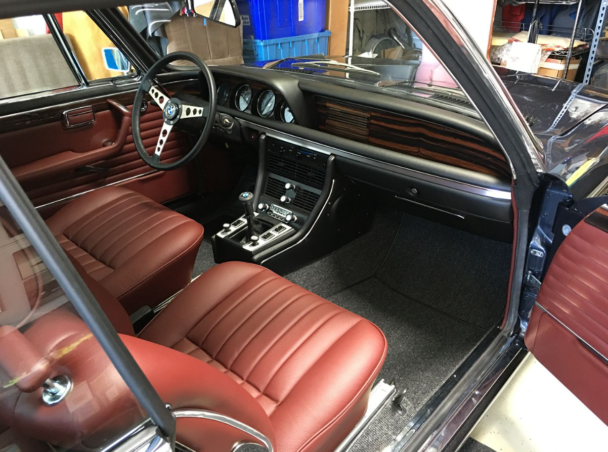

While waiting on the larger samples, I’ve gone down the rabbit hole - forum threads, BaT listings (which tend to have great photos), anything I could find for real-world examples. There aren’t a ton of square weave installs out there, but I did come across a few.
One that stood out was a thread from @OCCoupe - it looks like he may have used 316 Dark Grey (I’m going to send him a PM to confirm).
His car has a red interior, but I used AI to swap it to A-2873 Ferrari Tan just to get a better sense of the combination.
Here’s how that looks:
I would definitely not go tan. Too much with the seats, and if the match isn’t perfect it will clash. Also hard to keep clean
