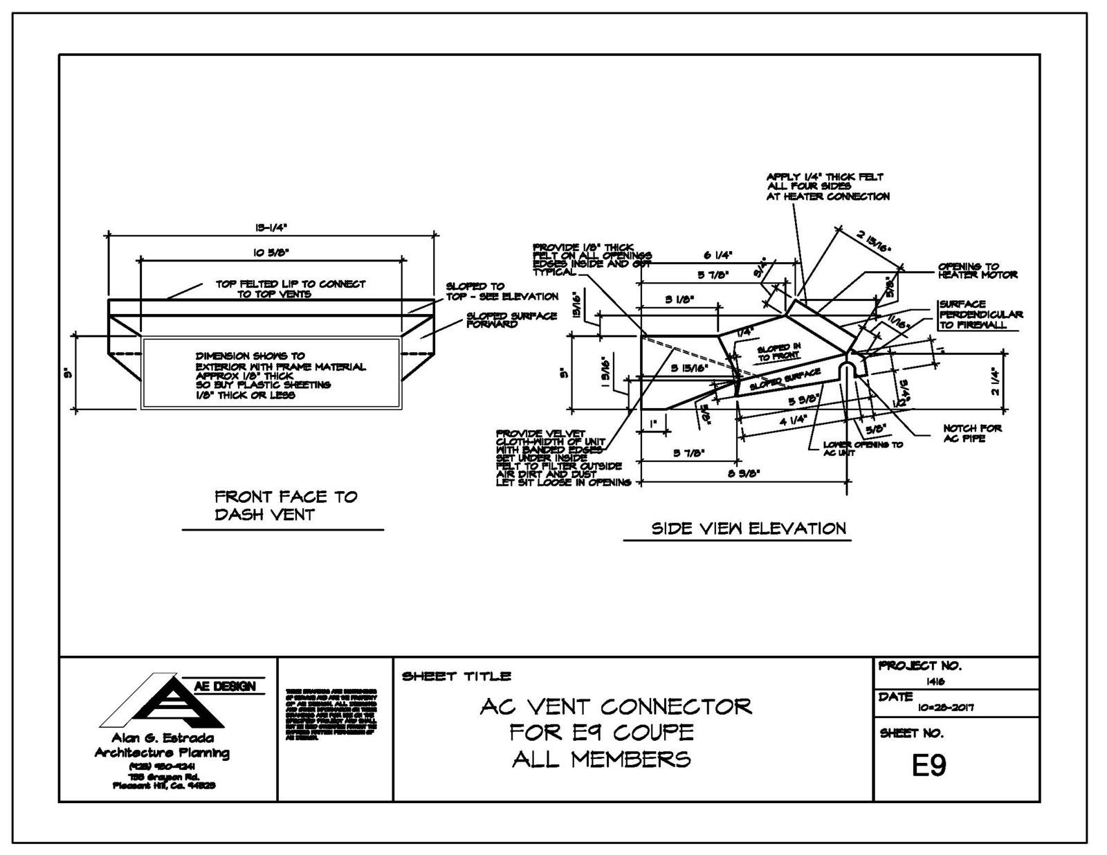

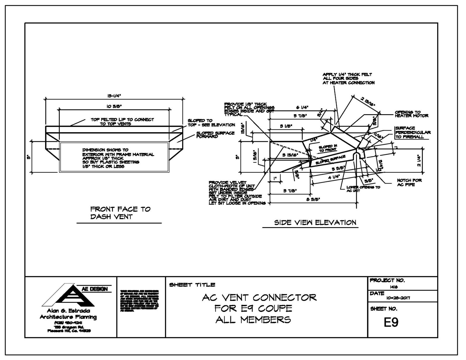

Try a search, "intermediate piece". A lot will pop up. One member," aearch", has created a CAD file of this piece, and in 2017, another member was going to try to create this part from the diagram, and perhaps more than one. See what you can find. Good luck!
HERE
