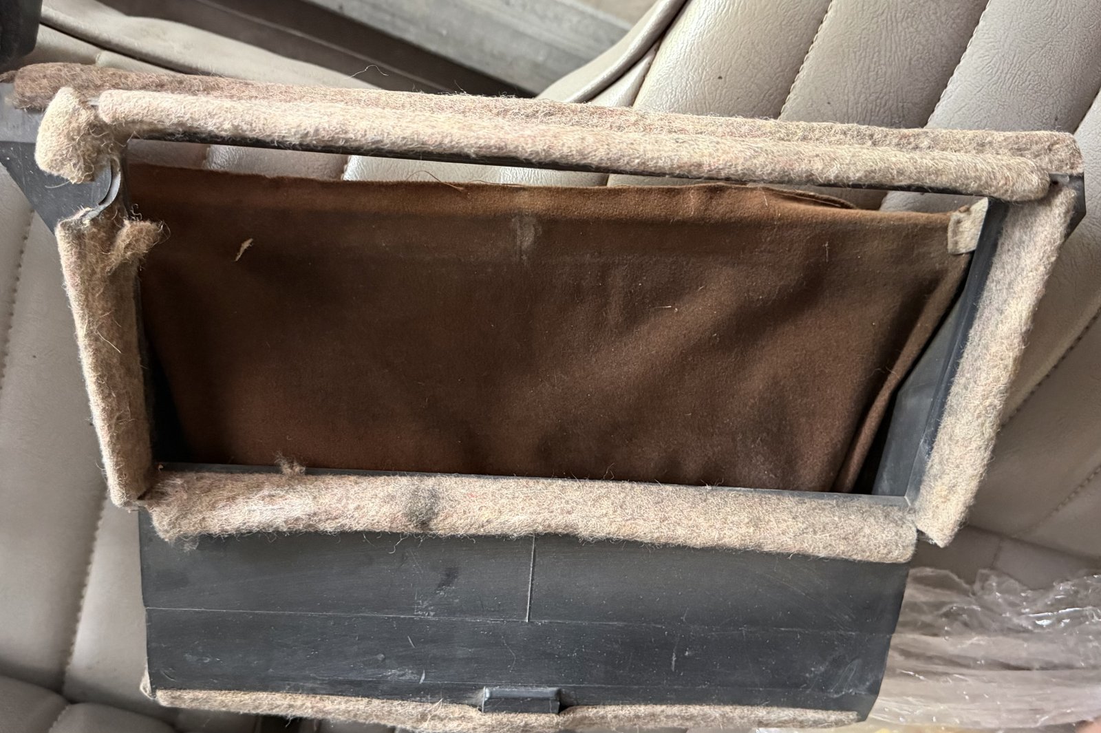

It has been brought to my attention that this part is possibly in demand.
Would there be any interest if we reproduced it? Without the felt :)
If not, I will sell this one, and drop the subject.
Alberto- many are melted or broken/cracked so there is a need.
We do have a forum member who is 3D printing this currently and they are high quality.
Xatlas

Today, we started making the initial mould.

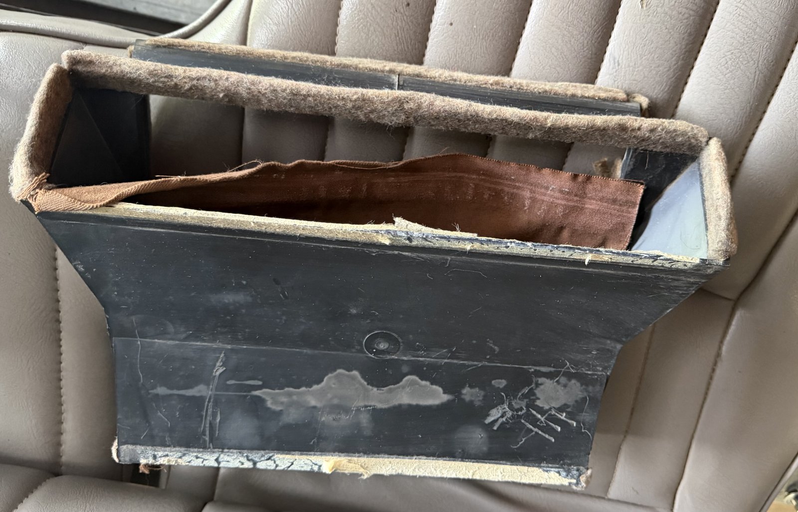

I am impressed about the cloth inside. A filtering agent? To me, more of a germ trap ...
So the cloth you see in my photo, reddish hue, is a ... whatever got in there? Somehow?
Therefore does not belong there?
Correction: Had not read @sfdon explanation, so it belongs there. Very FARMALL type of solution :)
I'm pretty sure the felt was black when it was new but the dye has faded with exposure to ozone and time. It is 50+ years old and hasn't been stored inside. This material will dampen some of the fan noise while the heat/ac is running. Not a trivial consideration.

Still, an impressive HVAC solution, if not rather pedestrian. :)

Getting back to the starting post :)
Intermediate section for ventilation - A/C​
Today we started pulling the mould. It is very basic, one section is just the flat top part and the rest is the box with 2 sides, et al.
it will be 100% exactly as sample, no need to change or improve. Rock solid.
Ought to have it done by end of next week. And, yes Toto, it really takes 40+ hours to make a mould (ready to use) as this. :)
As always, a bulletproof assembly that will outlast the car, just as the rest of the items we make. The cloth and felt, will be the 'coopistas' choice.
