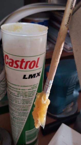

in case you do not find the molykote
this has worked for me for more than 10 years
general mechanisms, window rails, and so on
