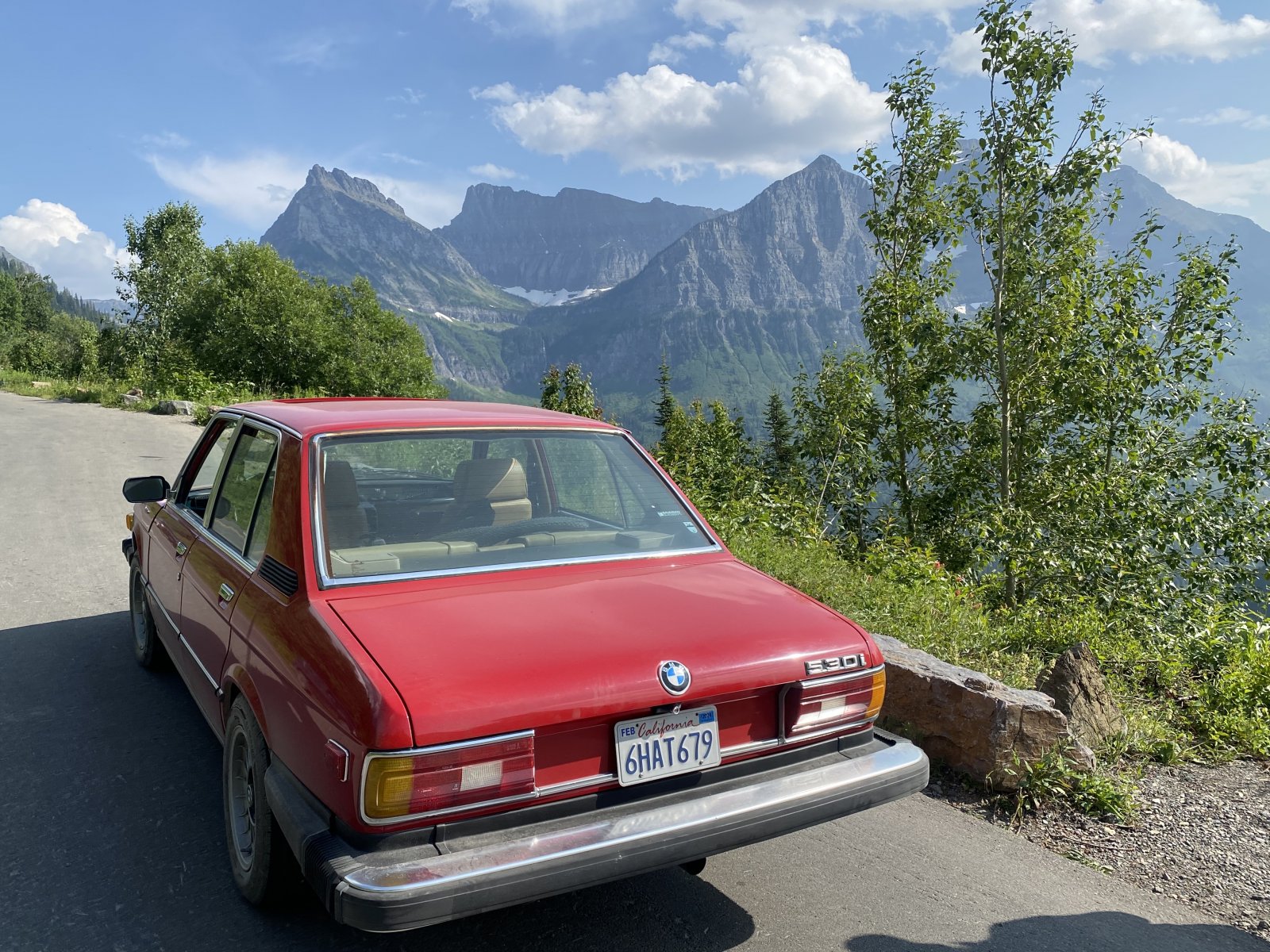

I thought I’d follow up on this a bit, since I have the car home now. Just before Memorial Day weekend I flew to SFO, picked up the car in the east Bay, and took two days to drive it up the PCH/101 to Portland and then I-5 to Bellingham, WA, where I left the car with friends. Weekend before last, my sweetie and I flew back to Bellingham and drove the car home via a trip to Glacier National Park, which we’d both wanted to visit. We took the North Cascades Highway (US20) across Washington, up to Sandpoint, ID and back down and then up to the Lake McDonald Lodge on the west side of Glacier. Then over to the Many Glaciers Lodge on the east side. Then two-lane highways across Montana to South Dakota, visits to Little Big Horn and Mt Rushmore and embracing the cheesiness that SD has to offer (Wall Drug, the Corn Palace) and lots of I-90 home from there. It was a great drive. The car is a great highway car that loves sitting at 80-90 for as long as you like, and the E21 Recaros are my favorite seats ever. Only complaint is that no cruise and a stiff throttle return spring means leg cramps after an hour.
