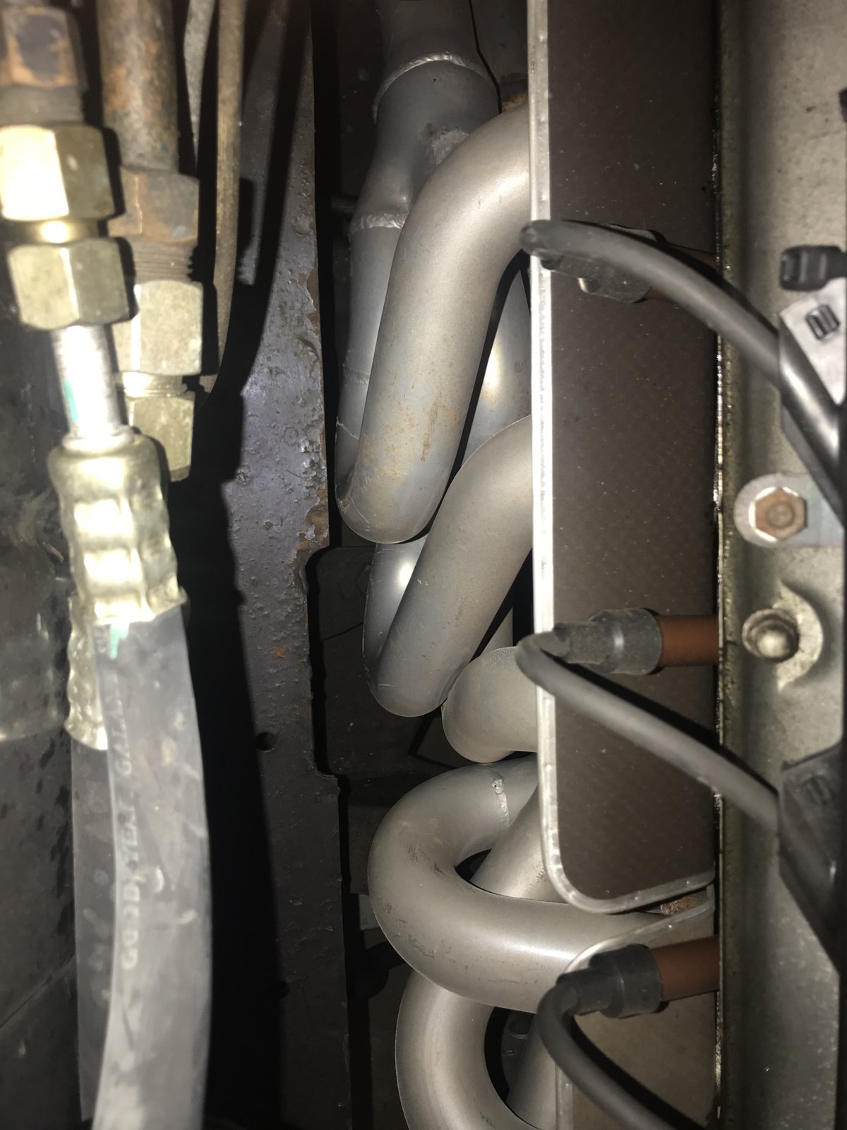

I’m 99% sure I have the IE headers and no mods were required to the frame rail.

depends on the diameter of the primaries i think…. the Schnitzers have only a short tube to equal the outlet ports and directly go greater in diameter for the bends.....

Although yours fit without mod, you don't seem to have much space, and it's possible that another set from the same manufacturer would require a little modification.
There were two variations of the IE headers. The second iteration wrapped in a little closer and would clear the frame rail more often then not.
FYI, Schmeidmann bought an IE header and sent it to China. I was working for Jeff at the time and took the order. I have seen a number of the China/Schmeidman's vary quite a bit, but the IE headers are all (except for the M20 shorty) jig -welded in Pasadena.
