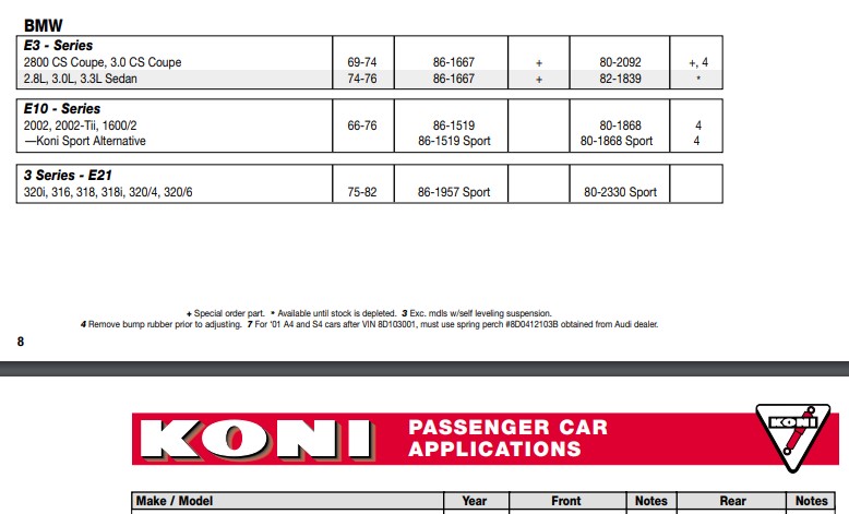

@Mot27cars 27 shared a link to an old Koni fitment guide Picture provided below
@Dave G Shared the following in July of 2020: "Ground Control uses Koni inserts in their kits. You might inquire as to what they can get for you. The great guys at LaJolla Independent BMW recommended them to me and indicated that they have a good balance of street comfort and handling with their adjustable height coil-over suspension set that I was interested in." Ground Control E9 Coilover Set
I have seen comments indicating that Bilstein HD's are softer than the sport's, but don't have any personal experience.
