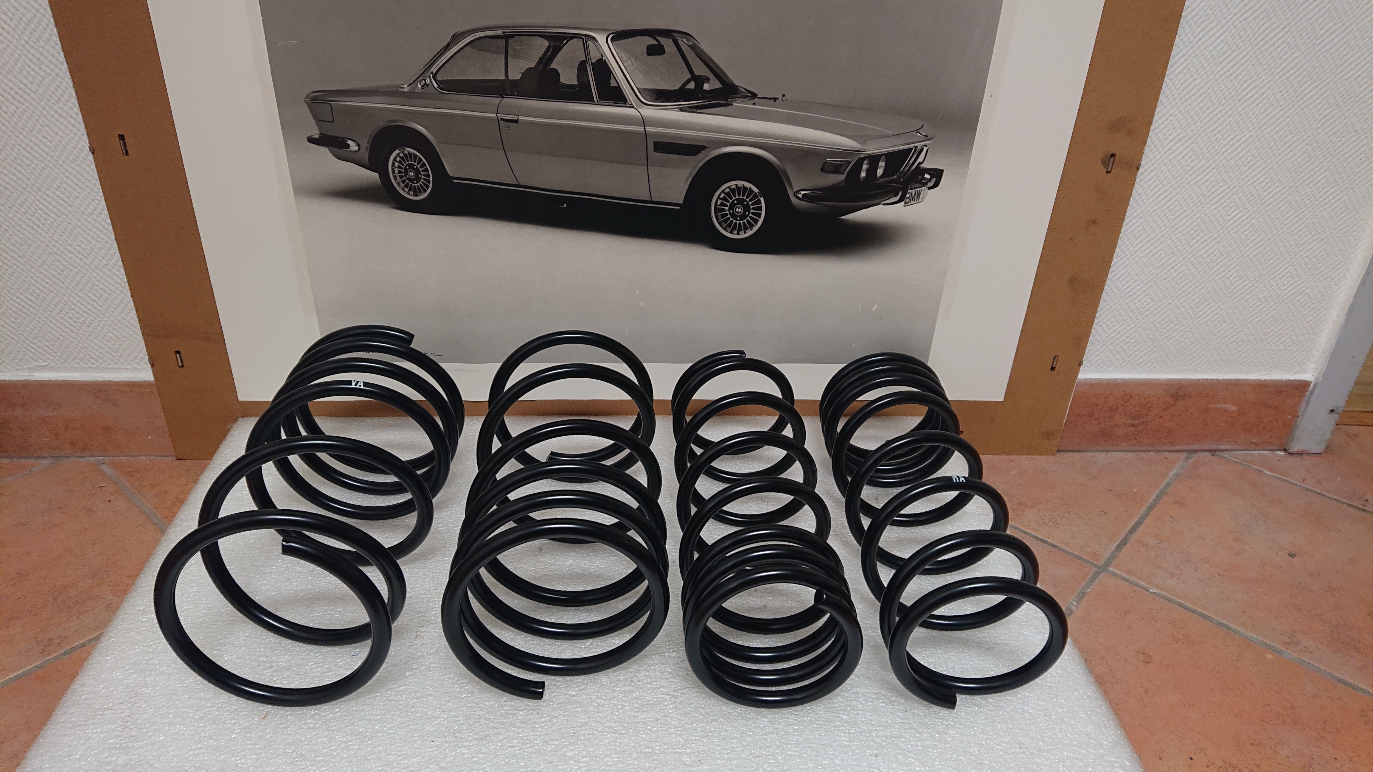

Is it possible to have my lowering springs and neg camber plates with shocks other than Bilstein?
In speaking with Carl years ago, he said "I can count on one hand how many springs I have seen that were worn out and still have 5 fingers". I was looking for a set for my E3 thinking they were an issue and that is what he said.

I just put H&R progressives with Spax adjustable shocks on. SO much better than screwing with the bilstein and they are fully adjustable .Single adjustable, the adjuster varies both the rebound and bump circuits, simultaneously, on a fixed ratio, 3:1 Rebound:Bump. Love them so far. Don't have a ton of miles but did one big spirited drive with them and so much better than the bilstein. I'm also running fixed camber plates on the front. No issues.
We tried them..... the noise was intense on the freeway. We installed split fuel line to stop the binding noise.
Don - we discussed. Once I put some lube on the top coils and put some miles, they got smooth. I think the paint binds at first. It was bad in the beginning though.
