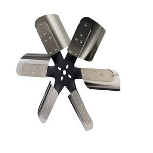

In the quest to reduce rotating mass on an M10 clutch-less fan, one could delete the fan in favor of an electric version or modify the fan. I believe I still have a twin-blade fan from a 1600 as well as a few that were cut down. Another alternative was to run a flexalite fan or similar that flattens out at high speed and reduces drag. But it is still additional rotating mass. (Another downside to fiberglass fans of yesteryear was their tendency to become brittle and fragile. The metal flex fans are heavier than the BMW plastic equivalent.) Nevertheless, I have seen a flexalite fan or similar adapted to an E3 and it probably worked as well if not slightly better than a permanently engaged fan clutch. I never knew or questioned the reason for its installation.
