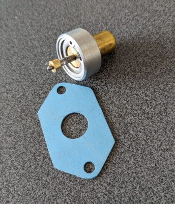

My AAV valve on csi seems to open and close very slowly and , I don’t think it closes fully either.
I have seen a part listing on eBay for the thermostat “bulb” but I am not sure if it would work on a CSi AAV
It describes itself as a jaguar part.
Has anyone succeeded in finding the part and swapping it out ?
And if so where can it be bought ?
Thanks.

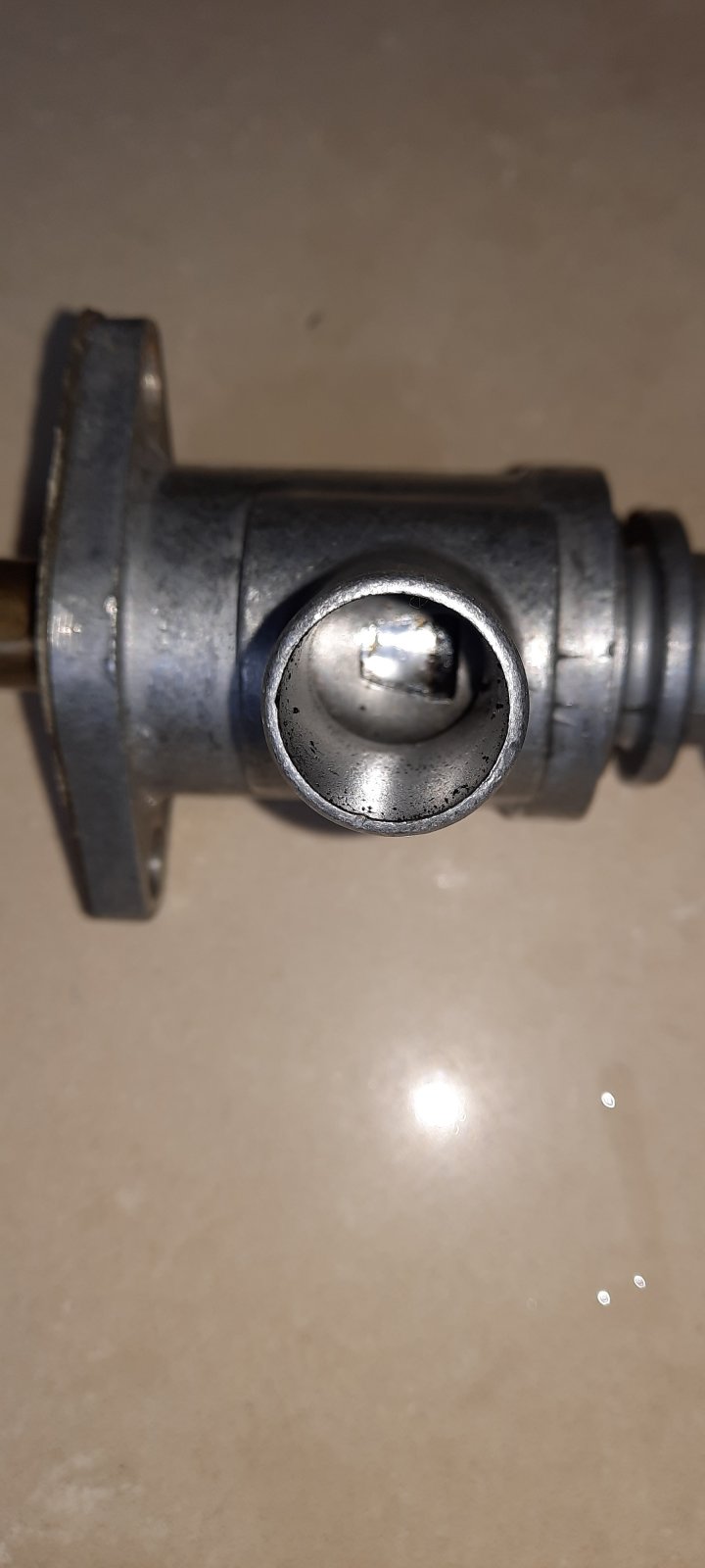

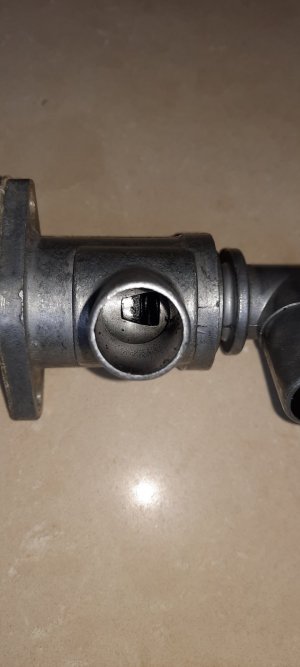

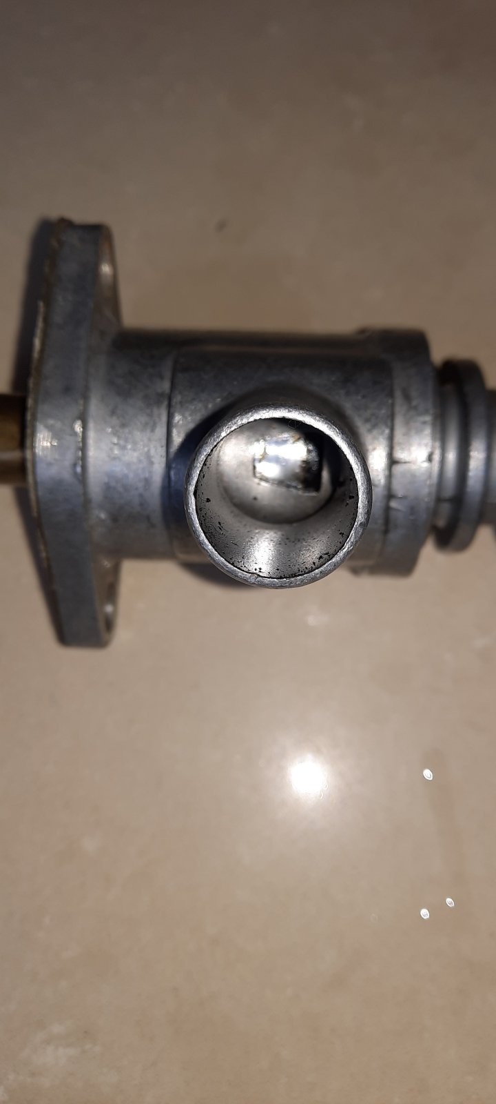

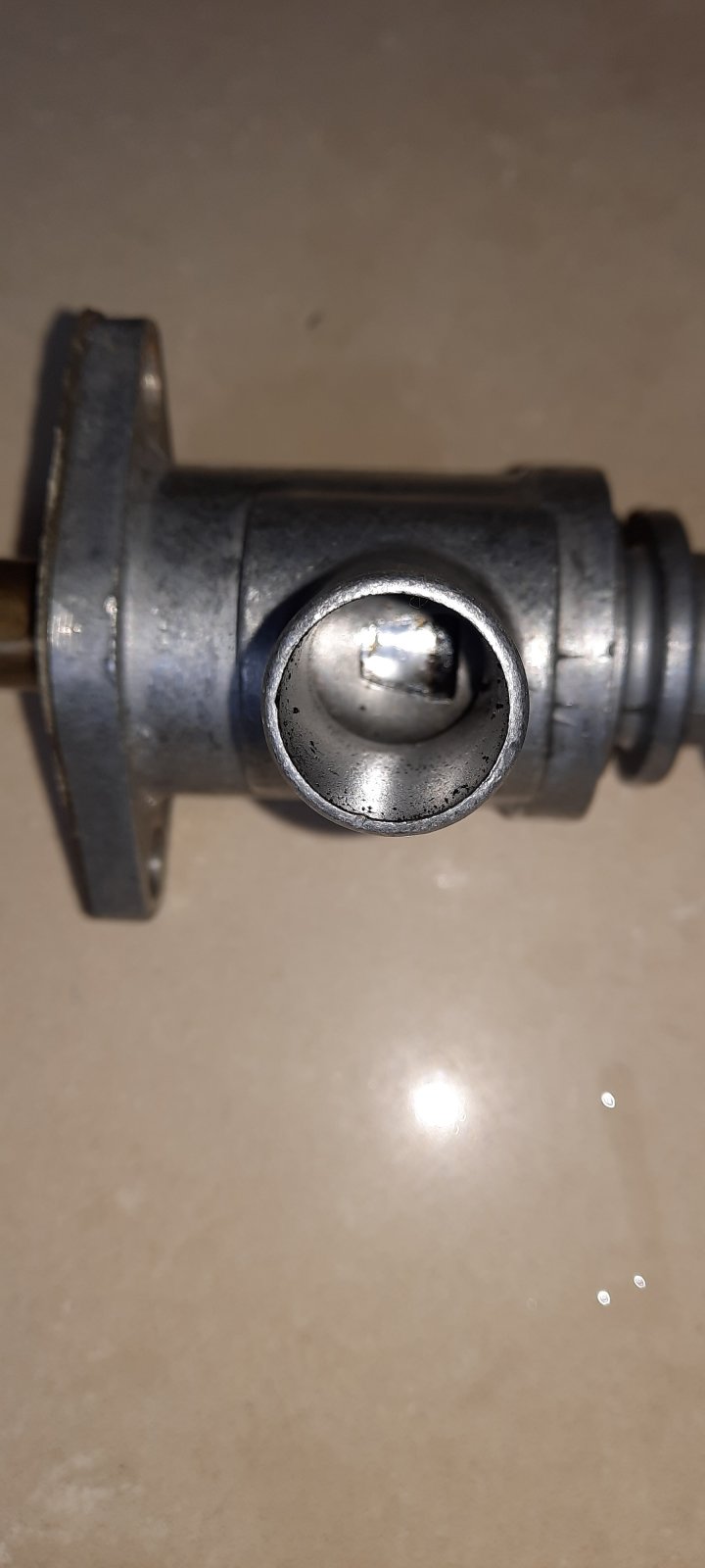

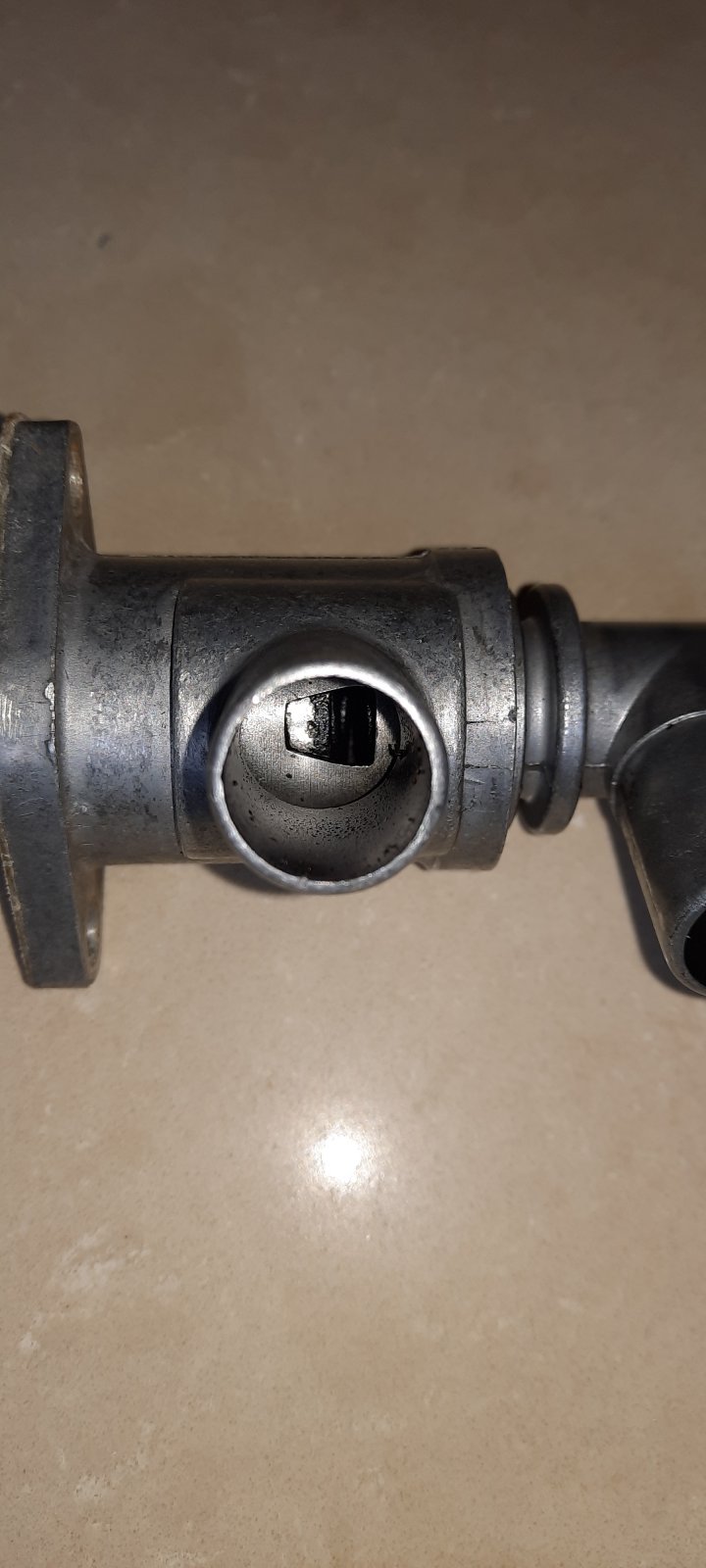

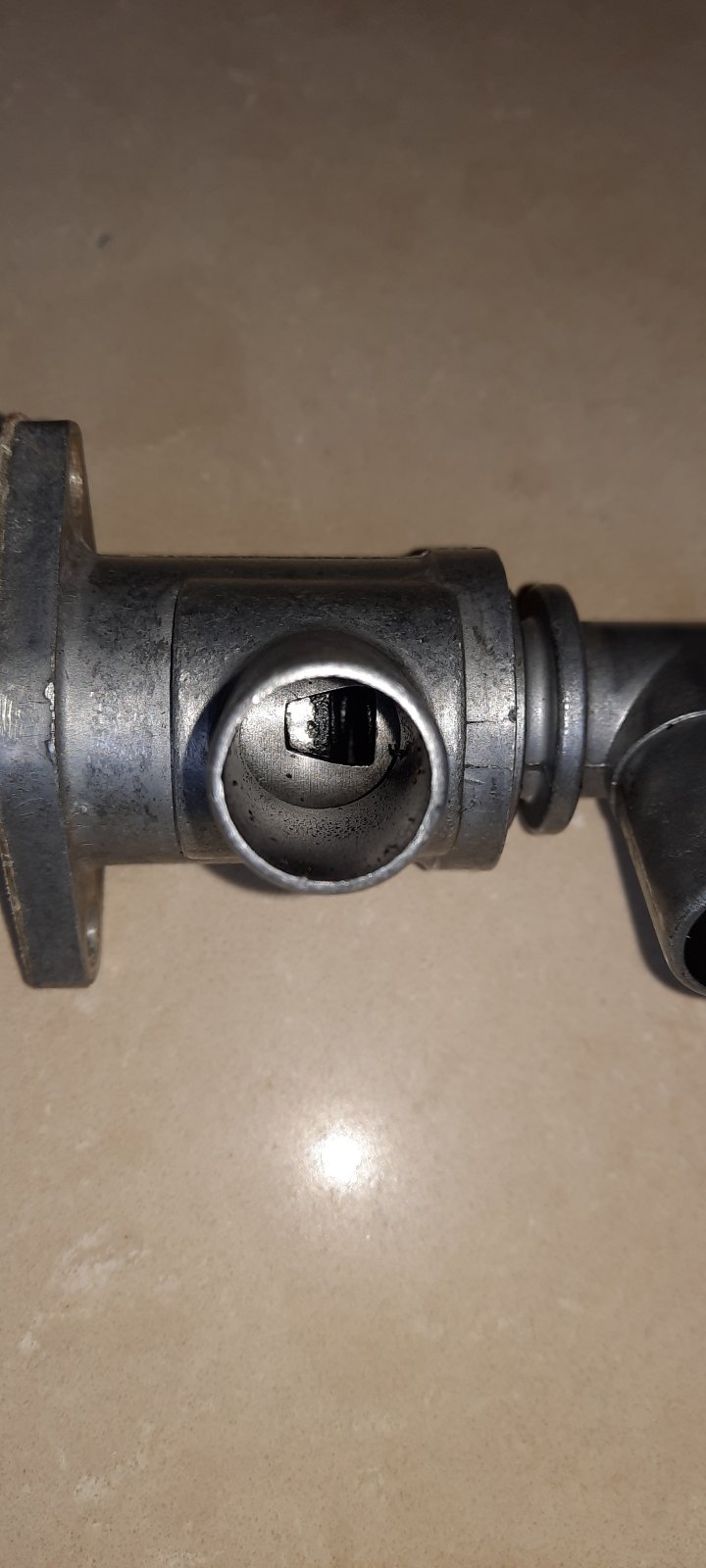

Hi Barry,
So I did the same procedure just now.
Pic on the right: room temperature, piston about 50% retracted
Pic on the left: after putting it in hot water, piston in close position <1mm gap.
ZLS is in the fridge now! Will send a pic of the piston position after some time.
.....same as second pic....

Hi Barry,
View attachment 178151View attachment 178152
