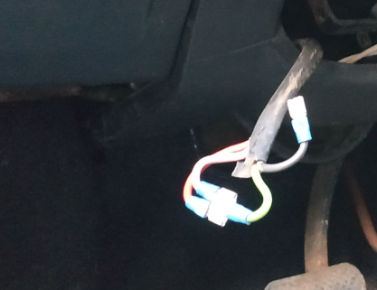

For the record- if your ignition switch has female spades going to the fuse box- pull the red wire and the green wire that go to the ignition switch off the back of the fuse box. Use the double female jumper on those connectors to bypass your ignition switch. Use the black wire to jump the starter.

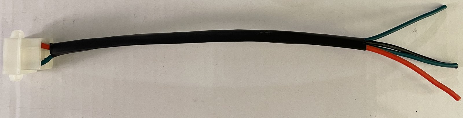

Since all of these connections (+12v, Starter Solenoid, and +Coil) are available at the orange-capped 9 pin connector on the driver side fender, couldn't I make up a device with a male 9 pin plug that I could plug into the port and accomplish this easily and cleanly without accessing the fuse box? Sort of like the device sold by a member of the 2002FAQ?
Yes you can, I think it is described in the Blue Books as well.

Ok I've figured out the wiring for a "black box" to plug into the diagnostic port to start and drive the car in the event of an ignition switch failure (no key needed other than to unlock the steering wheel), this would have come in handy for @DWMBMW in Hilton head at LOTA instead of us tearing into his steering column in the parking lot. That scenario put doing this into my head ever since and the broken/failing switch topic seems to come up here pretty often. This weekend I will be assembling a small box with fuse, dash lights/ignition coil lighted power switch (with nuclear bomb safety cover), and push starter button, shall I post this or is it a security risk? My car has both a hidden kill switch and a 123 distributor with bluetooth disable but I understand if the Moderators don't want it out there because it makes "Gone in 60 seconds" slower by 45. I could always PM pics and parts sources to known members if they are interested in building their own. It's very simple and can also be used as an underhood starter while using the key as usual if so desired. It will be kept hidden in my car at all times for when I least expect to need it. Here's the part that plugs into the port in the engine compartment:
