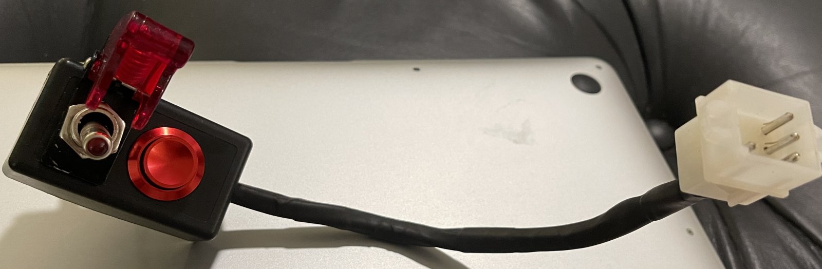

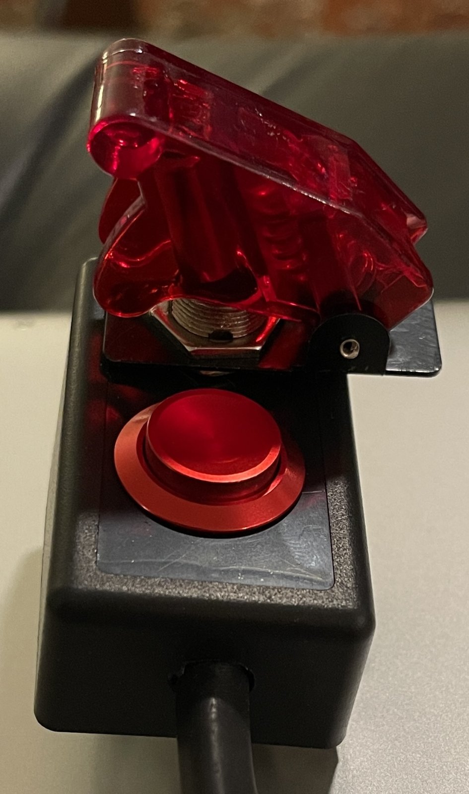

I know you all have been waiting all weekend for this so I will oblige. 1st prototype, I’ll need to source a slightly larger box as it is just 2 mm not deep enough and I need more wire. Version 2.0 next. The LED on the toggle lights up to indicate fire in the hole. Coming along.

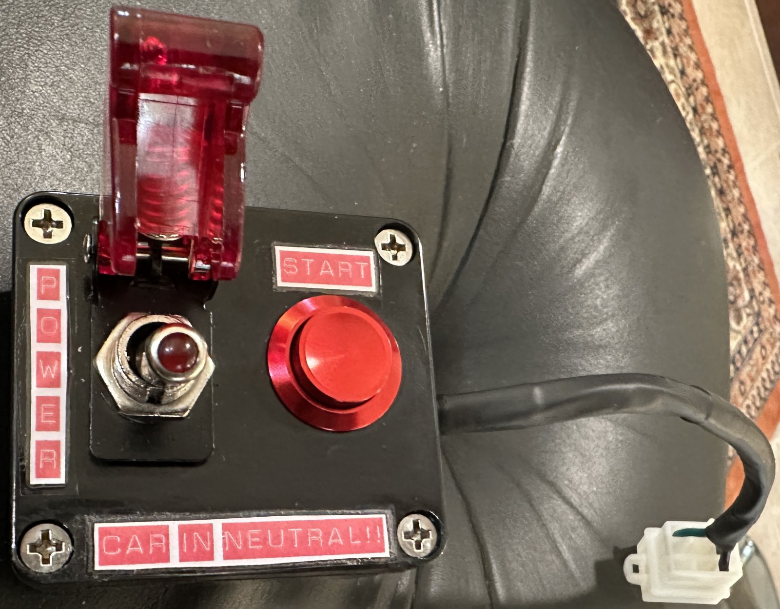

Version 2.0 complete and as a bonus, works as intended! The neutral warning comes from an unfortunate experience when I once had the car in reverse, leaned through the window to start, it did and lurched out of the garage with me still attached. How about that screw alignment @zinz ?? :cool:
Will it still crank with the power off?
It’s designed to get me home in the event of a fried/broken ignition switch. When powered on, the dash lights up as if you’ve turned the key to the run position. And obviously it can be used as a remote starter when fiddling with ignition etc. With power switch off it won’t crank.
