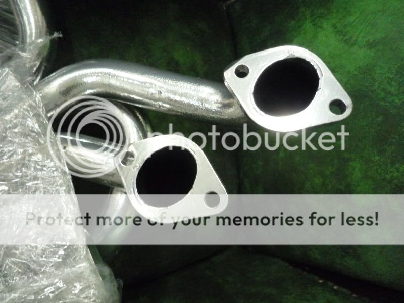

is this a stahl header?
ANyone just buy them? They look the same as mine and Pamps.
Stahl Headers
All of the Stahls I have had or seen do not have individual header flanges like the one on EBay.

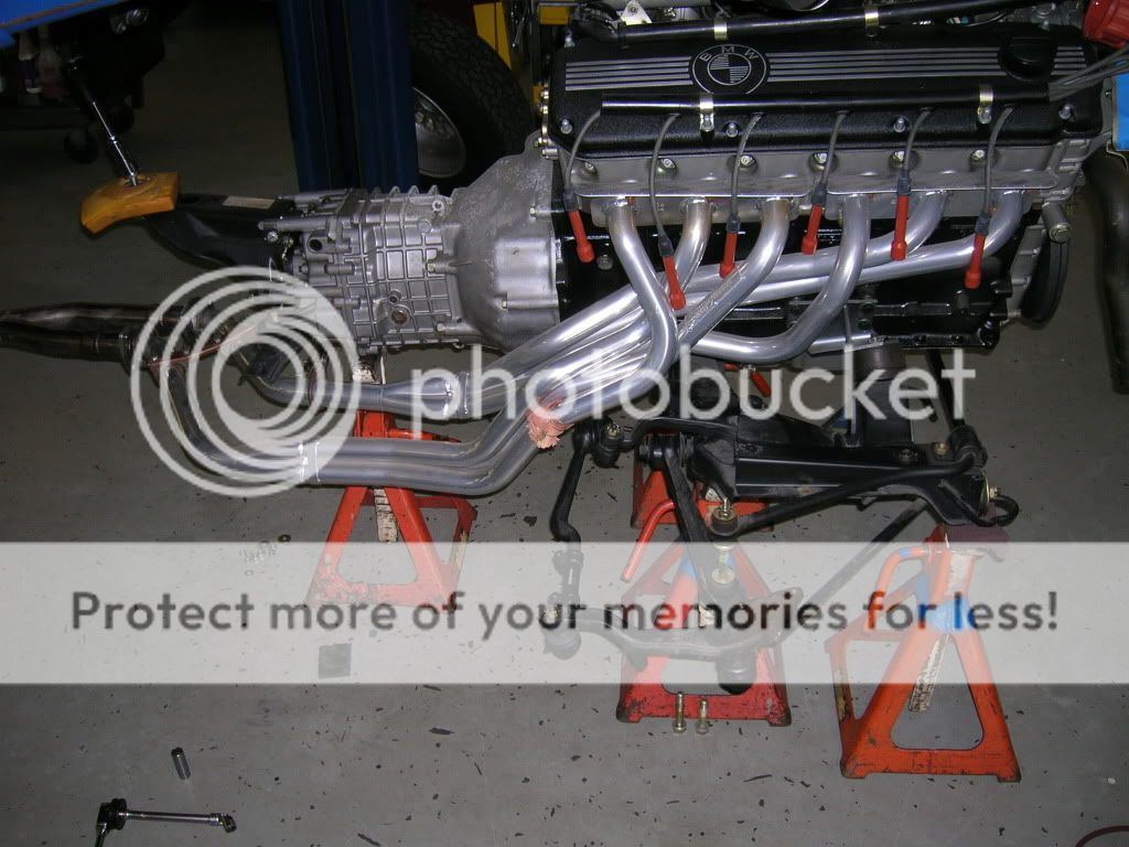

What's with the run on getting headers? Have you done intake/engine work also?
When I was looking for headers last summer for my E28, I was told that Stahl was not making them anymore which also meant that Bavauto was going to stop selling them when their stock ran out which it has. I got lucky and found a set of used ones.
To my knowledge, the only folks selling/making headers now for the M30 are Ireland, Motorsports Downunder (which look great) and Scheissman (I may not have that last one right). There have also been some cheapies pop up on Ebay.

Korman bought the last of the assembled Stahl stock. All the jigs and kits can still be had from Stahl. Last I heard were that all the jigs were still for sale (Stahl) Opportunity if some one wanted to carry on and build these. All the NOS as well as other suppliers are big bucks. The market is small. I guess the deal is that, speaking for myself, coupe guys love to experiment. If the price is right, why not? The CoupeKing....well.... deep pockets required to play there. These odd sets that myself and my brother in Toronto have....1 3/8'' tube size which is OK for a stock motor (according to Korman) 3.0, 3.3, 3.5. Same as the inlet side of the cast B35 manifold. Bigger, say 1 1/2'', and yes....cam, head work, etc. would be needed. Lets see how it goes...once the pipes hit the floor. I have stock down pipe scraps, 35 spec. manifolds, etc. Once I can compare I will dutifully report.
OK
At the risk of talking out my ass....never stopped me before so....the pipes arrived. Measure shows 1 1/2'' pipe to a three into one merge....1 3/4'' then down to a two into one....out at 2 1/4. Flanges match the OEM gasket, some minor port matching looks in order. Cast 35 manifolds are about the same....outlet 1 3/4'' and down pipes same. Hmmm....
Too much for the 3.3? These pipes have also been coated....substance unknown. All comments are more than welcome. Could be another e-bay deal gone wrong, not the first time. Bolt them up and see I guess.

Others more knowledgeable than me need to weigh on on this topic, but I went through this with my M30 powered E28. In addition to extensive motor work, I also made the decision to go with headers though some (here) counseled me not to.
My impression after the first drive following the install was that I lost low end torque, at least enough to notice. This was from a motor that had extensive head work and was breathing much better. I also had to do some additional tuning to get the fuel mixtures right which restored most (not all) of the lost torque. Change one thing...
Sounds really cool though :-D
My hindsight advice is to have an overall plan and approach fully vetted for what you want to do with various mods, intake, fuel, exhaust, etc. and understand what effect one change will have on another. You can install in stages as your budget/wife allows but its more important that upgrades properly complement each other and will actually work together.
And there is a ton of knowledge on this board about this topic so ask lots of questions!

Had to work pretty hard this morning as to remove the merge from one leg of the headers....seized hard....worried the wife when she came to check on me in the shop filled with smoke! To quote Rummy, here is the known unknown....Does Stahl measure the tube diameter I.D. or O.D.? Seems a bit anal....WTF....1/8'' yet could it make a radical difference?
If they measure I.D. (1 1/2'') then, Nicad we are good to go. These pipes measure at 1 3/8'' I.D. If they go O.D. in their measure? Hmmm.... Stahl install on the floor at Kormans

The insides of the Mystery headers are now coated with some heat retaining inner coating.
When I measured them up (which was difficult because they are Oval at the flange) I got about 1.24 to 1.38 inches on the inside. The outside circumference was 1.6 inches. Mine will be breathing through a stock exhaust from the header back for now, at least till it is worn out. The price of the CoupeKing exhaust is a bit steep for me to justify. I also would prefer to keep an original style rear muffler and muted sound. I found the car quite quiet with these headers and stock exhaust in my limited seat time.
