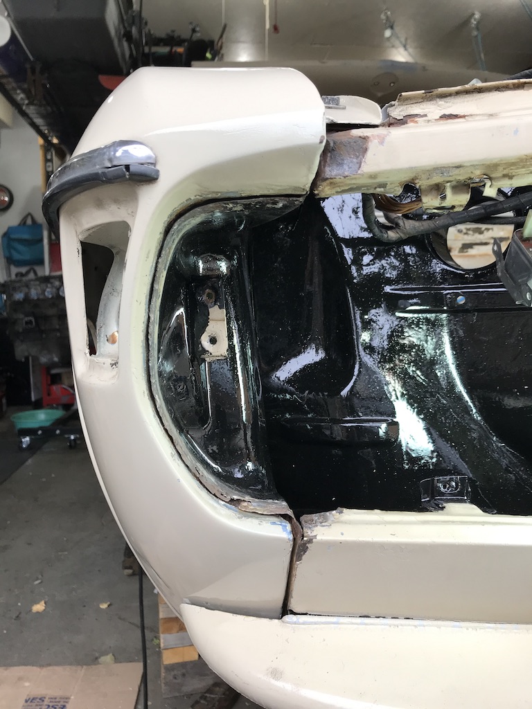

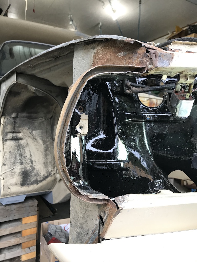

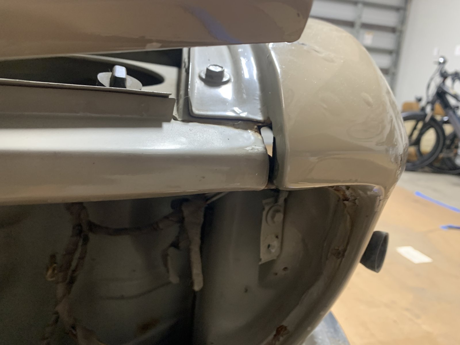

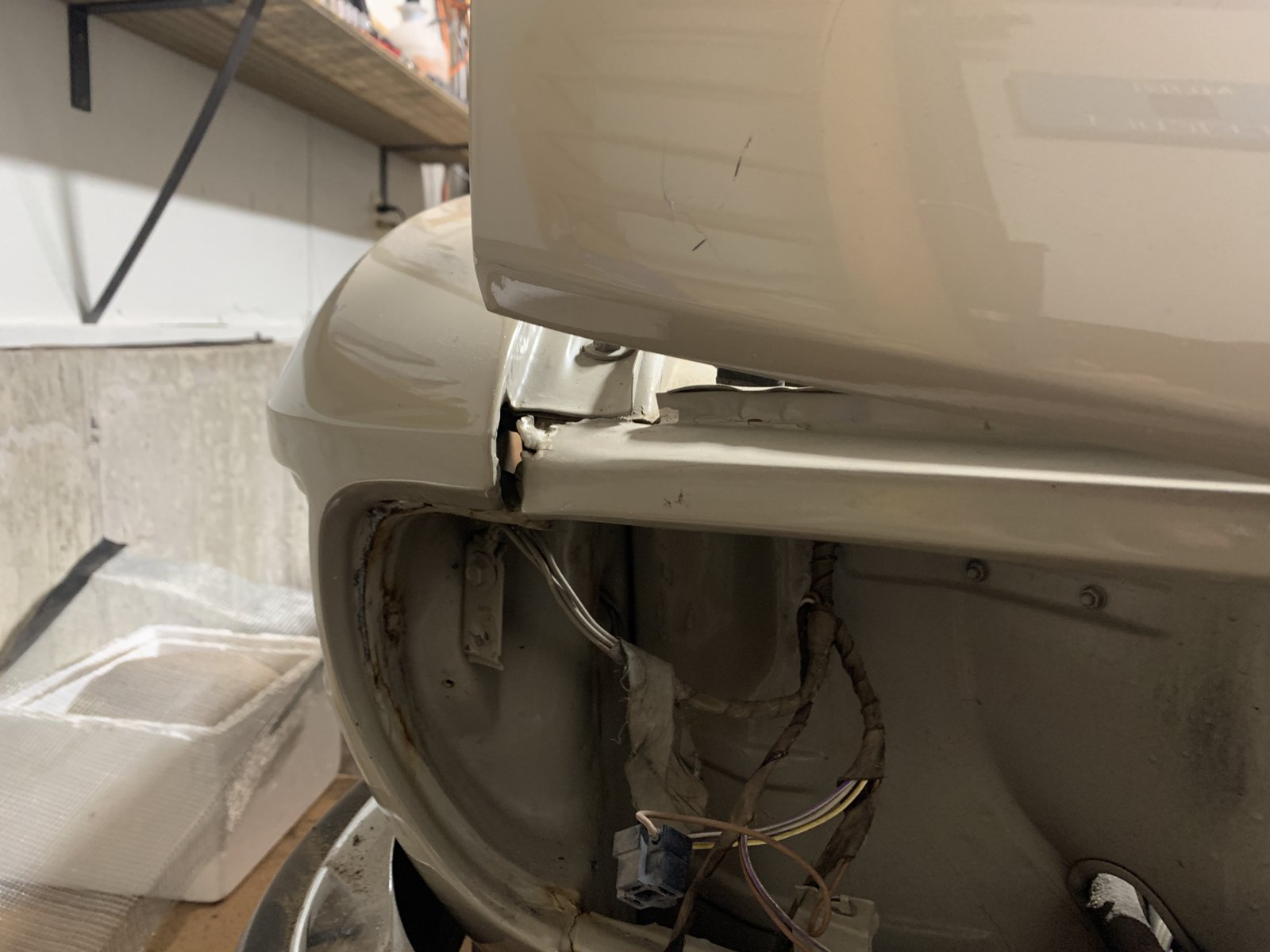

Is this how it is suposed to be?? Same on both sides.

Hi

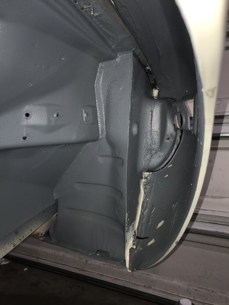

Looks like the sealing material let loose. No lead filler on those so could pull and reseal. I used a tan coloured sealer for mine and didn't worry about paint to match because its behind the grill. I used Wurth's rust converter and antirust black coating before sealing and assembly.

I just don't drive in the rain!. Seriously, my car is a one owner and well cared for E3. I just cannot believe that gap had any sealer in it in the past.

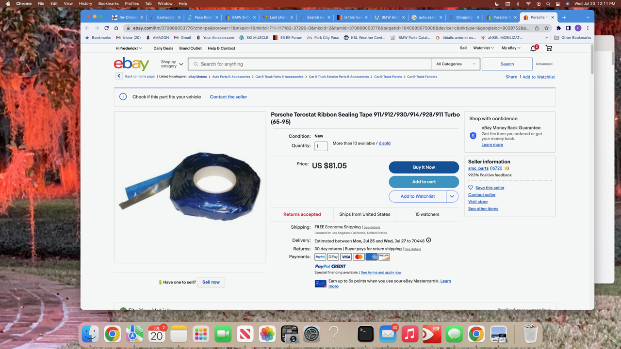

Two questions: What is a "brazed joint" and what is "terostat" ? OH, three questions, Where can I get the "blue book?" I have a CD for my 2002 and only the german version downloaded from W&N, which is not terribly useful.

brazing is another term for body soldering, they used tin in the past, today I guess polyester body fillers are more widely used
I guess "terostat" was the used seal/foam by BMW at the time on the edges between body and fender (seam sealer)

"Terostat" is just a product name. There were and are others that start with "Tero-", undercoating and so on. Terostat is a double-sided self-adhesive tape, usually white or black, a bit like chewing gum. Stays elastic for very long and does not absorb water or other liquids. "Sealing tape" should be the term.
