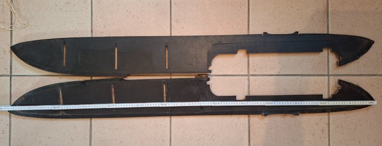

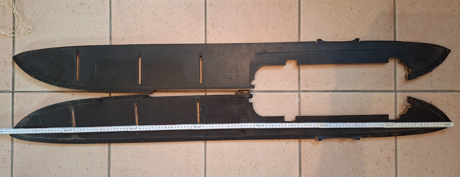

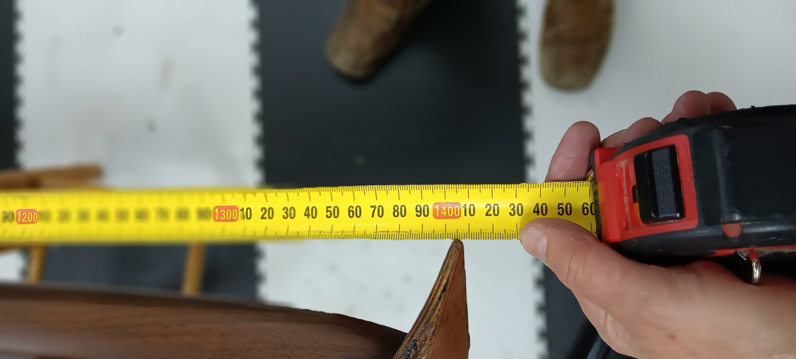

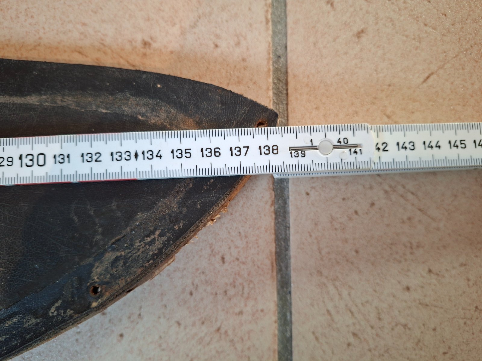

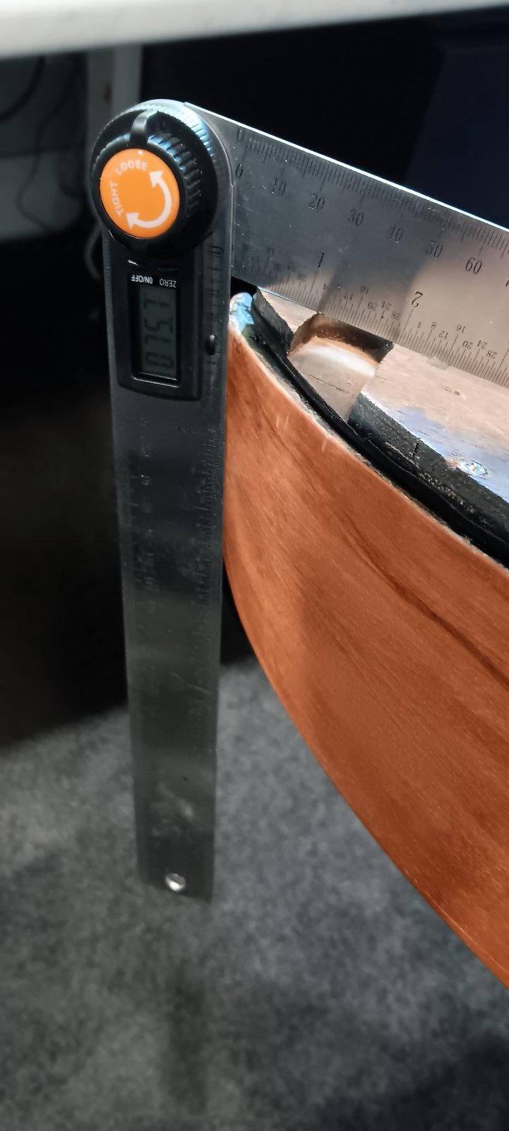

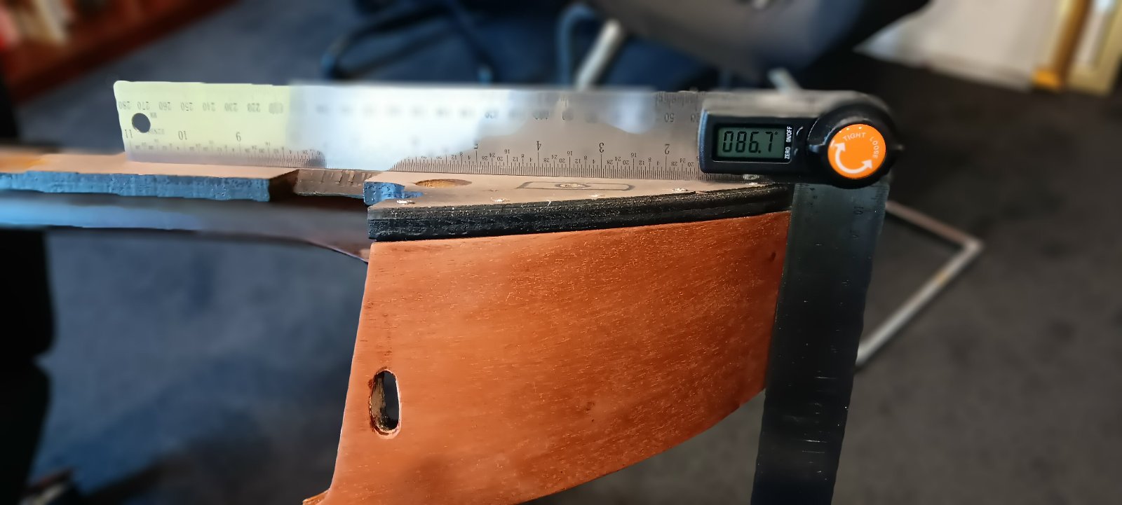

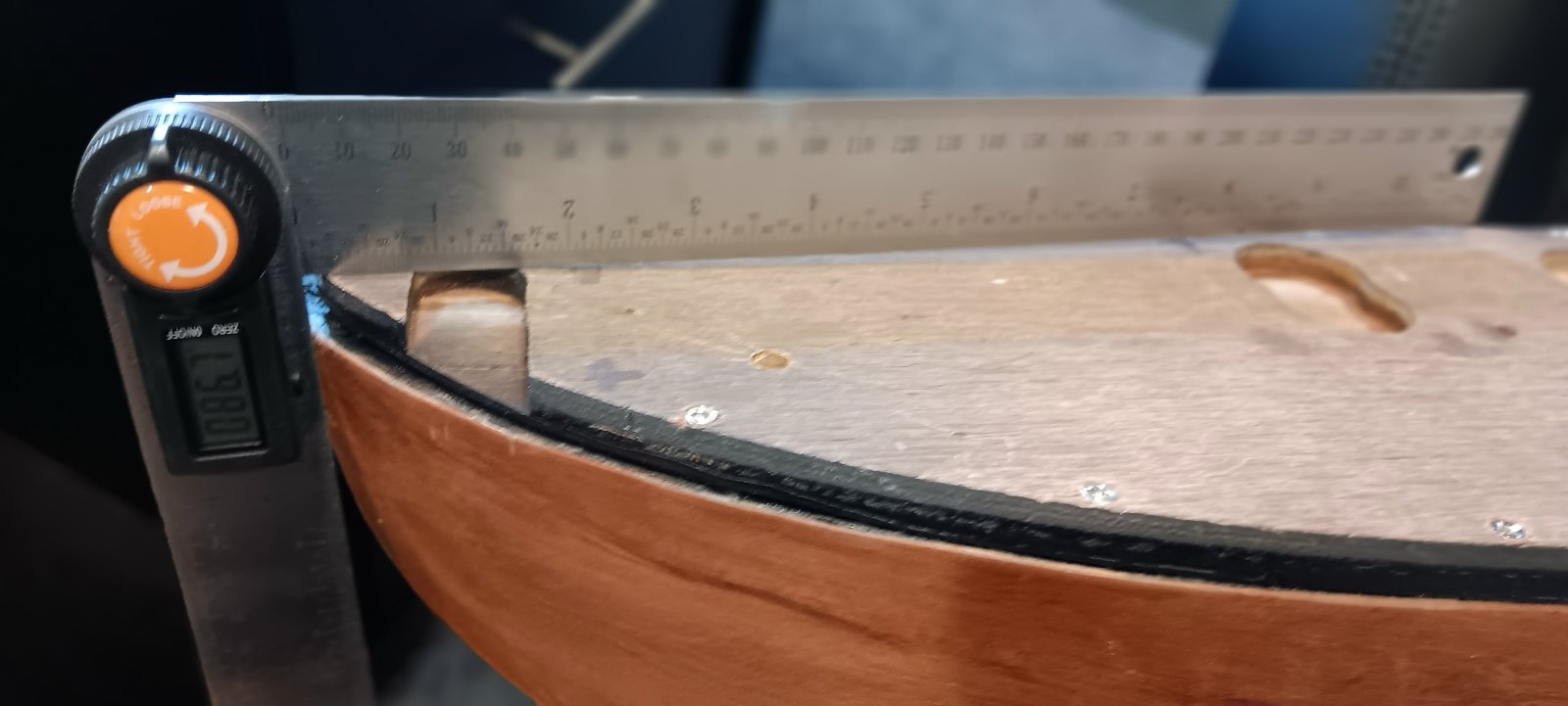

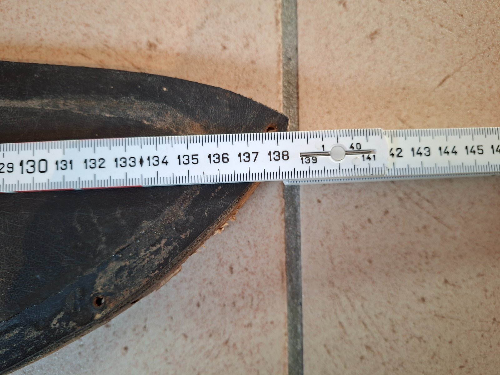

Hi Tom, You seem to have a great deal of experience in this are. I am based in Sydney (AU) and am restoring my 1973 3.0CS (2232124). It started life in Zurich and was privately imported to AU on the early 80s and converted to RHD. I have had the dash sent to a AU company for repair. Their guy was in Poland. The LH vertical wooden piece was water damaged due to a screen leak. The item in question came back and sat on my office floor, inside the house, for three years and I went to fit it yesterday and found that it is too large to sit between the A pillars. To get to the point, the distance between the A pillars is 1370mm and the point to point distance on the dash panel is 1408mm. Do you have a reference measurement you can share? Although all these were 'hand built', the basic body shells will be the same here.
I’ll be in shop tomorrow- or you can ask local with Wes

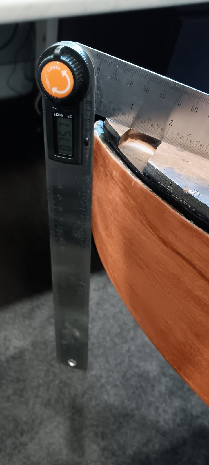

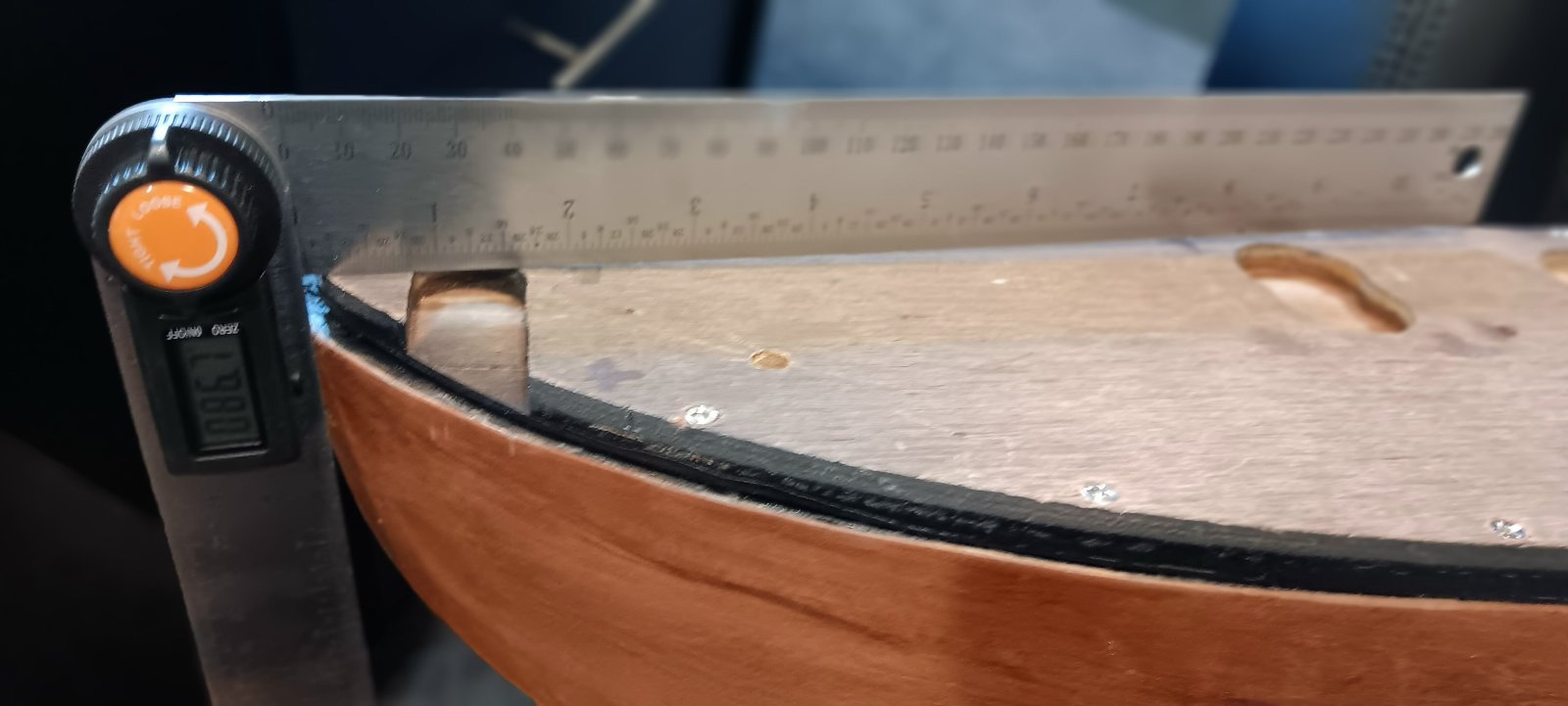

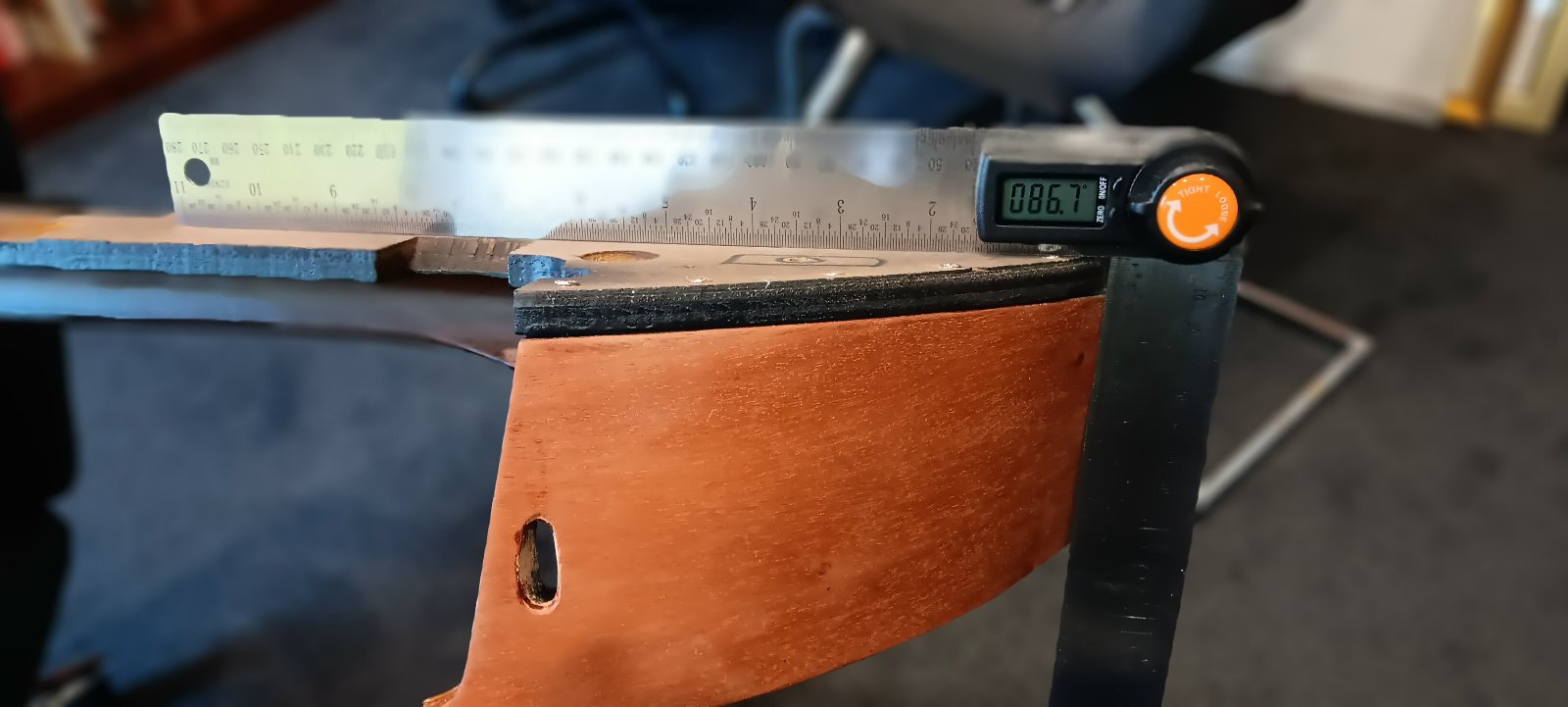

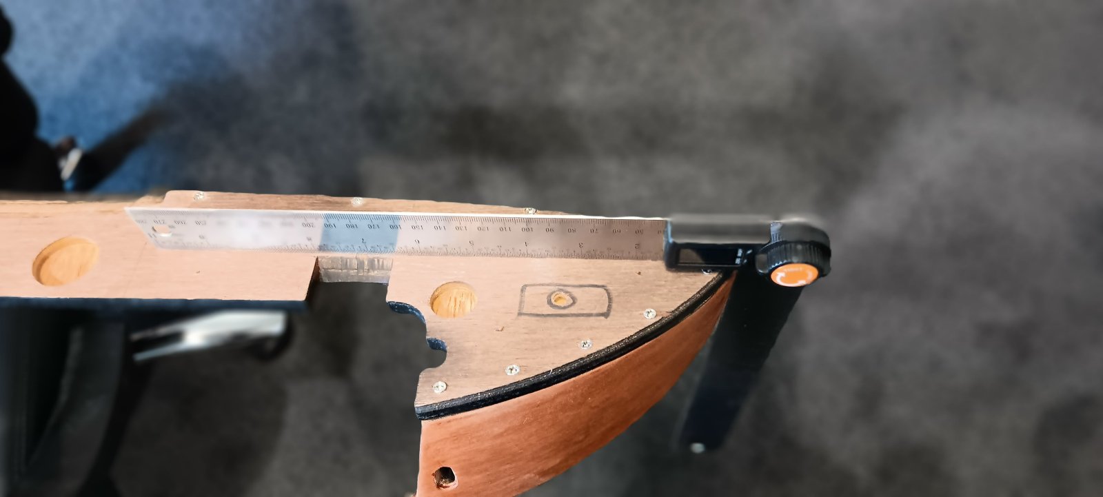

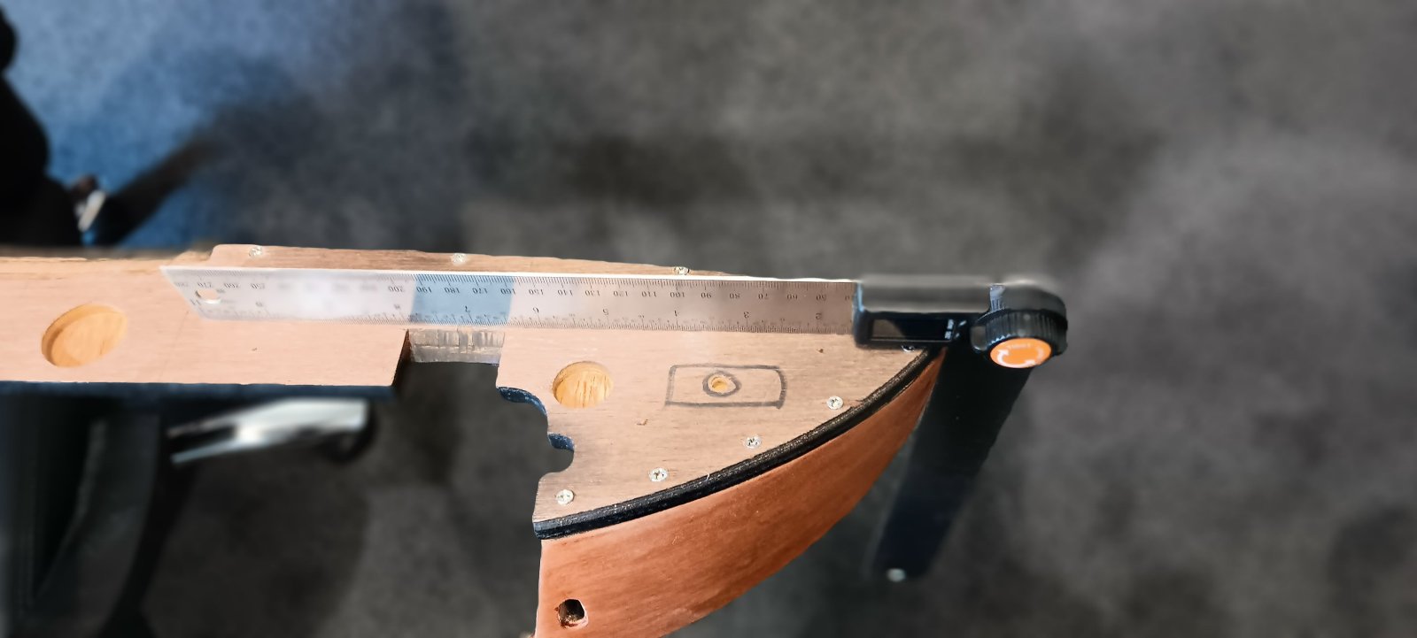

Thanks for the superfast reply. By way of comparison, the base board with should be 1382mm (underside- point to point). The dimensions I have between the A pillar (as clearly defined by the marks / indents on the vinyl is 1370mm, whereas the re-finished dashboard is 1408mm. Then there are the angles between the base board and the vertical section – right is 86.7°, whereas the left is 75.7°. Yes, 11° difference when they should be symmetrical. So any (other) real-world info will be greatly appreciated.
