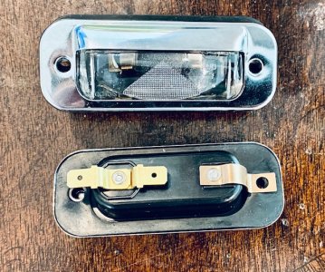

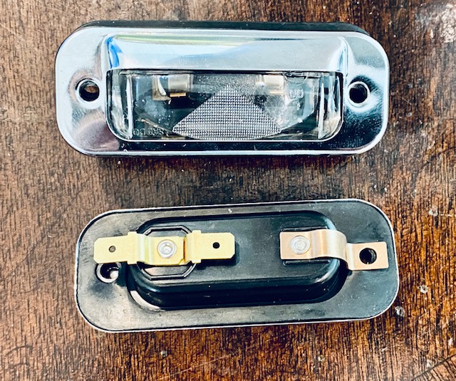

Just purchased the two insert lights to my 1973 e9 rear bumper - several questions
Roman596061
112
38
Hobe Sound, FL
1. What's the proper way for the triangle on the plastic to face?
2. I see that I can run positive and negative connects through a small hole below the left bottom of the license plate.
I presume I can ground to many places but where should I connect the positive connections?

Positive has to be the one not touching the bumper, the other one touches the bumper with the mounting screw. Just the way you see it is how it should look facing the license plate.
