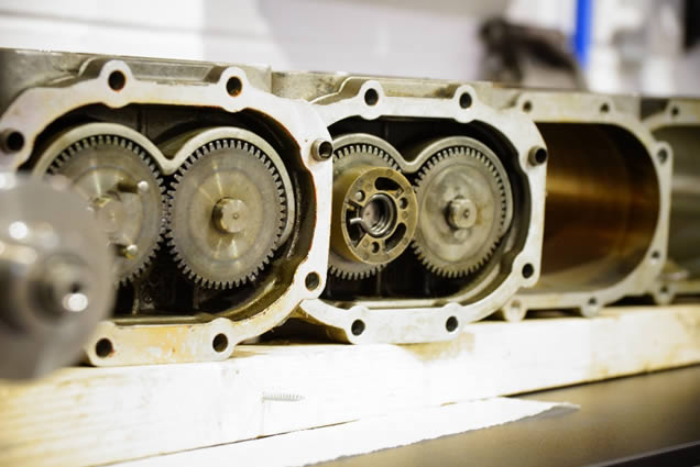

Straight-cut gears are part of why superchargers sound the way they do: (at least usually, I think some of the newer centri-style ones have planetary helical boxes)
