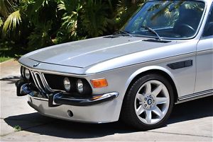

The car from the exterior looks great.
Well, for the most part, yes. But, the front end just looks weird to me. The bumper's rear tips tilt up - not sure if it was hit, or of that's a result of installing that god-awful airdam. And, the car seems raked, with its front end looks lowered / back end raised, kind of like the Kool Kustom Kars we used to build in the 1960's. Adding the rake angle to the crooked bumper makes the thing look even more ungainly. And, I personally dislike the big aftermarket wheels. Picking the nits visible in the photo below, the front bumper rubber is puckered, and the drivers side wiper blade installed at an odd angle. But hey, all of this stuff could be fixed pretty easily.

What I noticed is that it's a big bumper car converted to the earlier bumpers which is fine. But they installed the bumper guards reversed left to right and inverted, making it appear similar to the `73 bumper guards. They are upside down and yes they can be swapped left to right but this is how they will look.

Wheels, airdam, seats and steering wheel completely ruin the car for me. It is a shame to do this to a coupe. I like the color though....

My thoughts are fix the incorrectly mounted bumper overrides and remove the incorrect period parts (wheels, seats and steering wheel) and you have a good looking coupe. CSL style air dam can stay.

The bumper was mounted too high in relationship to the grilles besides going uphill at the ends and the reversed guards, which is why the spoiler looked so big to my eyes. The spoiler was glued to the car which I’m not a big fan of even though bonding glues seem to be getting better every day. If you bottom or crash the spoiler you just paint & install another with a seam, with a bonded one it’s a much bigger job that requires matching 2 stage silver paint and your match is never guaranteed. My 2 cents worth after 39 years in the collision & sheet metal trades. ~ John Buchtenkirch
