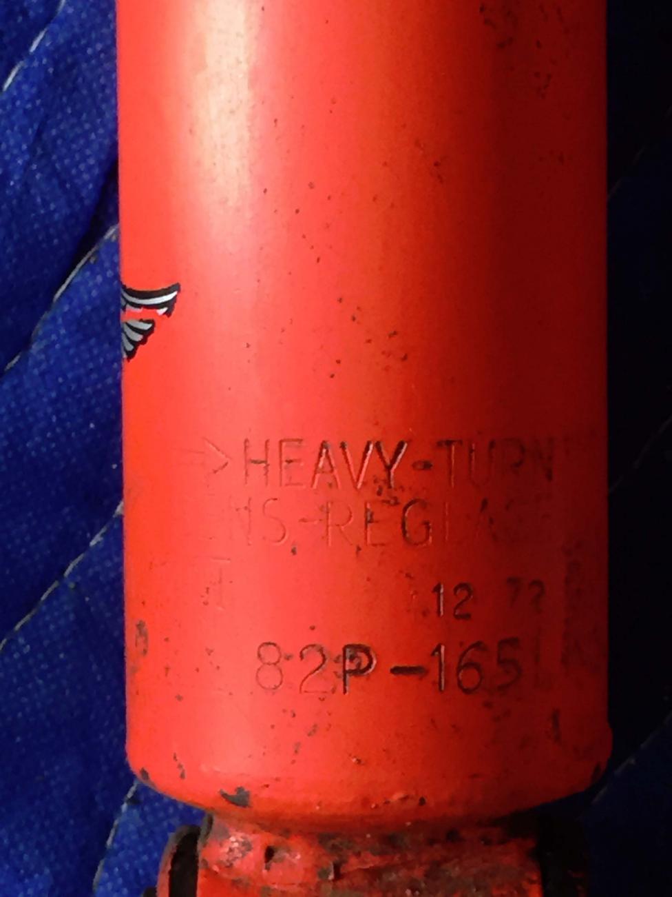

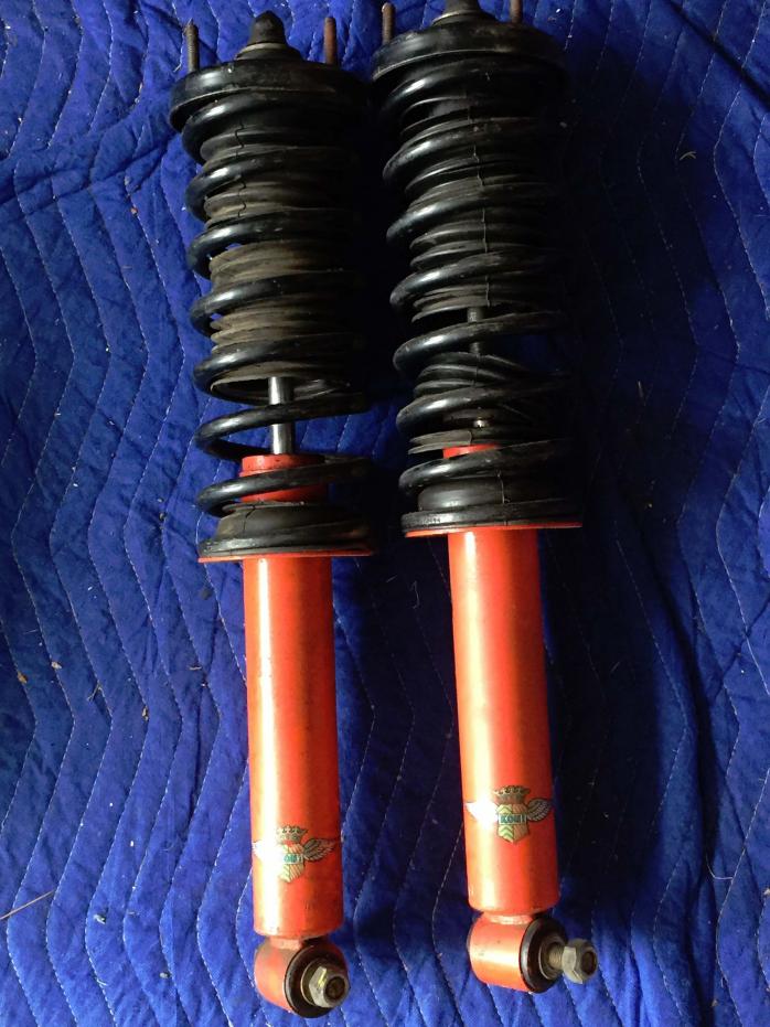

Funny I just traded a case of beer for these. Does anyone know anything about these? I was told they came off an E3 but just for my reference are they compatible with E9? I don't want to sell them but if I ever do it would be good to know. They say Heavy-Turn/Sens-Reglage. 12/72 I'm guessing is DOM and then 82P-165. Koni-Holland. I heard they are fairly rare. Are these pretty stiff shocks if still good?
