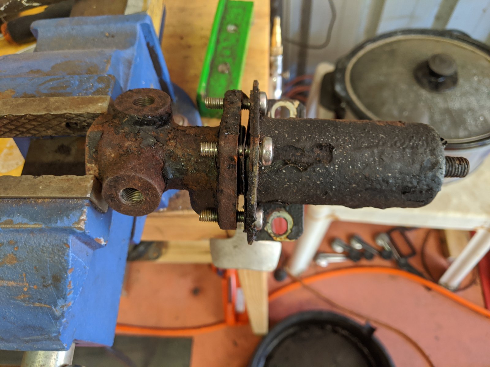

Hello, this is how is mine look like it is so bad that I thing it has to be change location where they install it is bad that's why it gets rusty I have to think about it weather move it inside under the back seat or make a box for it what do you think.Like this View attachment 106541
thank you so much I was afraid to open it but now I know what is inside and how we can repair it just dont have the parts and where to get it if you help us where to buy the parts that will be great.a lot of preparation work was done, basically keep the external bolt and nut position, remove all the pieces, make a new gasket, chrome the fixing plate, new bolts and washers, and new rubber o-rings
remember, as they are suited for brake fluid use they must be EPDM material
a lot of pressure must be exerted to be able to close and thus do the four bolts, so i used this setup
bolts were finally fixed using loctite too
ready for my future brakes job
