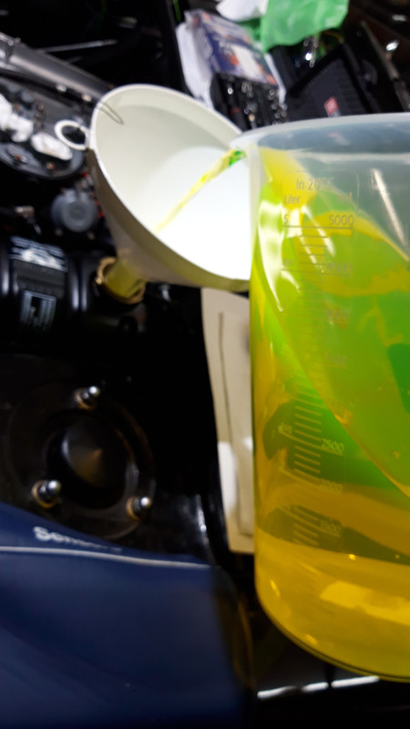

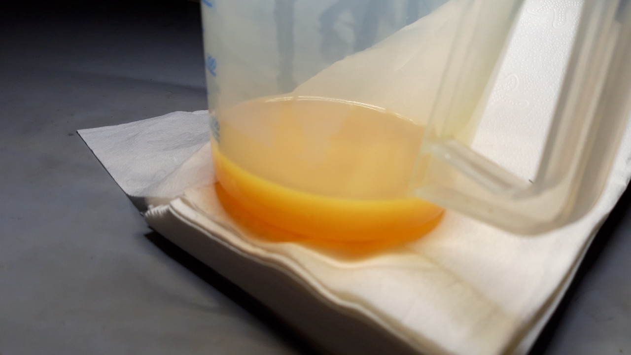

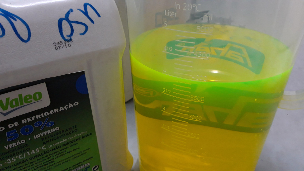

What is the fluid in the plastic beaker that looks like "cafe con leche"? There's no fluid in my car that looks like that.
The oil coming out of your steering system does not look like Dexron fluid, I thought they were mostly red in color, but it could be different in Europe.

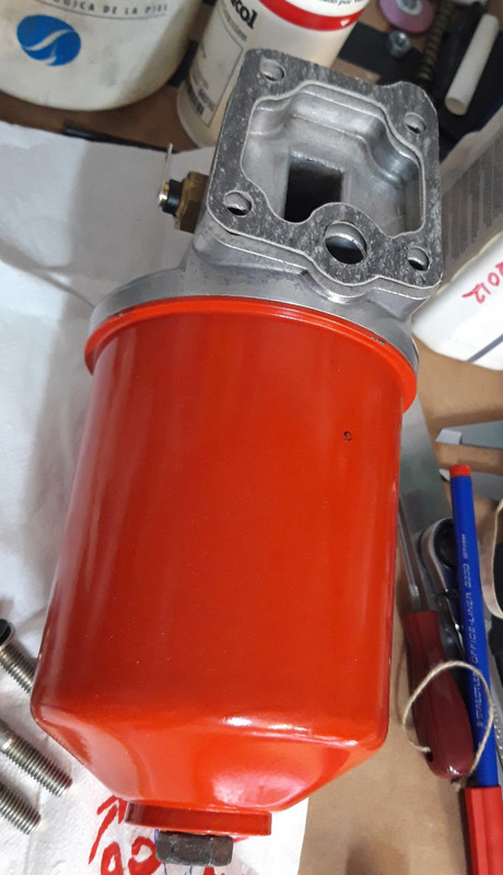

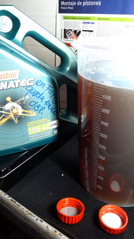

poured engine oil, 5,5 liters, used a new valve cover gasket and put the cover on, closed in the torque specs and pattern
install the carbs back and made new fuel lines...

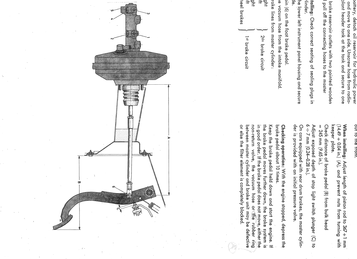

i was asked for this:
BRAKE pedal and linkage:

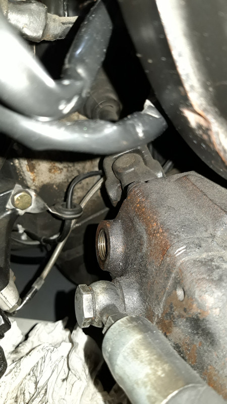

a word of advice when refilling an empty steering fluid system and garage temps below 10º (obviously celsius)
first attempt, simply fill in the reservoir, and start engine, bleeding was unsuccessful, moving the steering wheel resulted in pump almost stopping the engine
so all down out again and refill, this time slowly pouring the fluid while manually moving the pump pulley, then levelling using only the starter motor, and finally eninge on and warming up the thing,
success
....p.s. read and do what the manual says,...always
