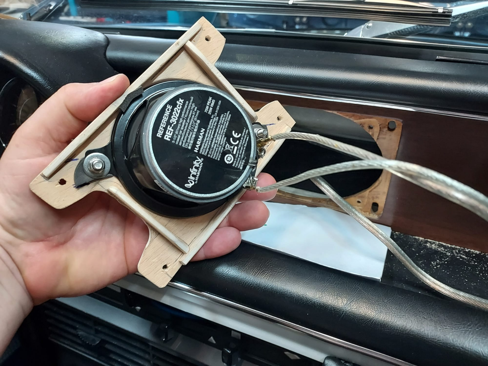

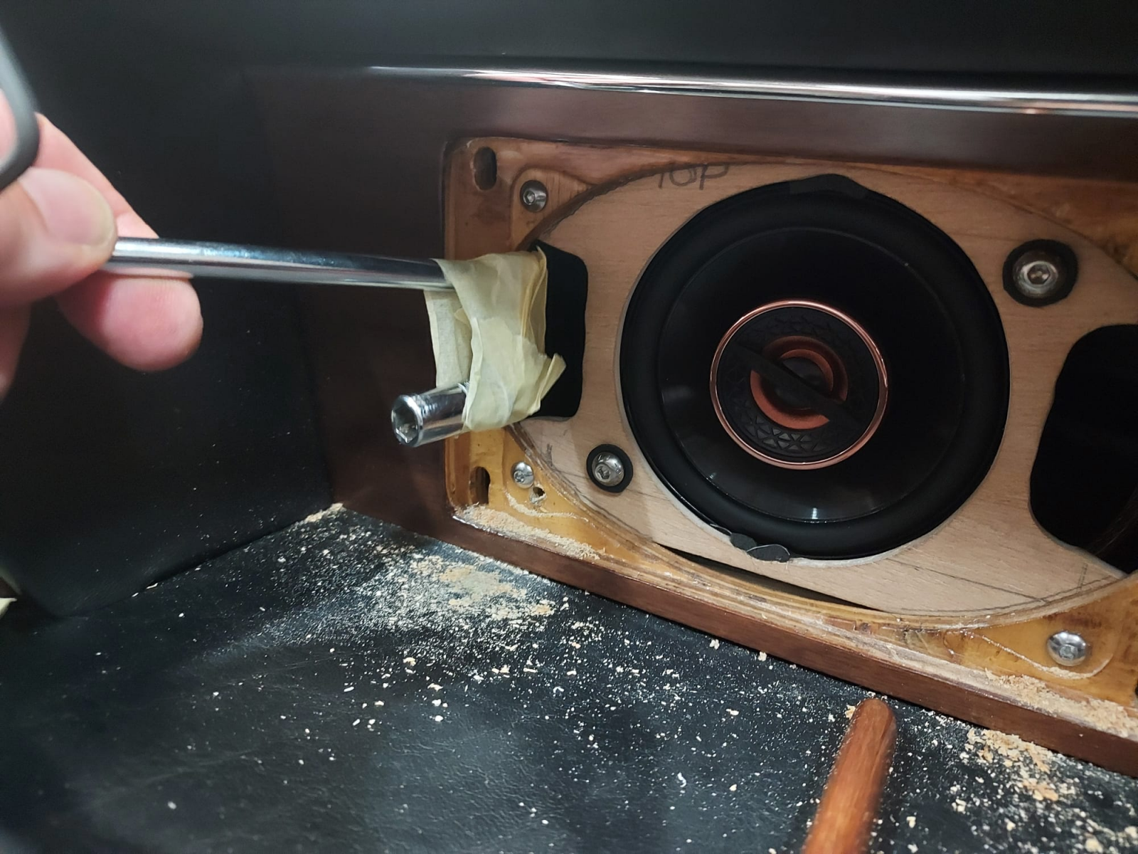

Interesting problem!! And a very clever solution? A U-turn socket!...
Yes, blocking the holes should produce more and better sound. You might try some absorbent material, but simply adhering a thin piece of wood (that doesn't interfere with the grille) over the holes will work better. Use an adhesive that can be pried loose later if you need to go back in. I'd patch that gap at the bottom as well. You might also consider paintng the wood black, so it doesn't show through the grille.

interesting captive nuts
anyway that would have not made any difference to the cutouts
because I had to use the cutouts to manouver the support inside the dash oval hole
And it is in now, so just put some small pieces of wood over the holes.

Another option is to front-mount the speaker to the baffle. That will save space behind. install six t-nuts to the baffle (4 to hold the baffle to the car, and 2 to hold the speaker. Cut the speaker hole so the rim of the speaker sits on the front of the baffle, Then you install the baffle without the speaker, and install the speaker last, from the front side.

believe me that this solution was the only one i found to place the speaker and keep the grille without any modification
there were a lot of limitations in the spot
only positive addition might be those odd nuts that will help in the assembly a lot
