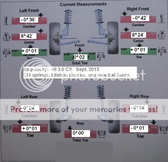

What is the max (-) camber for the rear wheels
Re-publishing DeQ's spec sheet below, can the forum members recommend the maximum (safe) neg. camber for the rear wheels and rear toe-in? I have 16 in. Alpina (knock-off's) and I have welded on the IE camber/toe adjusters in the rear- also Bilsteins and CN springs with 3 dot perches. I have removed the rear sway bar and that has actually helped a little but I'm looking for a good cornering set up. I am not tracking this thing, just want a comfortable good handling ride and this is the last piece of the puzzle (or so I think). Again, any help would be appreciated and tire wear is not really a concern.
Thanks all!
measurements after alignment operation
results:
what do the experts think ?

the final setup
