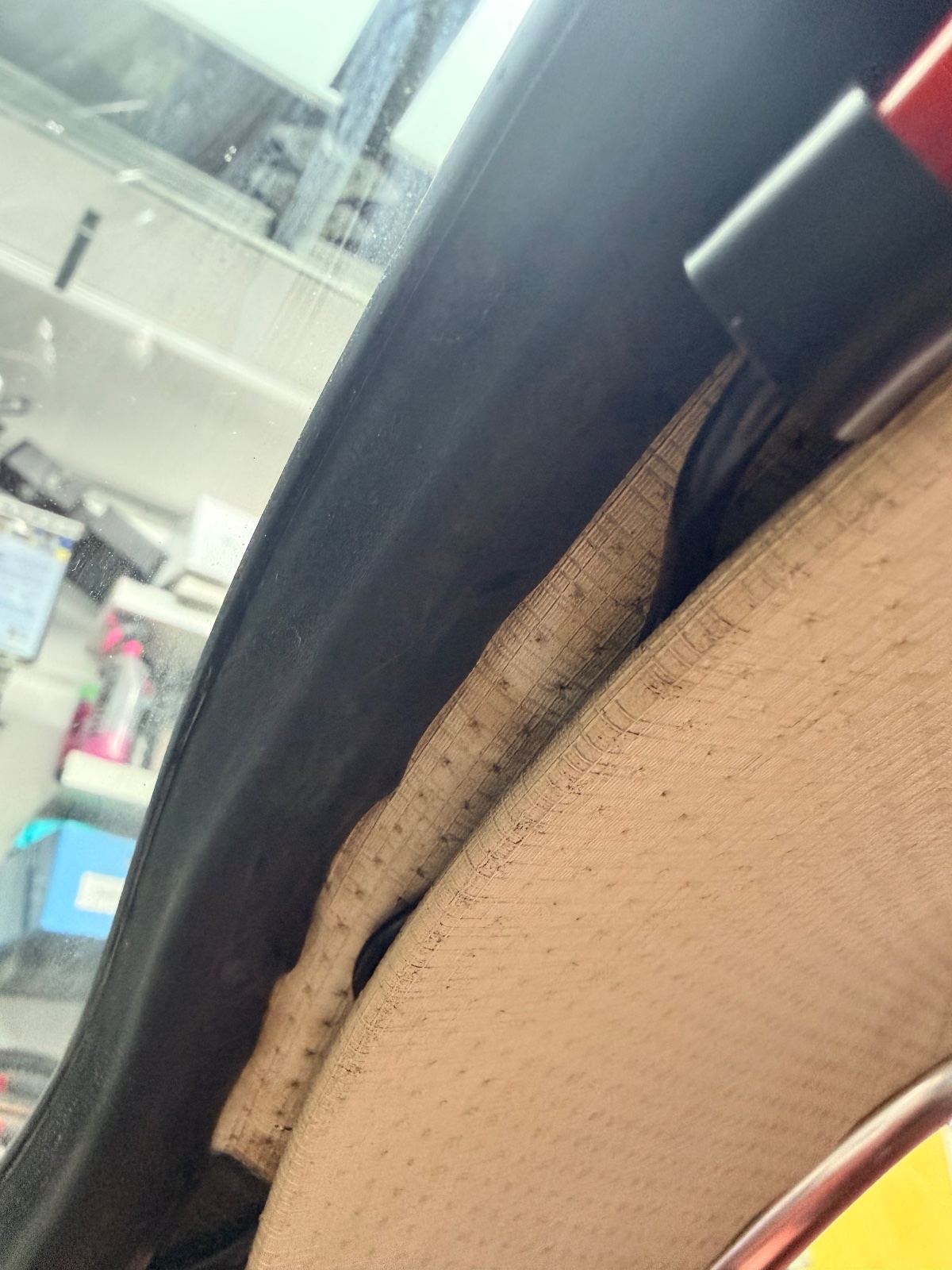

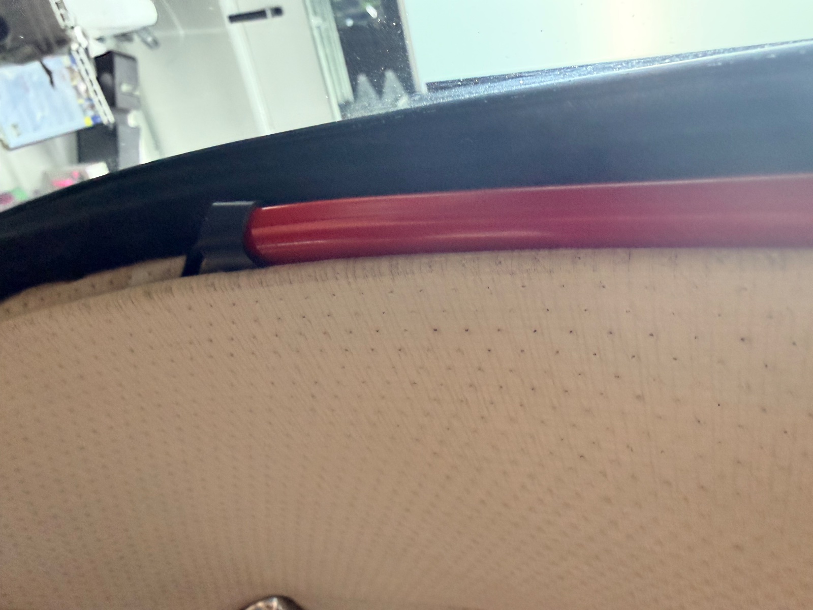

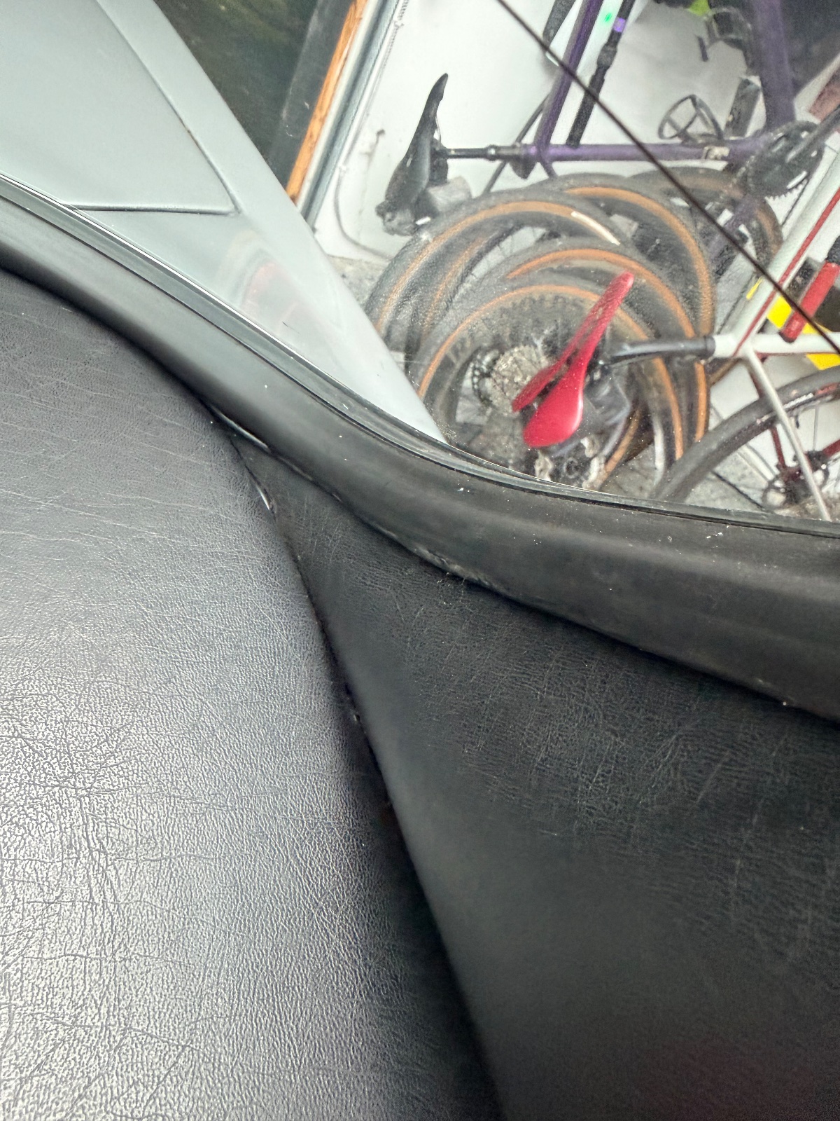

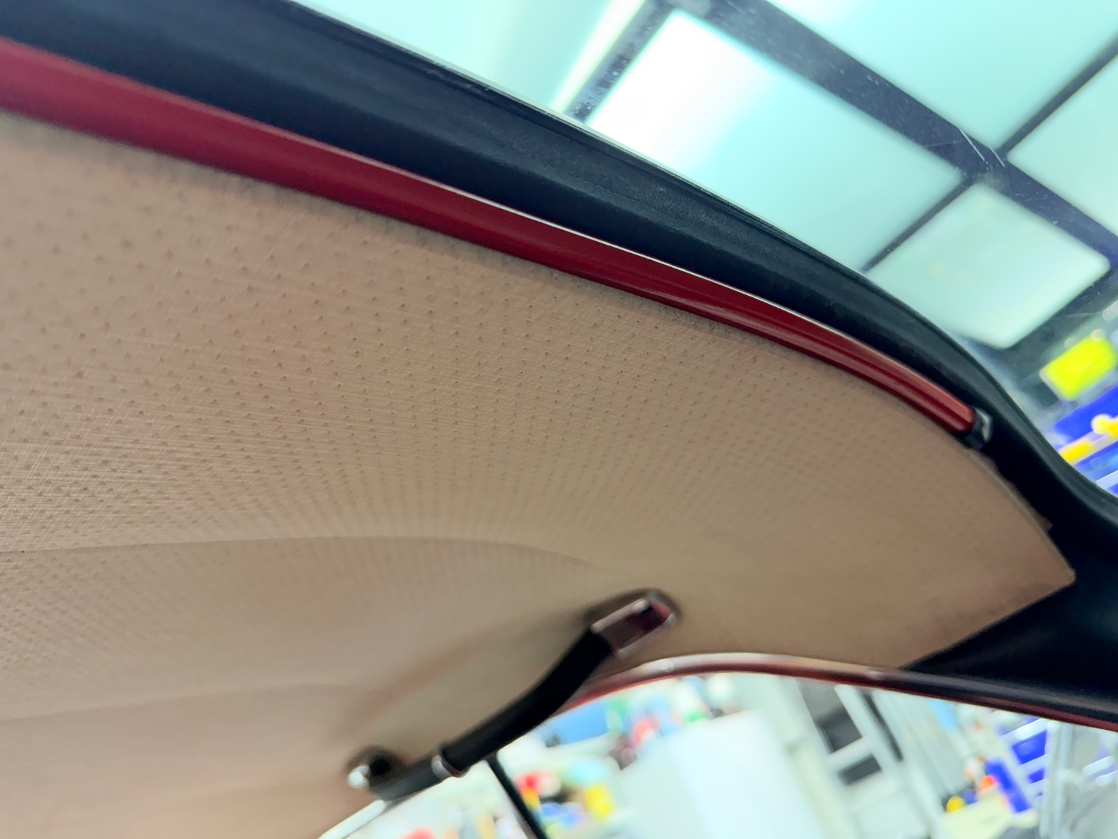

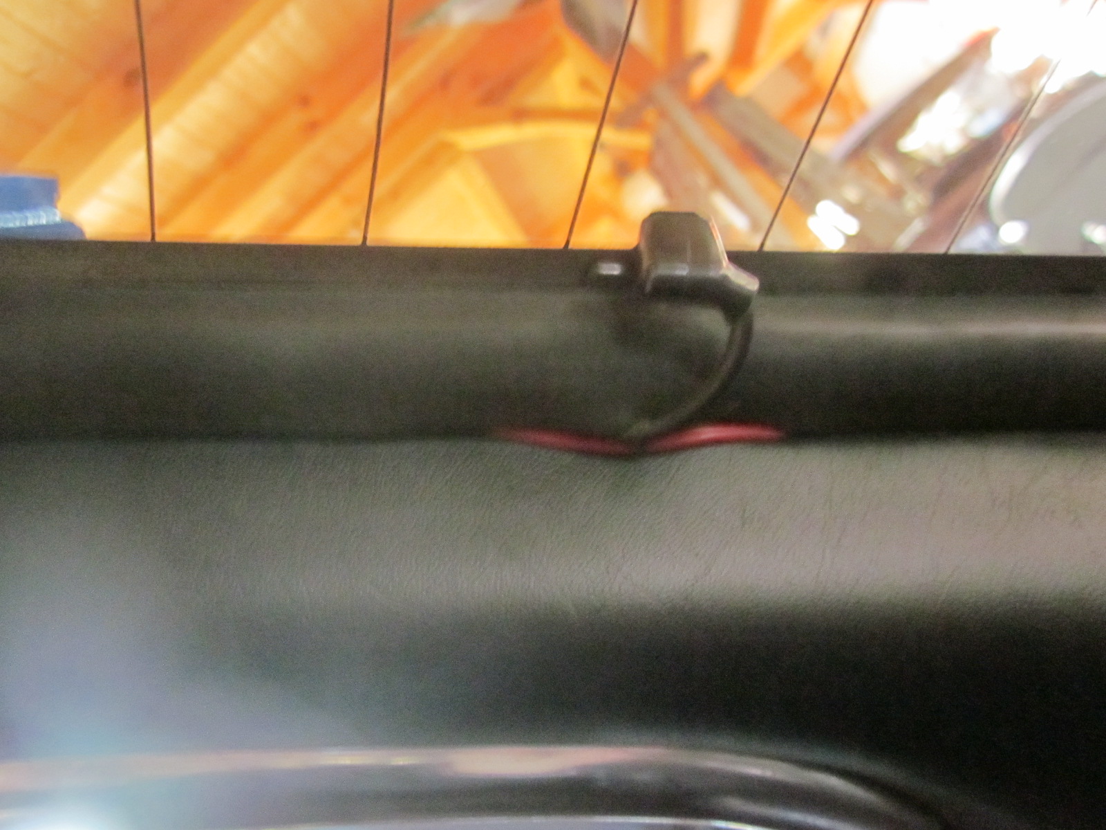

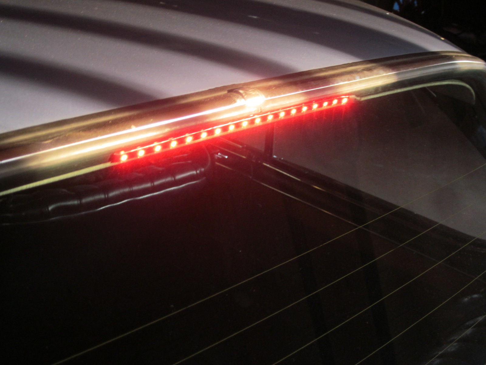

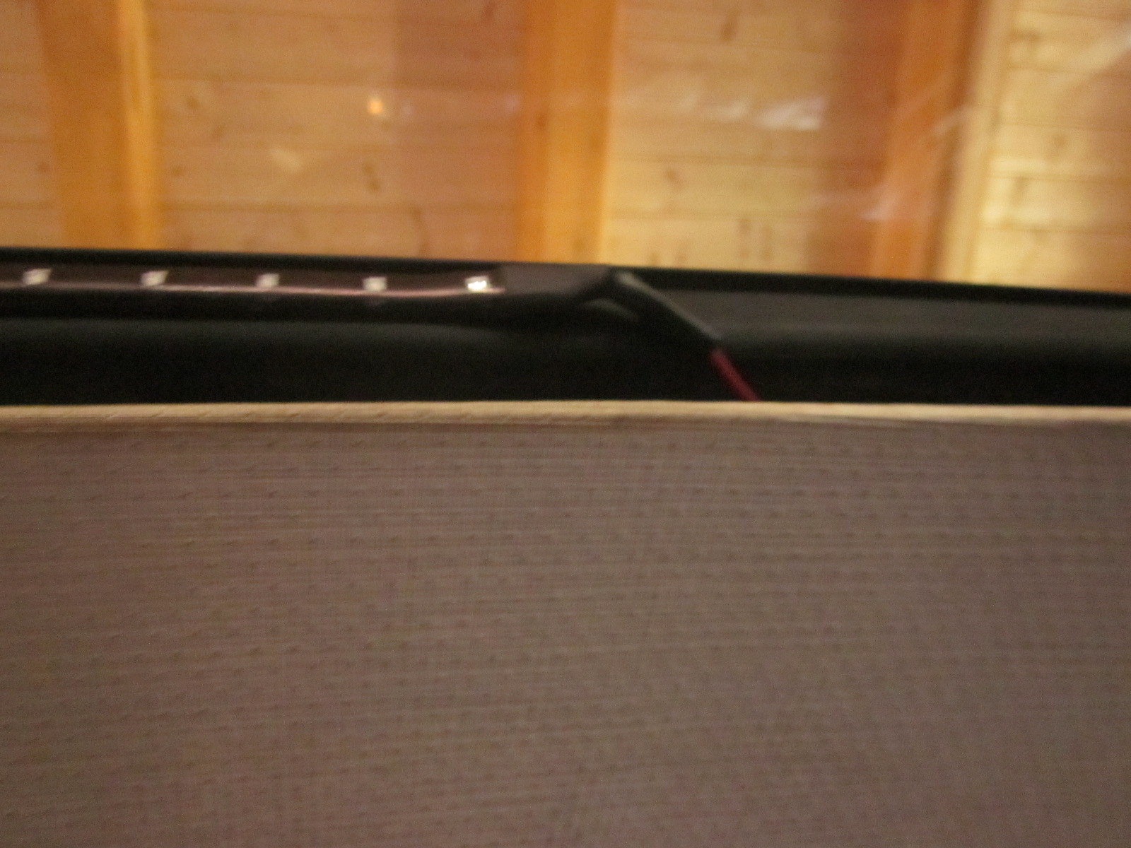

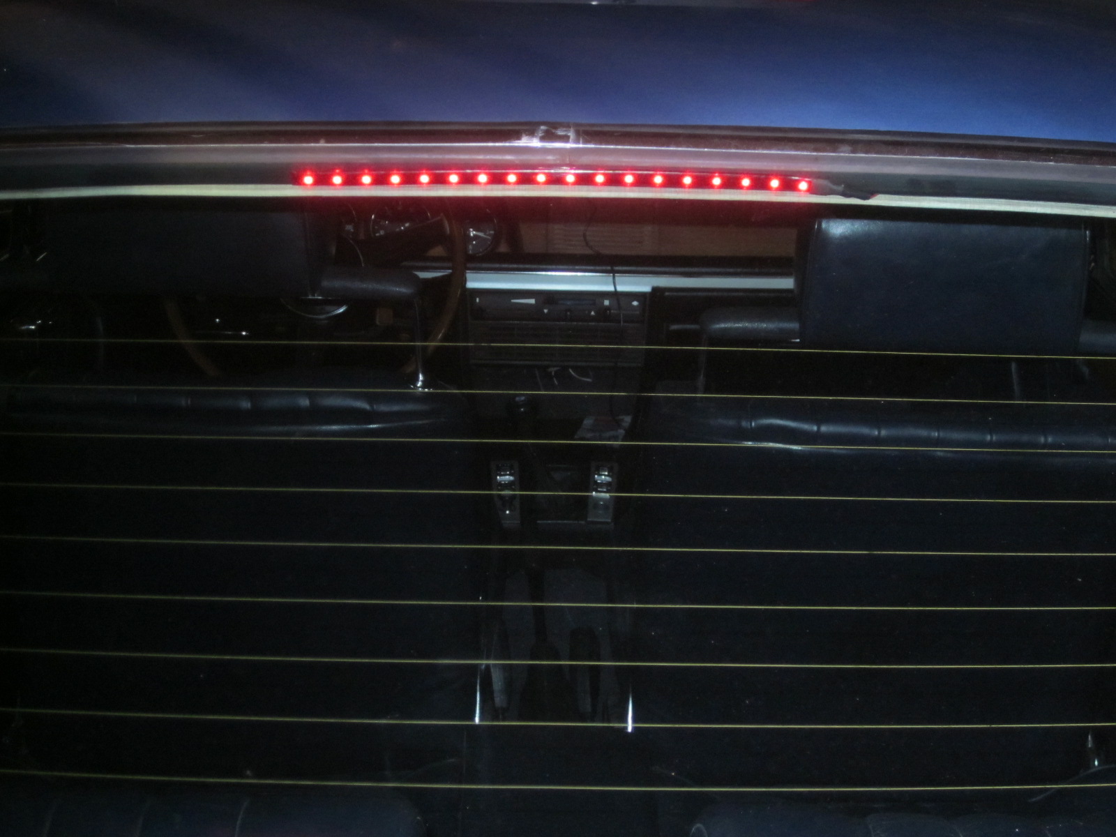

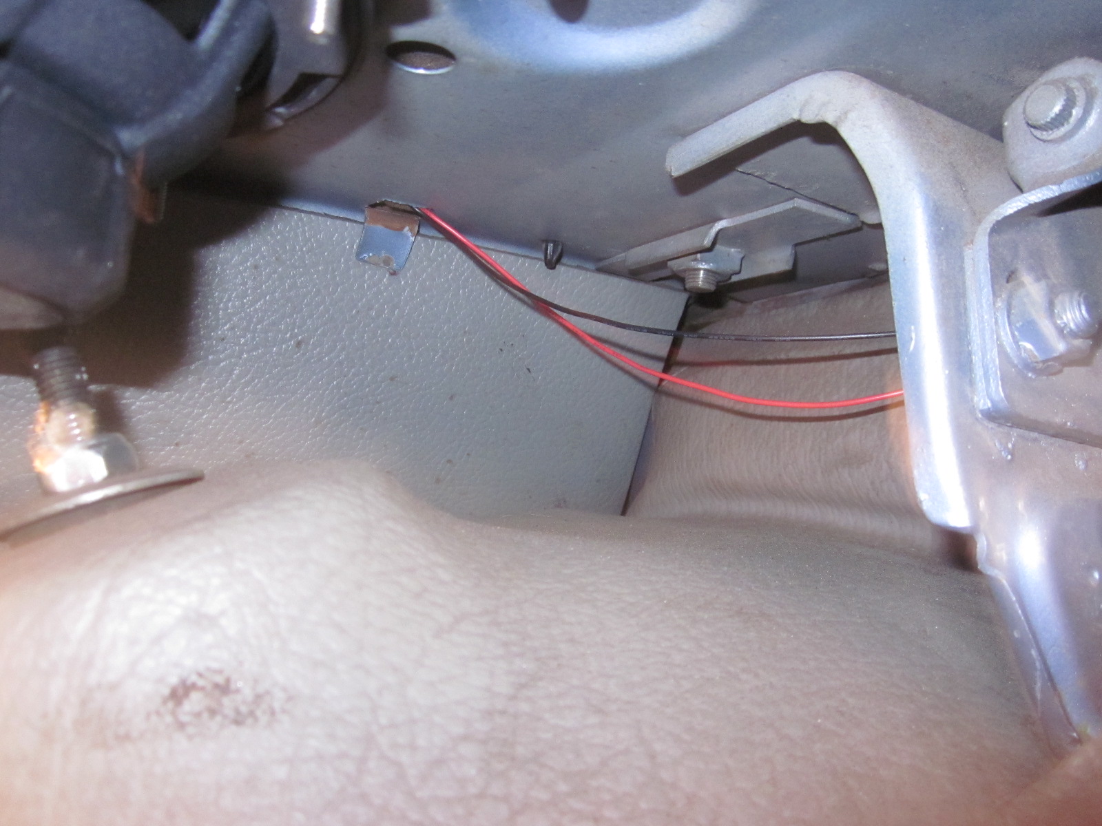

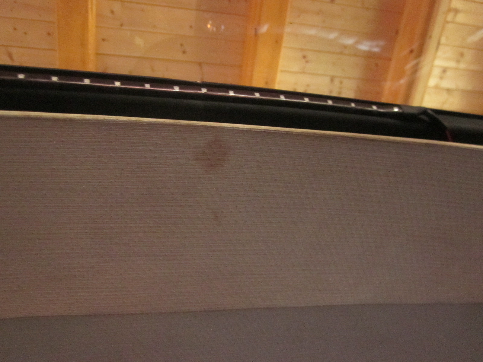

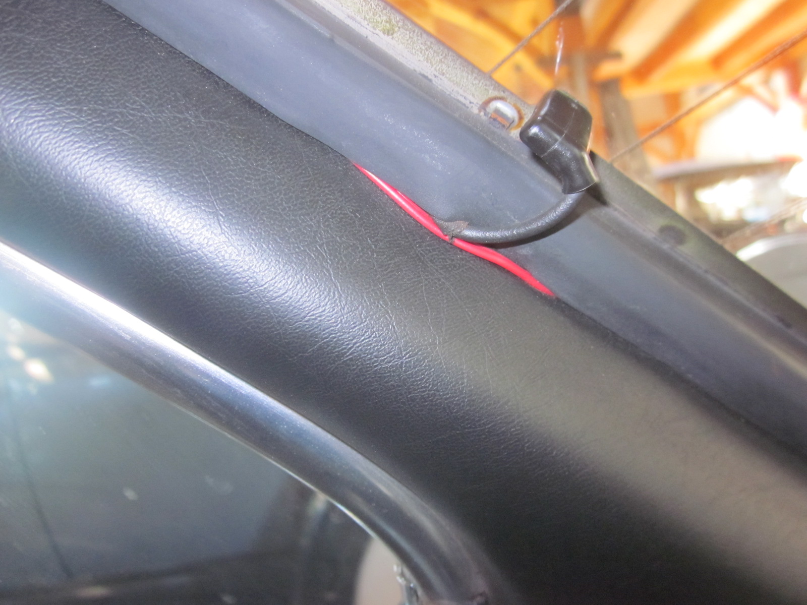

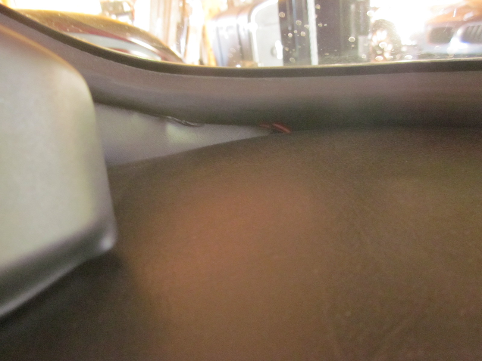

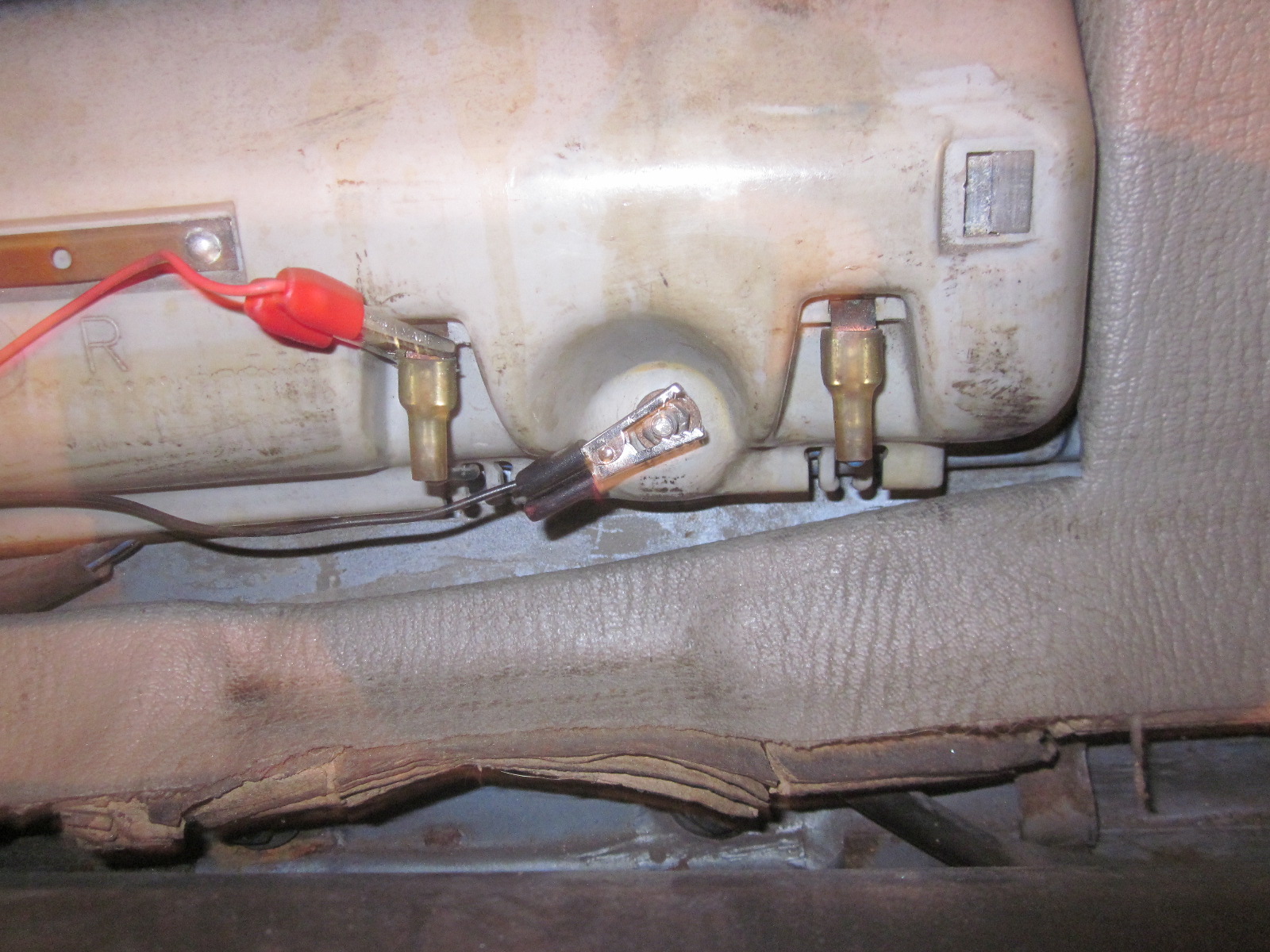

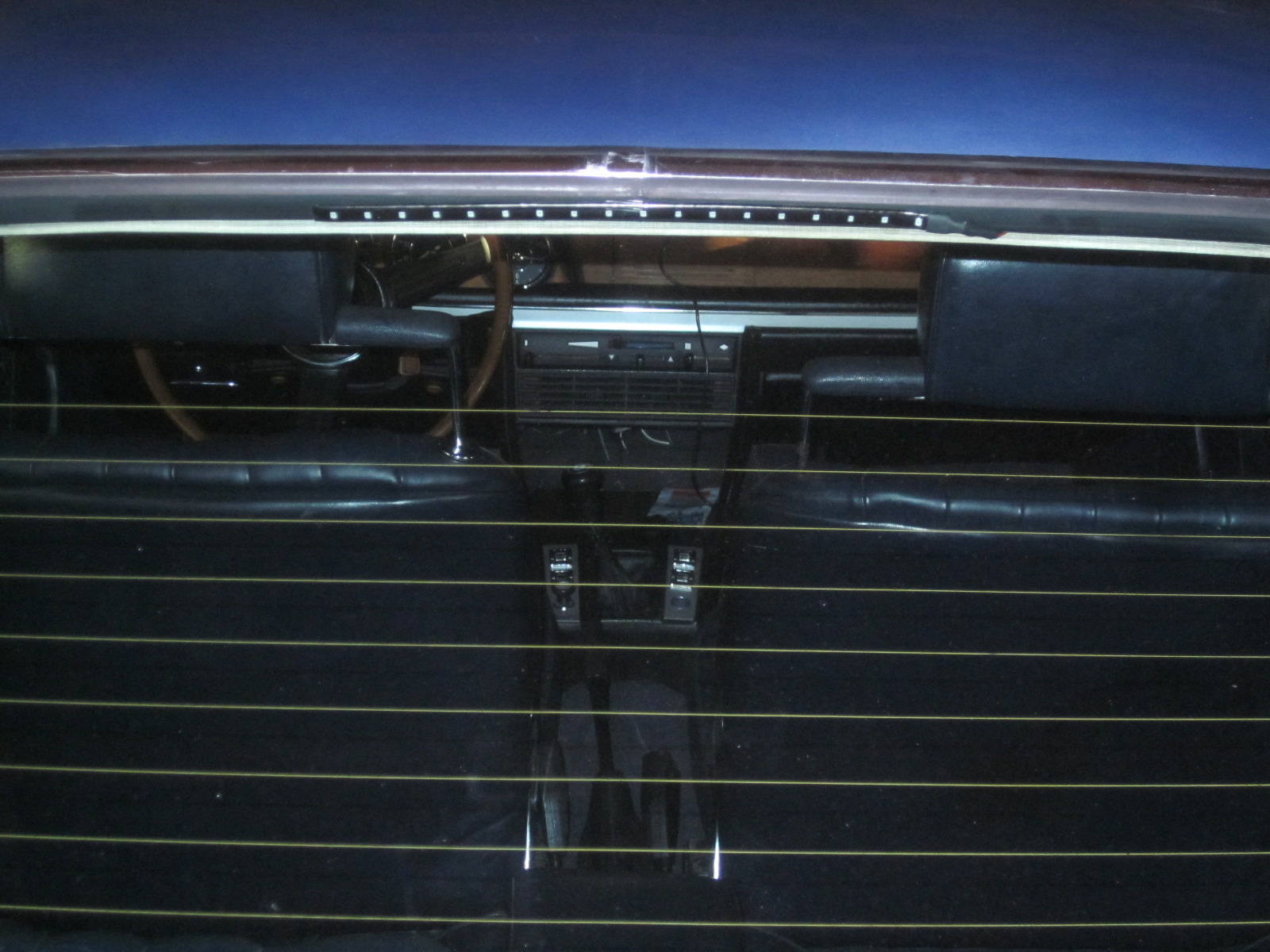

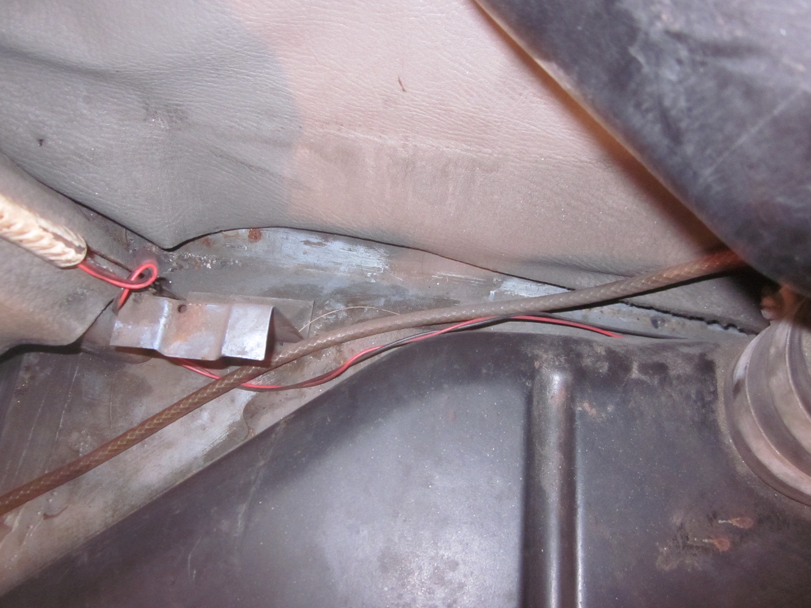

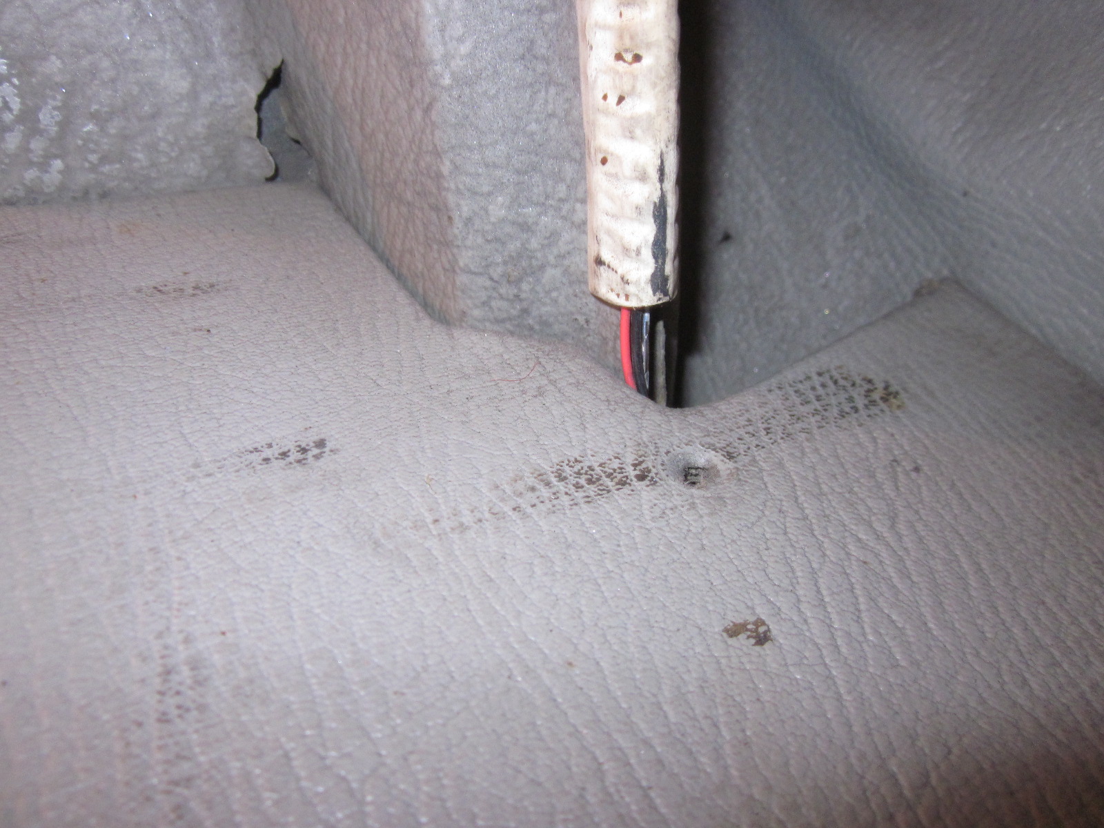

The 3rd brake light is an LED strip 1 foot long Alpena 180°red with 60" of additional red & black wire soldered with heat shrink insulation at the joints. Then red & black alligator clips soldered to the wire ends. Then put little pieces of electrical tape around the wires to hold them together. It attaches to the upper center of the rear window seal with the wires run under the lip of the window seal to a hole under the parcel shelf. Then under the white fender welting, under the gas tank trunk board to the brake light tab and ground on the passenger side tail light.
